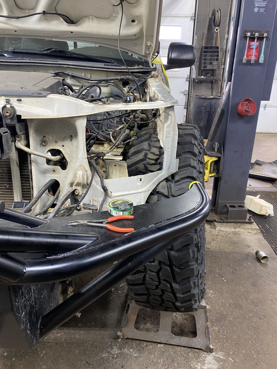

    I can tell you right now with 37’s if I went 2” forward my tires would be in my headlights. It’s close as it is 1” forward.

    Oh I believe it. There’s no getting around having to cut something once you get into 35”+ territory. The fender wells are only so big.

    Yup. So regardless that kit is going to make you bump out sooner than going 1” forward. Absolutely no way around it. You can see here how much I had to cut out of the core support. People are fools falling for that shit.
