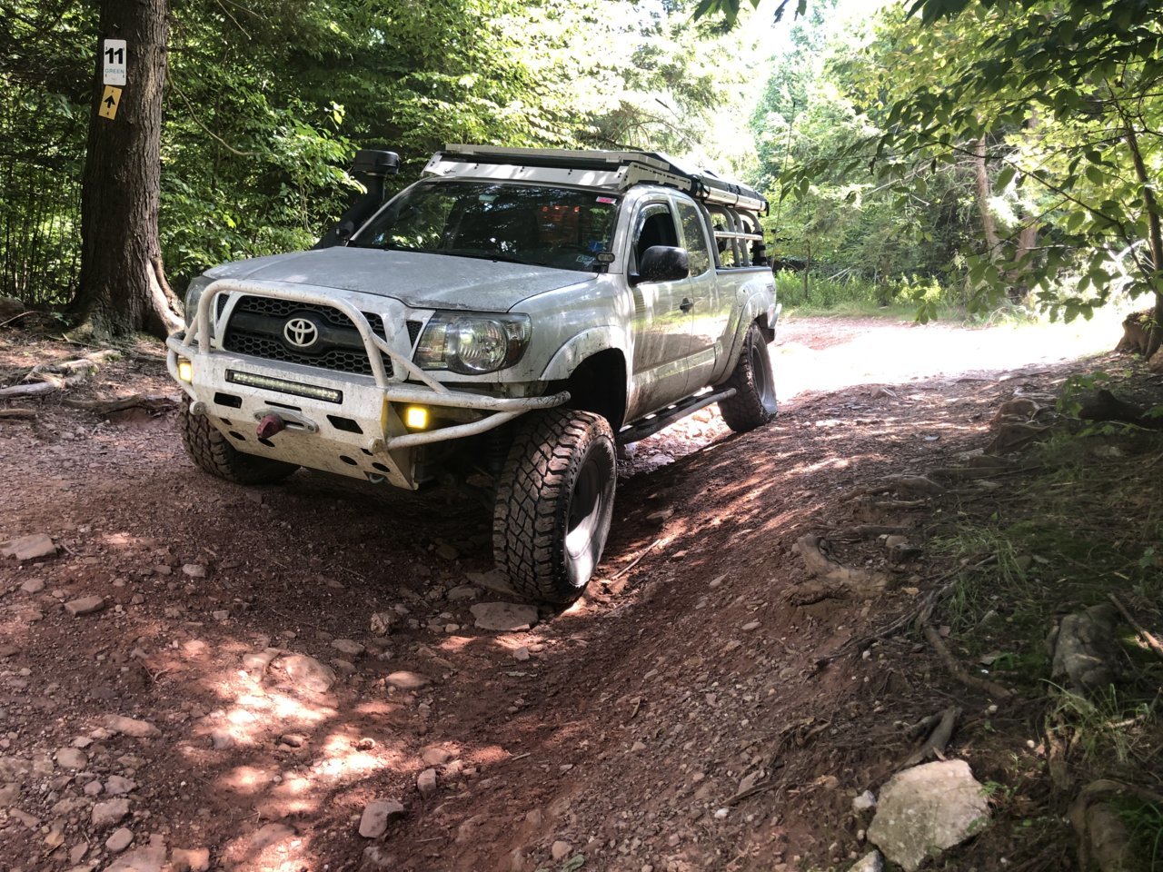

    Not sure what drop out is..
    My angles are decent I think. And it flexs pretty good too

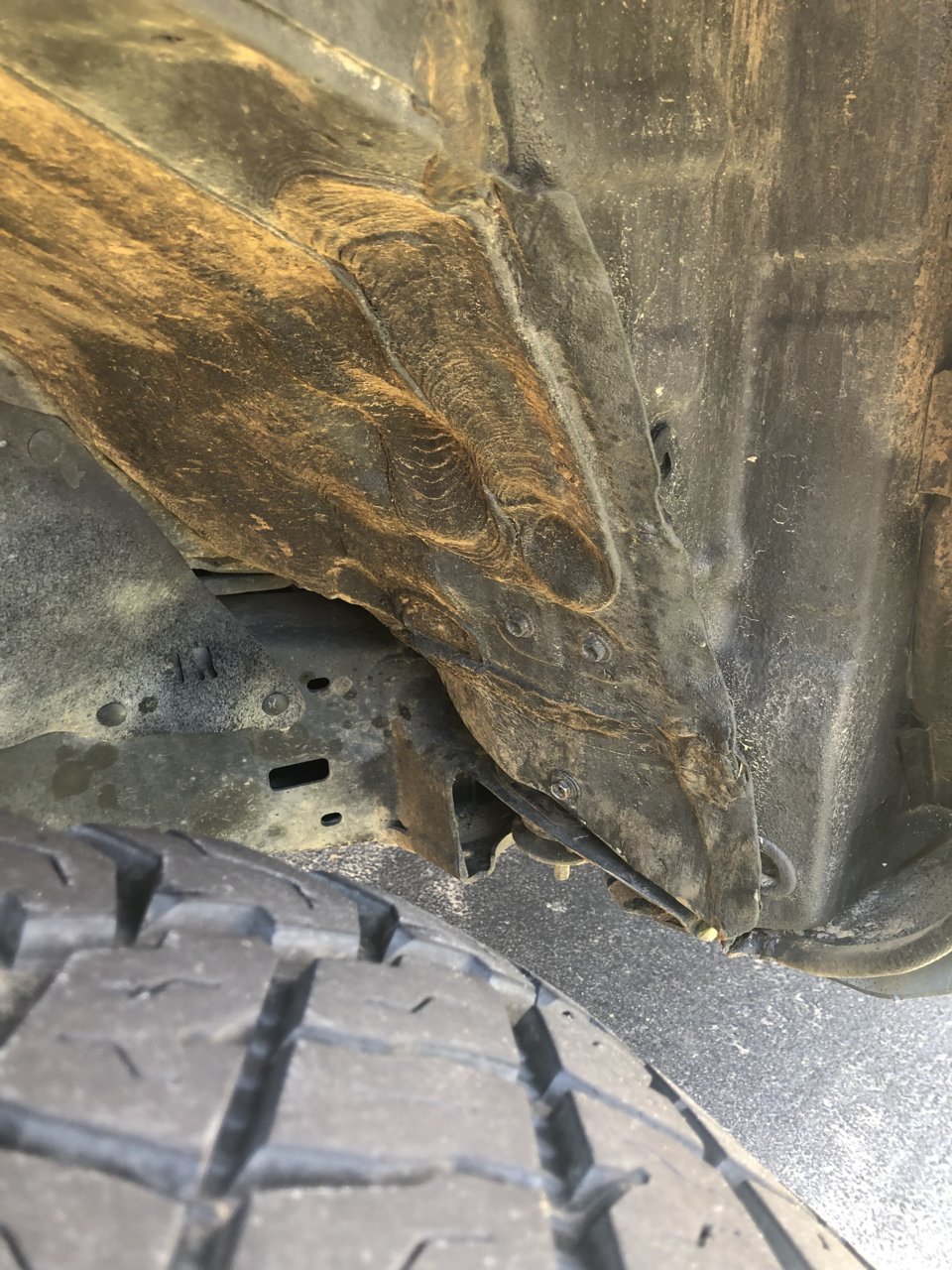

    Do you have pics of your firewall?
  6. Aug 31, 2019 at 9:56 AM
    #106
    fatfurious2
    Jun 28, 2014
    #132884
    49,732
    David
    Ashburn, VA
    2010 TRD OR Access Cab
    I just flattened the pinch weld. I had a cam mount chop already but have the alpine design relocation to go on eventually

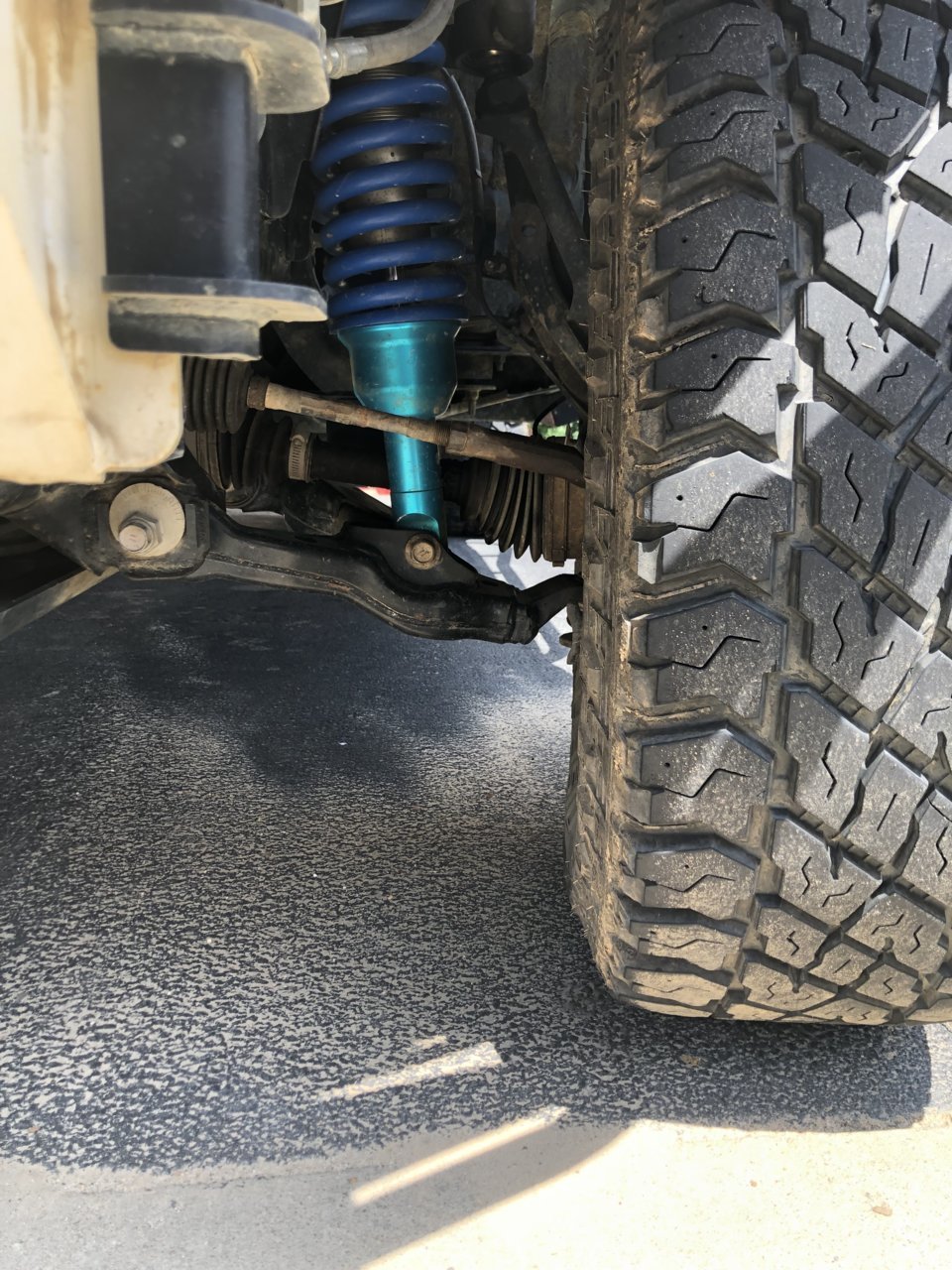

    Have you cycled the suspension to see if you have tire clearance throughout the travel? Are you saying as it sits you can’t get to full lock in reverse??
  10. Aug 31, 2019 at 10:18 AM
    #110
    fatfurious2
    Jun 28, 2014
    #132884
    49,732
    David
    Ashburn, VA

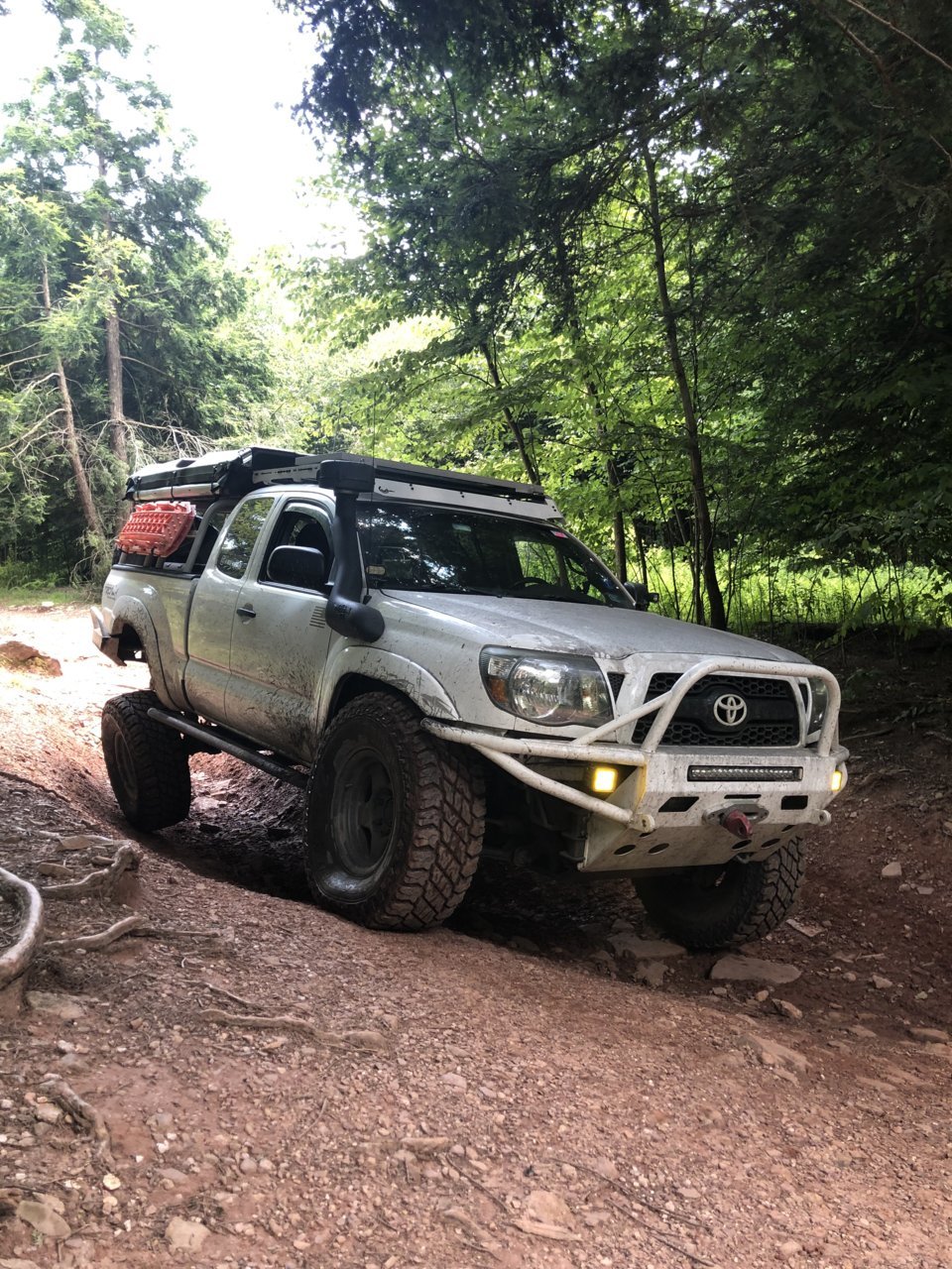

    I haven't cycled it. But yes, as it sits, full lock reverse on a driveway, it rubs. For normal driving, no rubbing.
    Even in my flex picture, the only rubbing was at the cab mount.

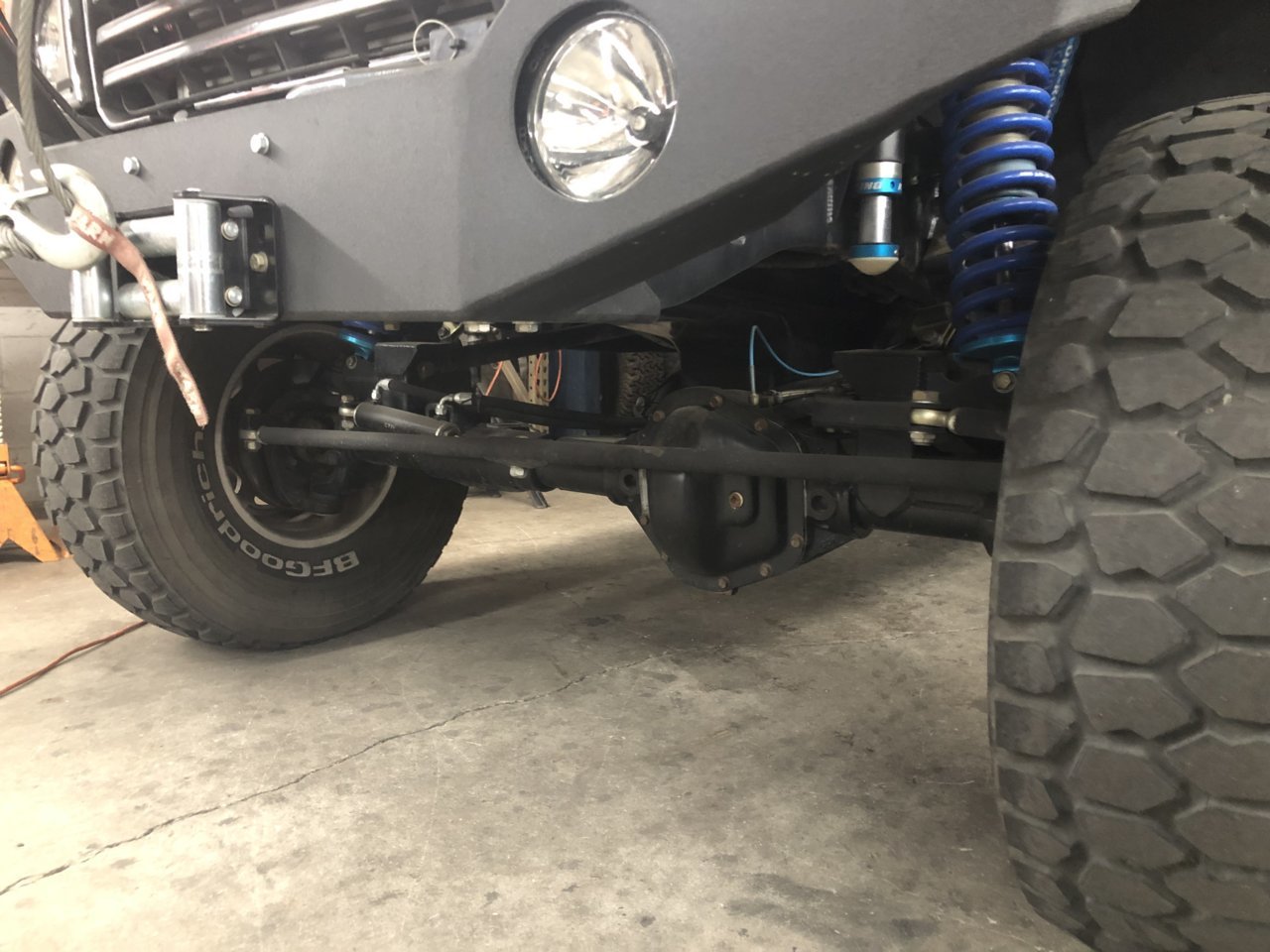

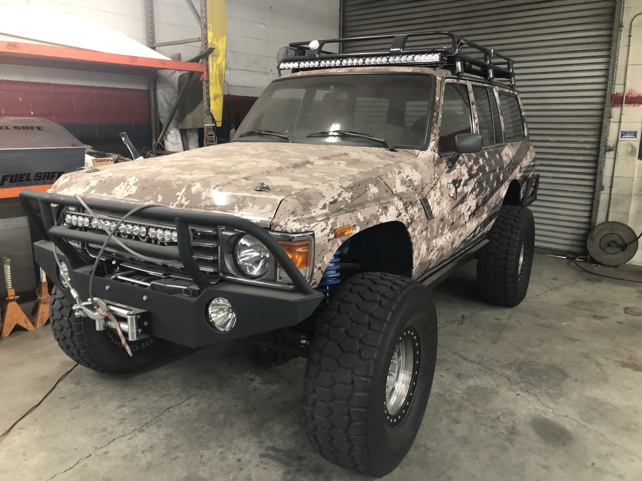

    Didn’t really get much done on the truck today except take a bunch of measurements and made some templates for the lower arms which are getting some gussets and beefing up the bump pad for the air bumps.
    I did snag a few pics of the craziest Cummings powered land cruiser ever that JD Fabrications built- enjoy

    Yeah it’s safe to say that thing is my dream ride... it’s nicer than most new cars inside, the cage is 100% hidden and the Cummings makes soooo much torque

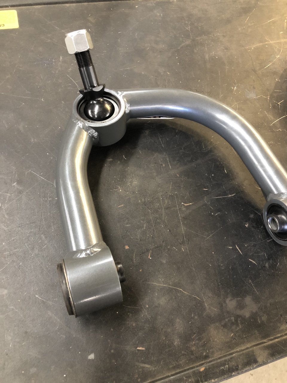

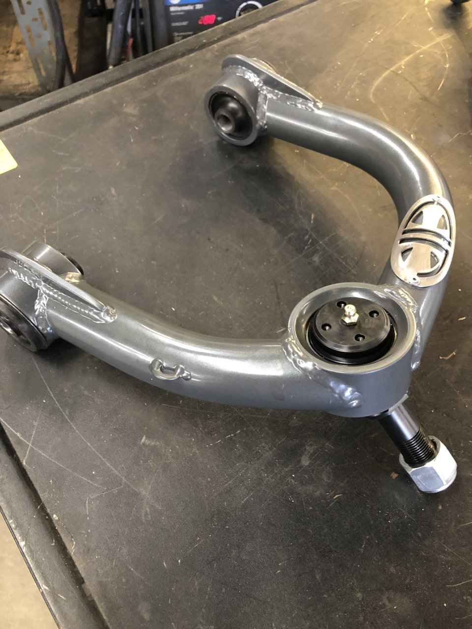

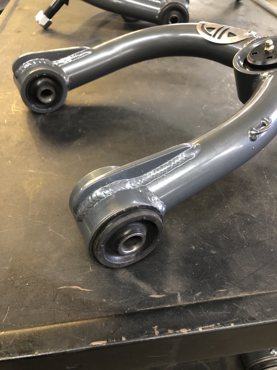

    Just swung by the shop and my new arms were back from powder coat!!

  20. Sep 12, 2019 at 2:20 PM
    #120
    EatSleepTacos
    Mar 24, 2015
    #151688
    59,835
    Randy
    West Valley, AZ
    2017 4Runner
    Any particular reason you went with rubber bushings instead of poly?
