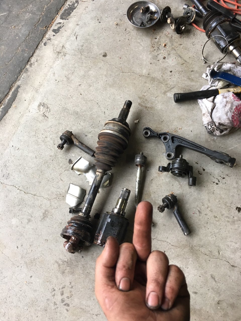

    Shit! I can’t find the pics of the LCA mount but here’s the rest that happened all at once
    8800FC5F-D13F-458F-8E64-A6591899CA9B.jpg 4DD36F04-4CF2-42B4-8450-FECF21286A39.jpg D70B28F4-AD50-4EBE-B0D0-B32D90177EAA.jpg 69F0B2DB-9D7A-494F-B1EF-86551092683E.jpg

    What the hell happened??

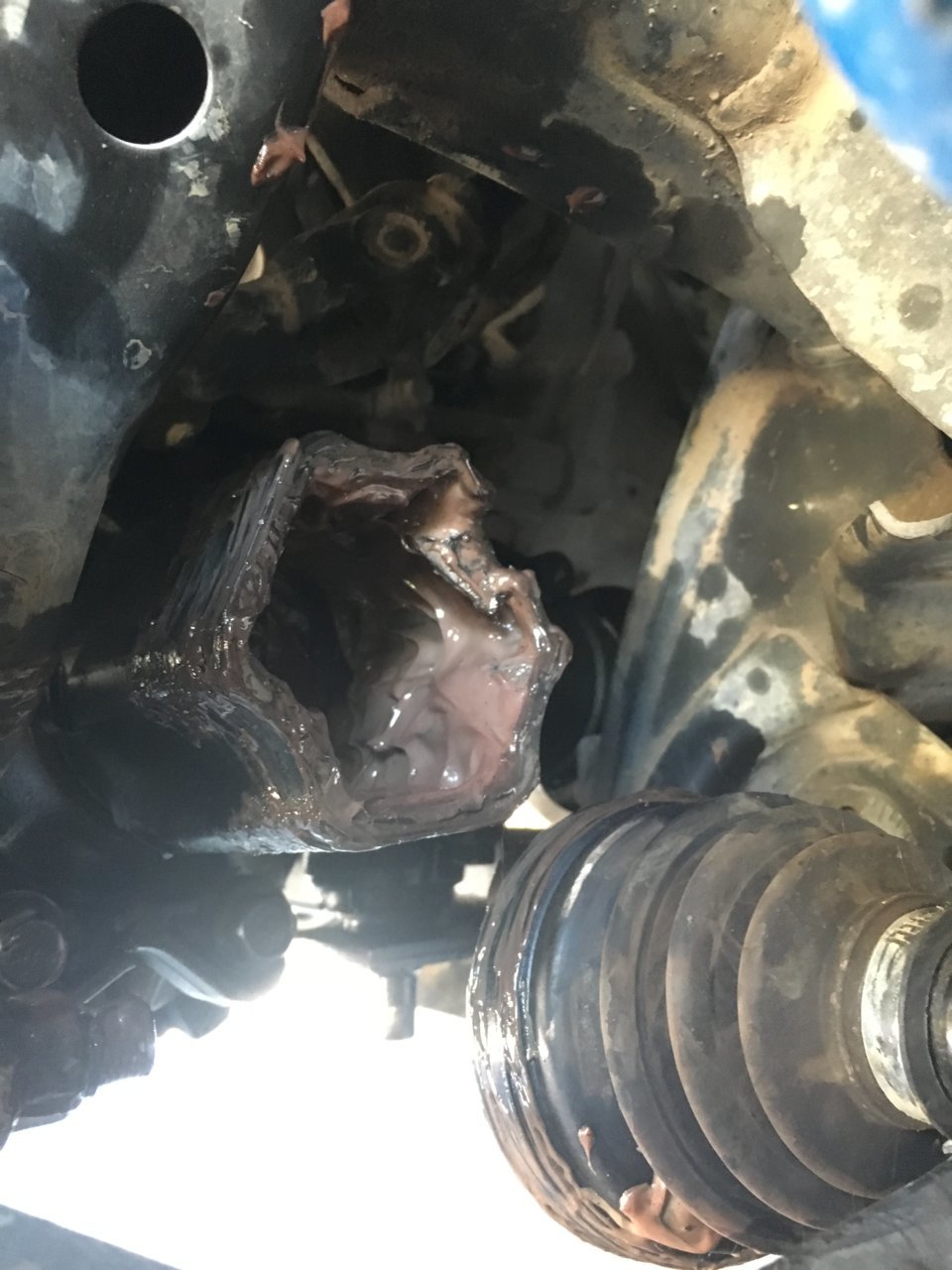

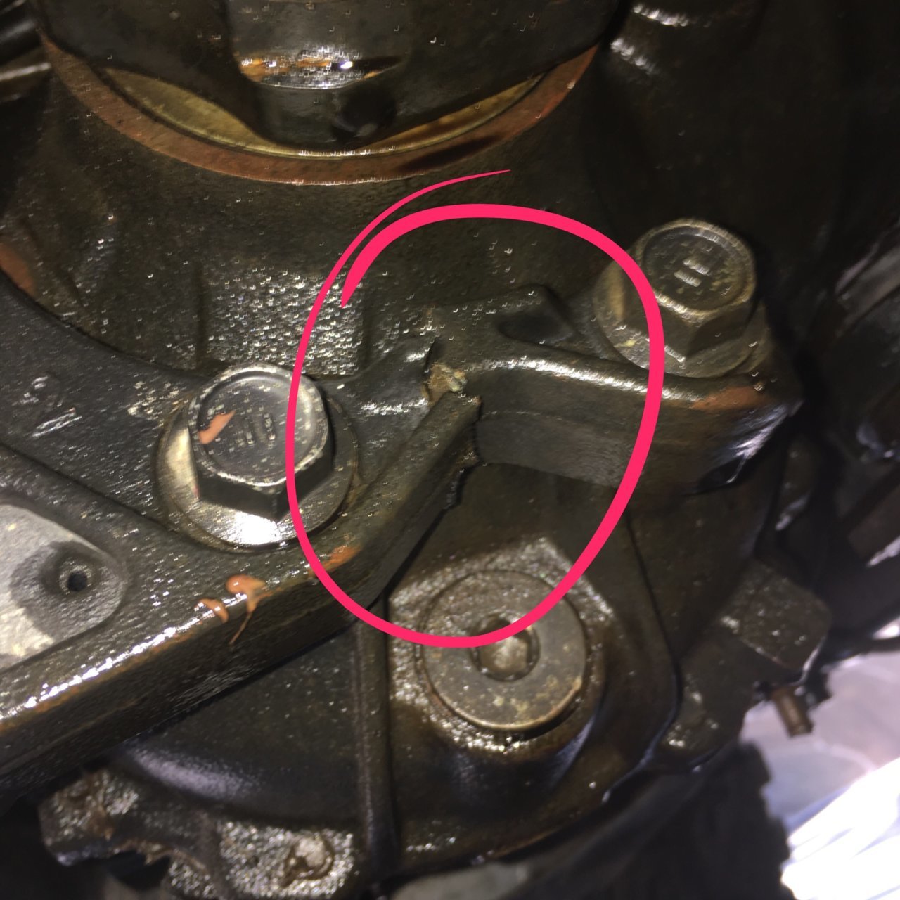

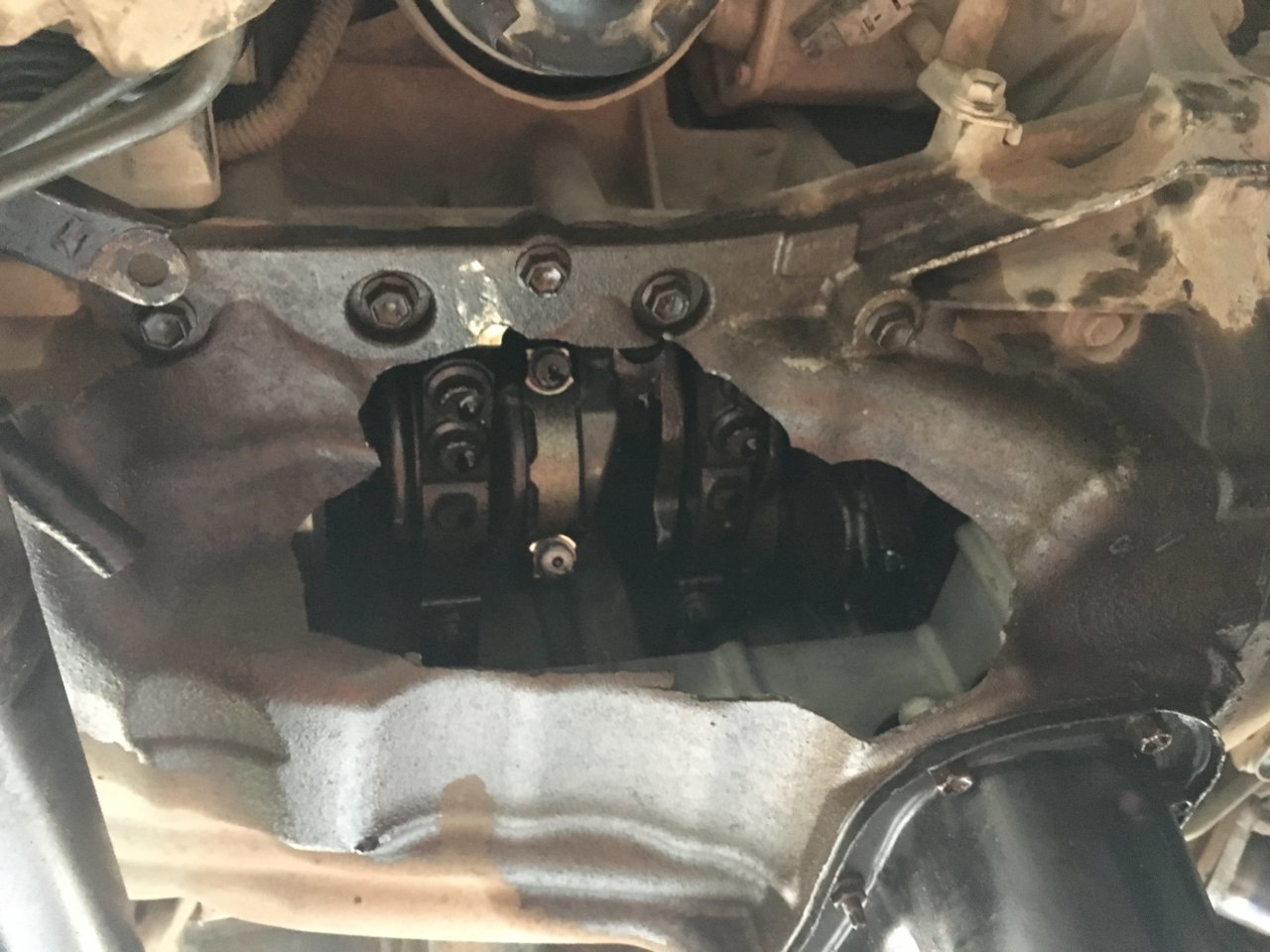

    2012 DCSB Sport
    ...too much shit to list.
    I like to party :notsure:
    One of the front diff mounts lost a bolt somewhere between here and Death Valley. Another walked out and wallowed out a hole. Bound up locked front and rear at slick rock, the whole diff rotated upward and snapped the diff mount, diff smashed a hole the size of a personal pizza in the lower oil pan, bent a tie rod into a 90* angle, broke the inner CV cup, and ripped off one of the LCA mounts.
    ONE OF MY LCA eccentric bolts is still welded to the frame 2 years later :anonymous:
