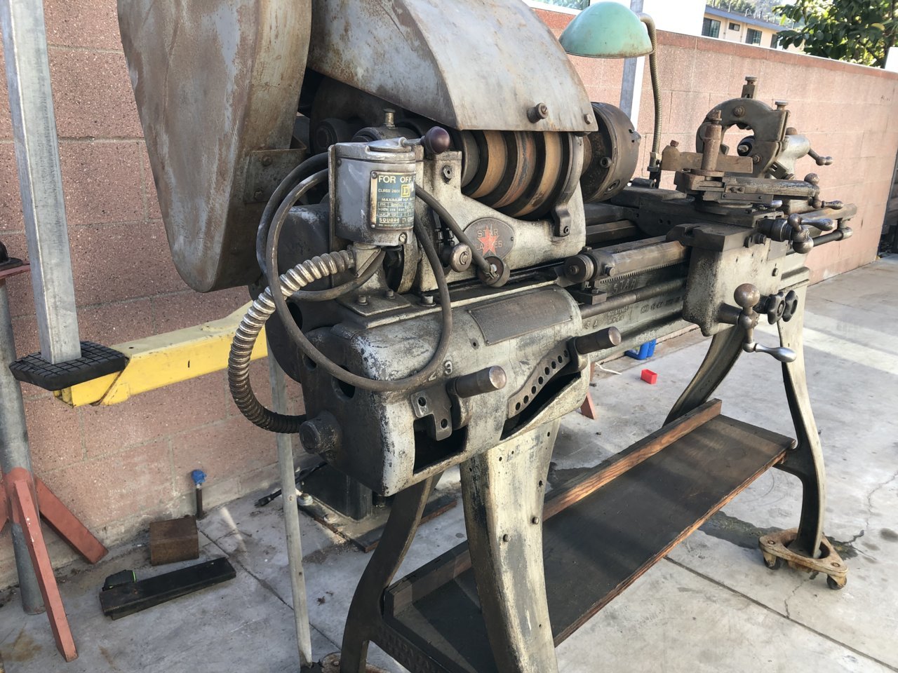

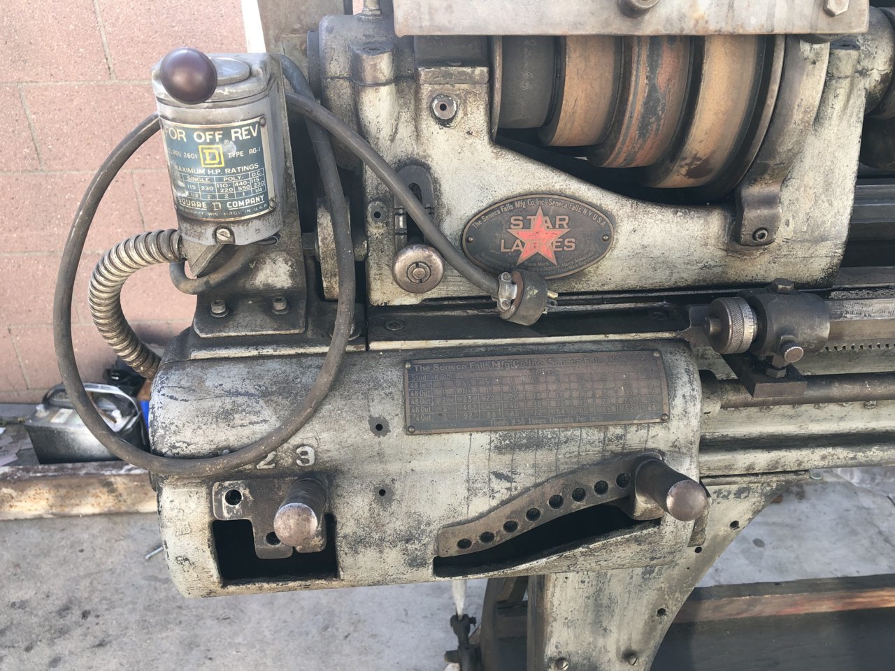

    Couple of pages back there was lathe talk. Been wanting one and decided to scope it out again found this gem on OfferUp. Has quite a bit of tooling and even a taper attachment. This thread continues to helps me spend my money:spending: just not at JD this time.
    thanks for helping find it!

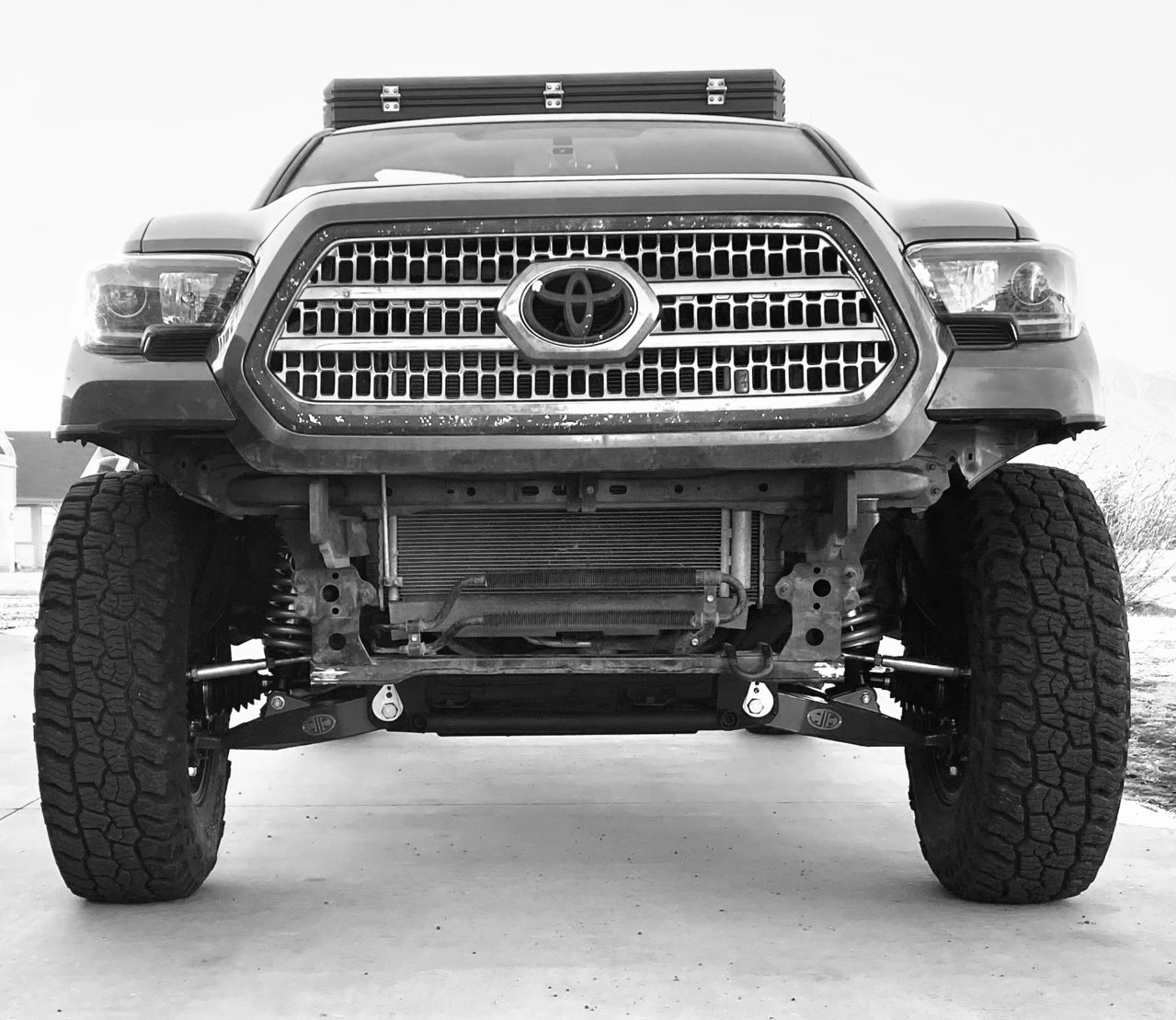

    Supercharged TX Pro
    2011 S/C and basic mods
    https://www.instagram.com/p/CZYCsGapjnZ/
    Yeah she’s a roller. Tried lca’s one position forward and with the cams centered the tie rod hits the coil. Seemed to be a world of clearance when cycling, but real world on the ground says different. Actual alignment might make it clear but we’ll be safe and just scoot the lca to the furthest rear position. Gonna do that one night after I get back from KOH and then get this beast aligned for a real test drive. Then onto building a new front bumper and skids
    Thanks for calling earlier @81Trekker after Wills frustration with radflo following the build specs. Hose and fittings seem to be ok, just not the “planned” positioning of things. Can always readdress and move the resi’s and fittings after he drives it around a bit and we start tuning it
