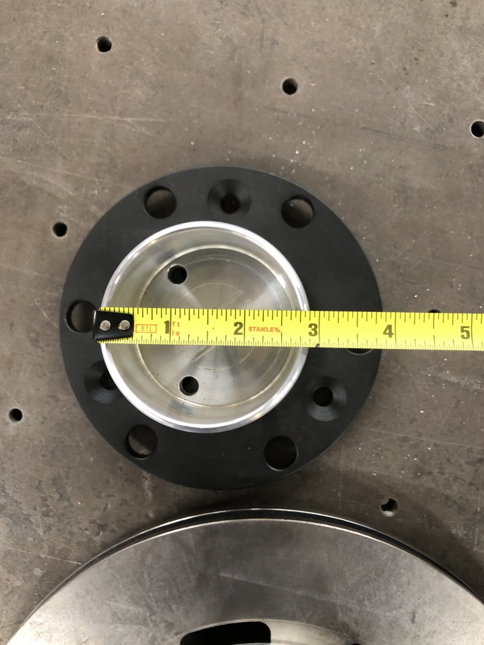

    Is the hub bore the same as a d60? Just seeing if it’ll require new wheels or having my current ones bored out.

    I asked Harry the same question yesterday when I was on the phone with him. His answer was his wheels are toyota type wheels and they fit. But he would double check on the bore size. I also made sure that the new brakes and rotors would work with 16 inch wheels and he assured me that they would.

    3” hub bore

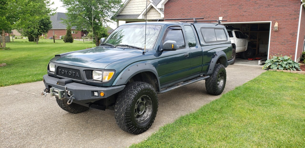

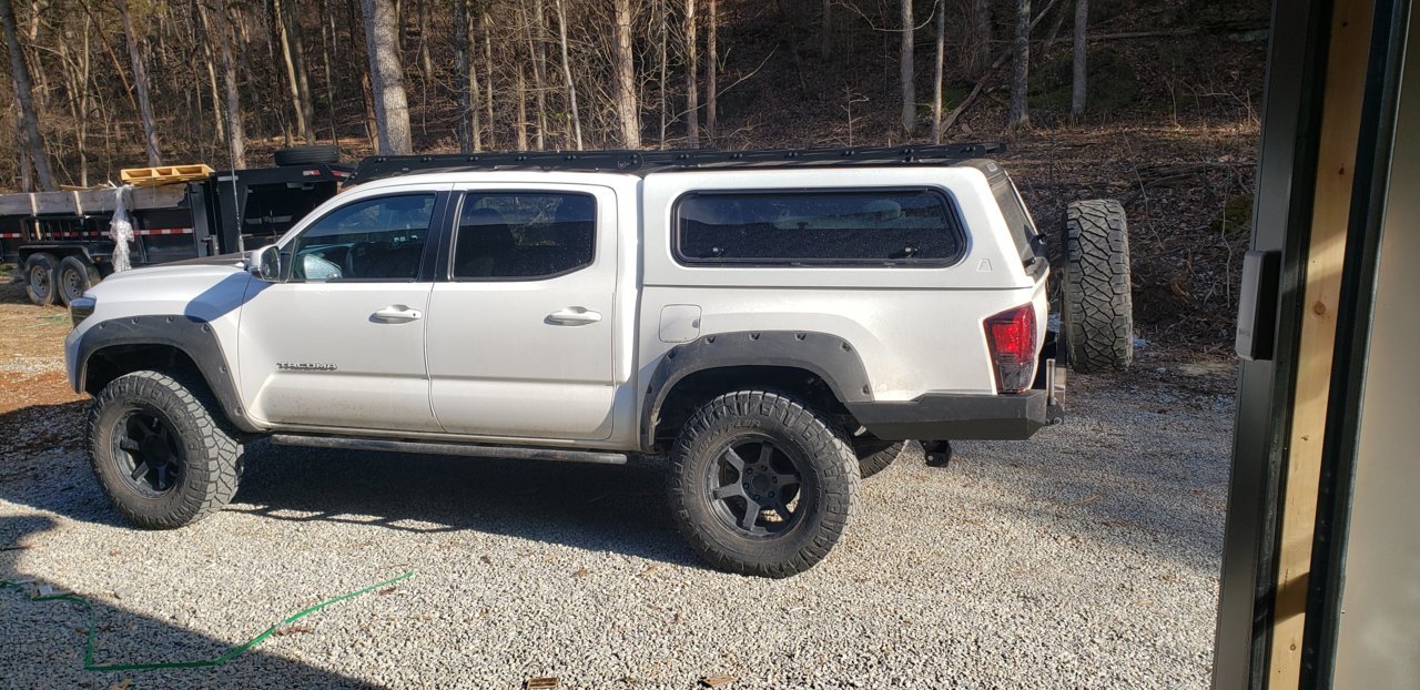

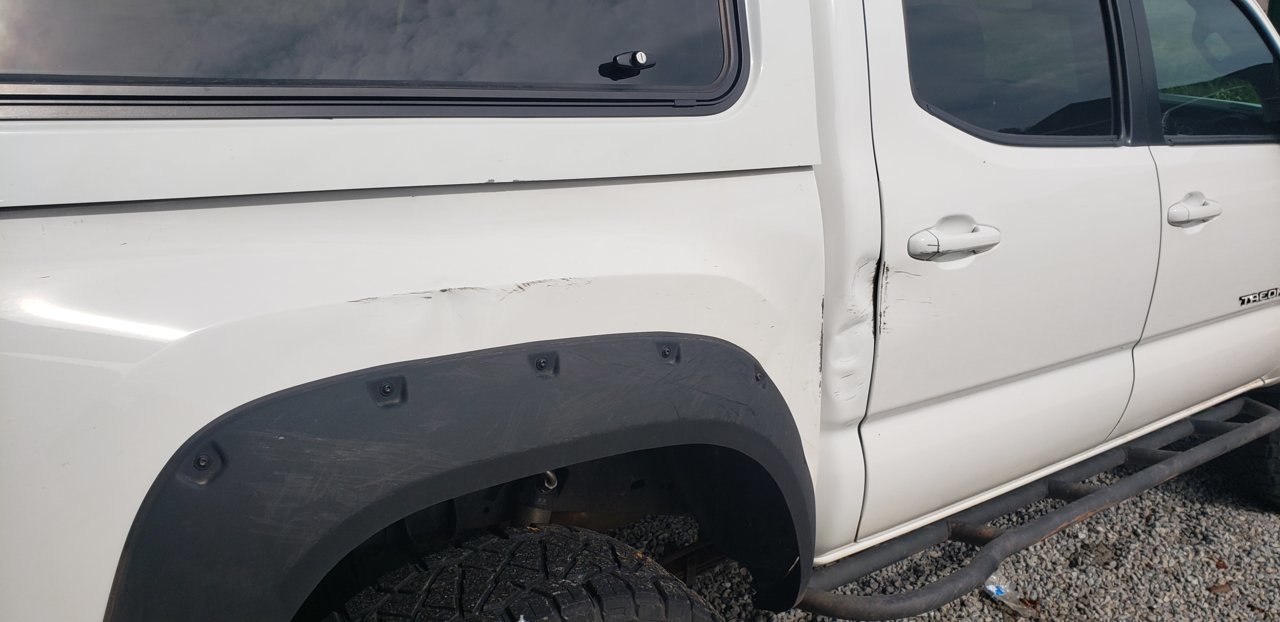

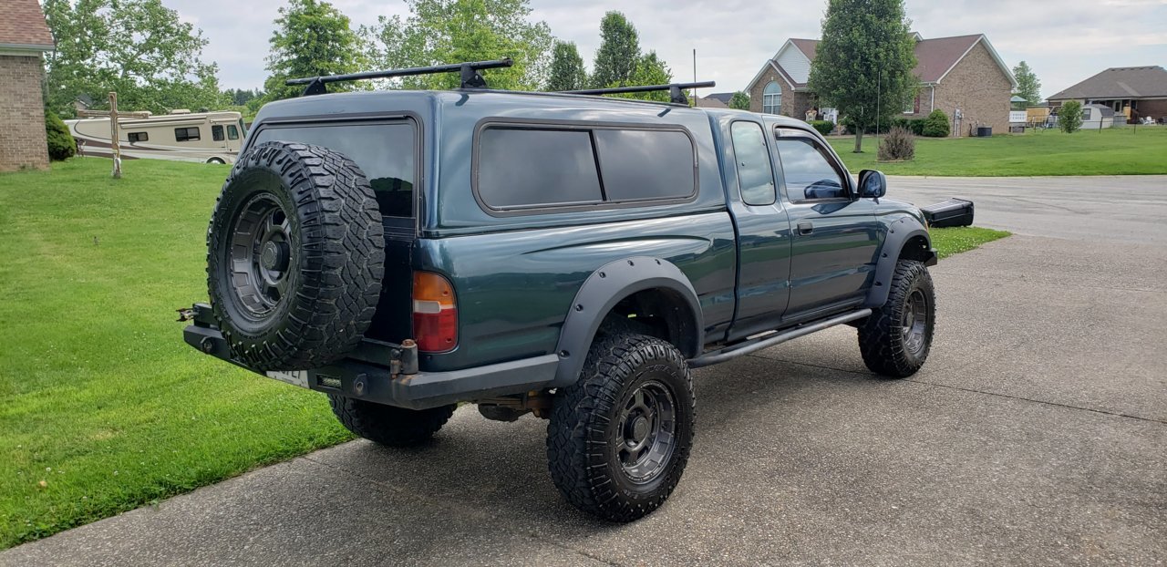

    @Iferrara I love rattle can bed liner, I put it in all the armor I build and my flares. It's quite durable if you do proper prep, it touches up super easy, and I love how it looks.
    20220121_110052.jpg 20211006_143359.jpg 20200609_093140.jpg 20200609_093212.jpg
    In the second pic you can see the body damage I got sliding on a rock, but the bedliner shrugged most of it off.

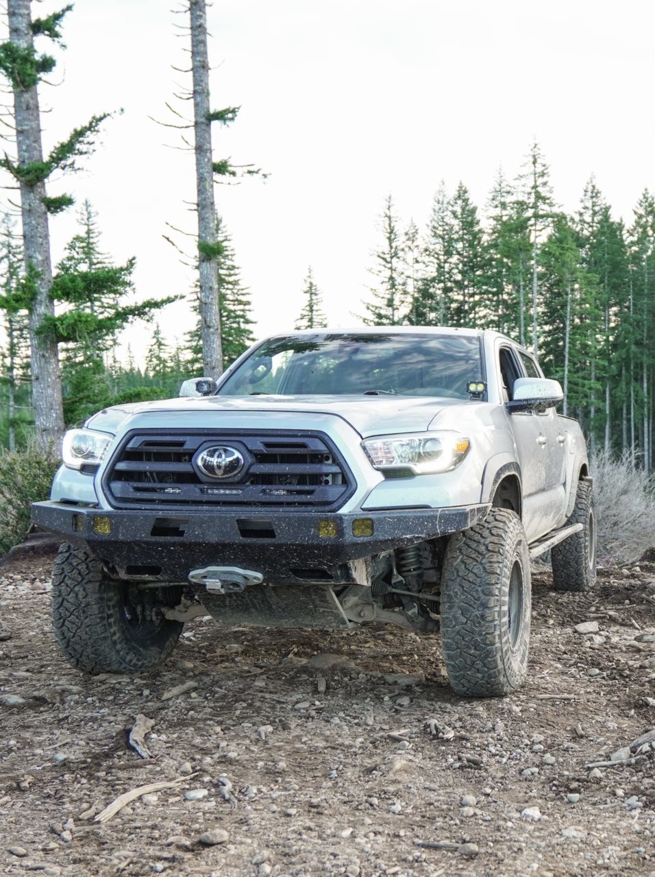

    I just did the Rustoleum rattle can bedliner on my bumpers a couple weeks ago, looks great. Basically just spray paint with some texture to hide the blemishes/a hair stronger than paint. A little harder to wash and get the dirt stains out than a glossy or satin black paint. Isn't too expensive either, think it was like $10 a can and I used a can and a half on front, rear, and sliders.
