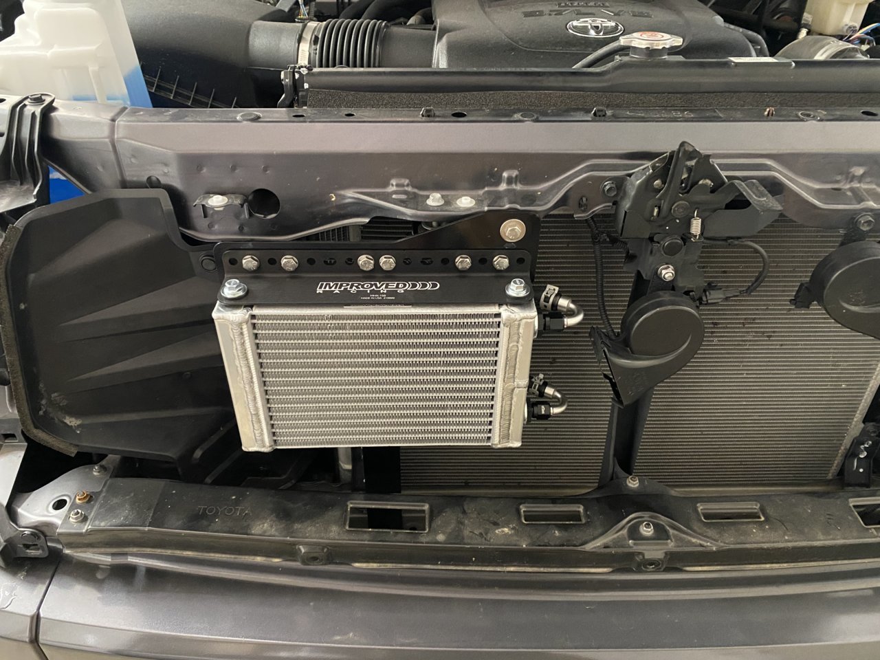

    @81Trekker can help you with a tranny cooler suggestion, he's got a nice set up for the second gens that they've already done on a few trucks prob going to do mine too.

    I've see his setup. Works great if you have a cage but not really applicable for me due to space constraints. Unless we're talking about two different setups.

    Pretty sure the convo's he and I have had are to replace the stock one behind the grill with the upgraded one in the same position

    Then we're talking about different setups. That sounds intriguing and something I'd look further into.

    It would be as simple as just picking a cooler and hooking the hoses from your existing cooler to it. I’ve got an MHX-514 on my tundra and the thing is an absolute unit. You can get all sorts of brackets and fitting adapters from their site to make it a pretty easy plug and play solution. You can even add a push or pull electric fan to it for slow speed crawling if you wanted.

    this is pretty much what I did as well. Added a thermoswitch onto the fan so I can move a bit more air at low speed once the fluid hits a certain temp.

    Careful with thermo switches. If you are adding/changing coolers, make sure you monitor that temp on a guage or with obd2 like Torque App or something like scanguage. Also means you need to check it (the temp) often.

    CSF has a good option for the tranny cooler. Hit me up we are a CSF dealer
