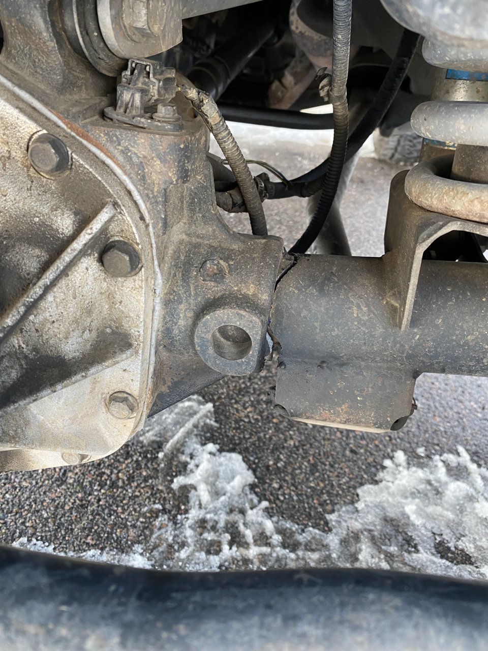

    came into, or I should say drove to, my work the other day.

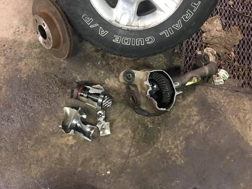

    I’ll play. This one also drove in.

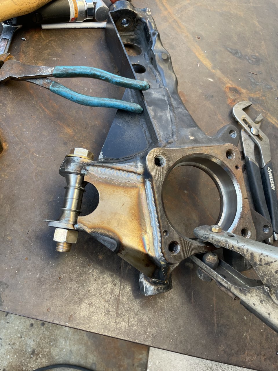

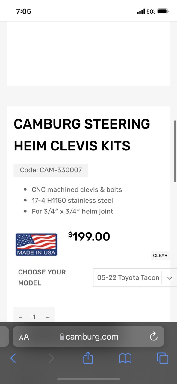

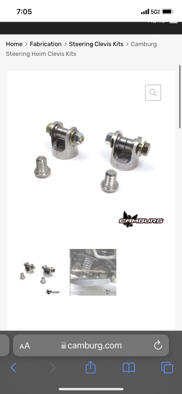

    For any of you 3rd gen owners thinking of doing full heim steering like this. Not sure if the 2nd gen rack is the same? You have to take a small amount of material out of the rack housing on the driver side for the bolt that holds the inner heim to the clevis to clear. If you don’t take material out, you will be bottoming the bolt out on the rack housing at full lock. If you want to install a rack boot, Dorman part# 03670 works for the passenger side. I am searching for a boot that will work with the driver side. I used these clevis mounts from camburg.

  15. Feb 18, 2022 at 7:01 AM

    Nice find. Mind if I post this over in the steering solutions thread?

    Thanks. Still on the stock tacoma rack?

    Yep, Not sure how crazy I want to get with swaps. If there was a semi easy upgrade I’d consider it. I know it’s the weak point now. My suzuki samurai has considerably stronger steering.

    I had to do the same thing on my tundra rack install. Not much needs to be filed off, maybe 3/16" at most.

    Yep, and just were the bolt will contact, I also removed the washers on that side because those were hitting first.
