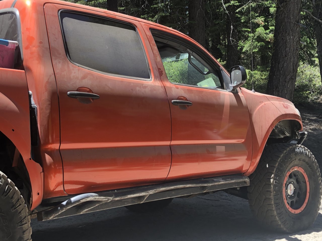

    at 30 do you ever use it as a step or is it too steep? (foot too close to the paint)

    I mean it is fairly close to the body but if you needed to use it as a step you could. Just not really the best use for a step. But I think anyone could use it as a step besides an elderly person. I’m also not super worried about that lower part getting a little scratched by shoes or whatever.

    Yeah I've considered doing a white rhino style lining along the rockers for chip protection. I can make them whatever angle I want but I think they are already 20° which would be good for my wife probably to use for a step. Paint em up and throw some grip tape along the top side.

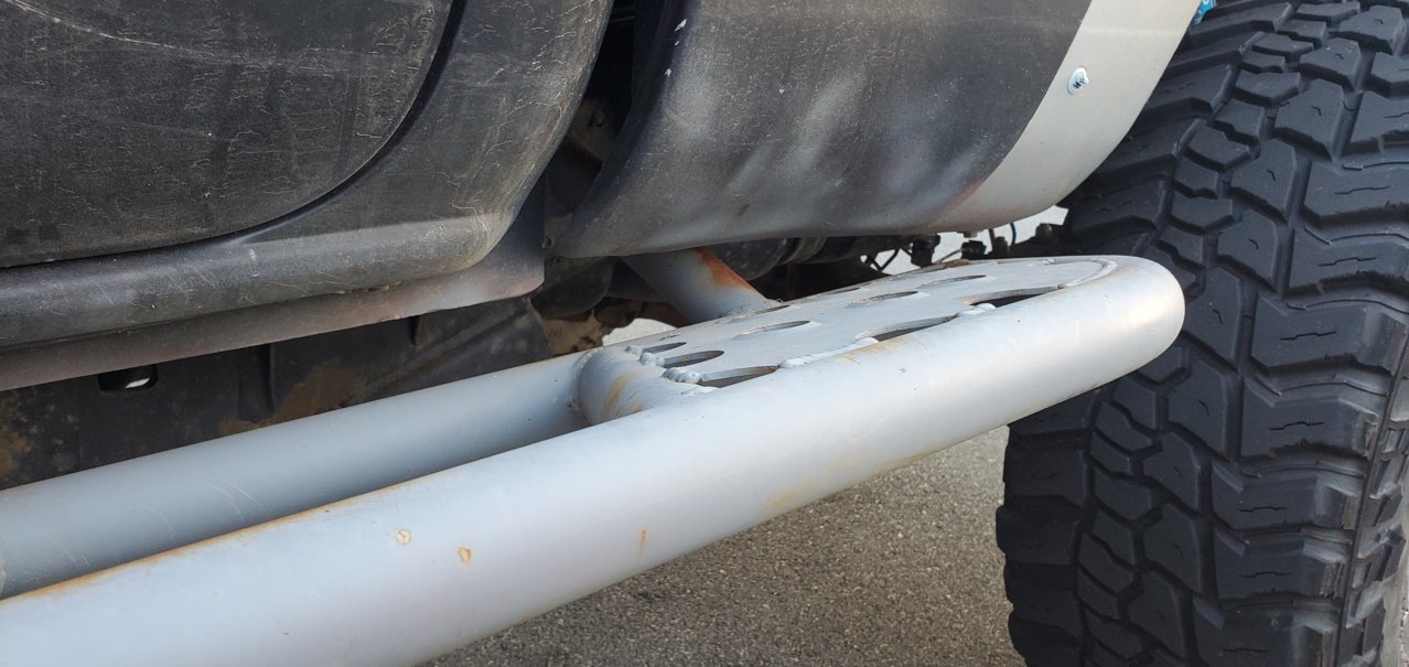

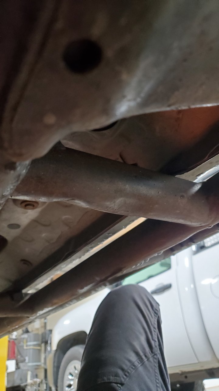

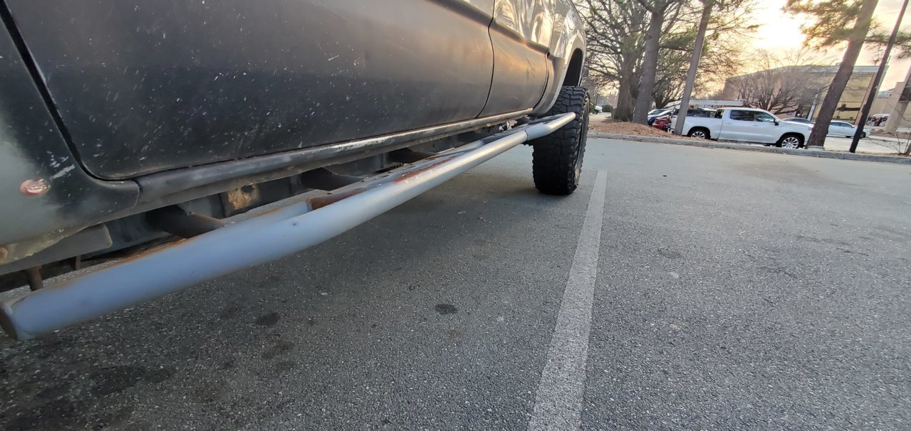

    Here's how mine are layed out and I'd suggest for a DCLB @Slashaar . First one is as close to my body mount as possible to weld the plate. The next 2 are 10 then 13 in spacing. The back one is where the bed is and at the kick up of the frame. Then there is one centered between the 3rd and rear most. The reasoning for the ones towards the front to be so close together is that's where you'll be climbing then coming down the hardest. The rear most is obvious for as much support as possible for how long our sliders are.

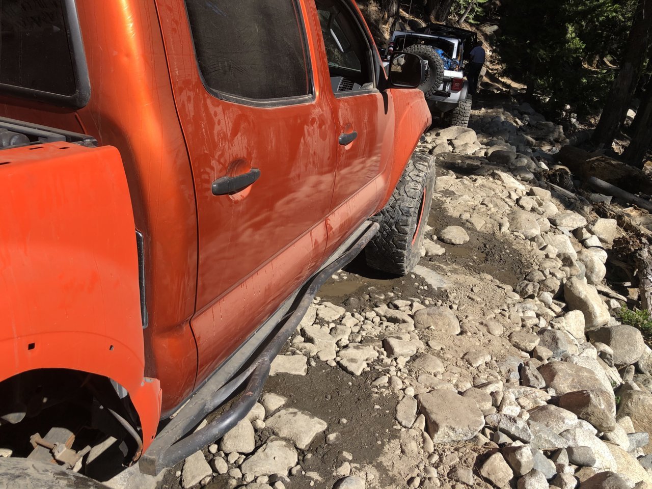

    Fwiw I feel like I absolutely beat the shit out of my old ones with only 3 legs, a terrible design and fitment that included filling in 1/4-1/2” gaps with weld. They lasted me 8 years and were one of the first things I ever fabricated and welded. Only replaced them because they got bent so bad on the rubicon that you couldn’t open the rear doors

    Were they beating the hell out of the body? Like the punch seam area. If not that crazy. I have 5 mounting points and mine seem to hit the body on a hard hit.

    Not really. The legs were about 3/8” away from them and gusseted. I think they probably touched the pinch weld a few times over the years but they certainly didn’t beat the heck out of them.
