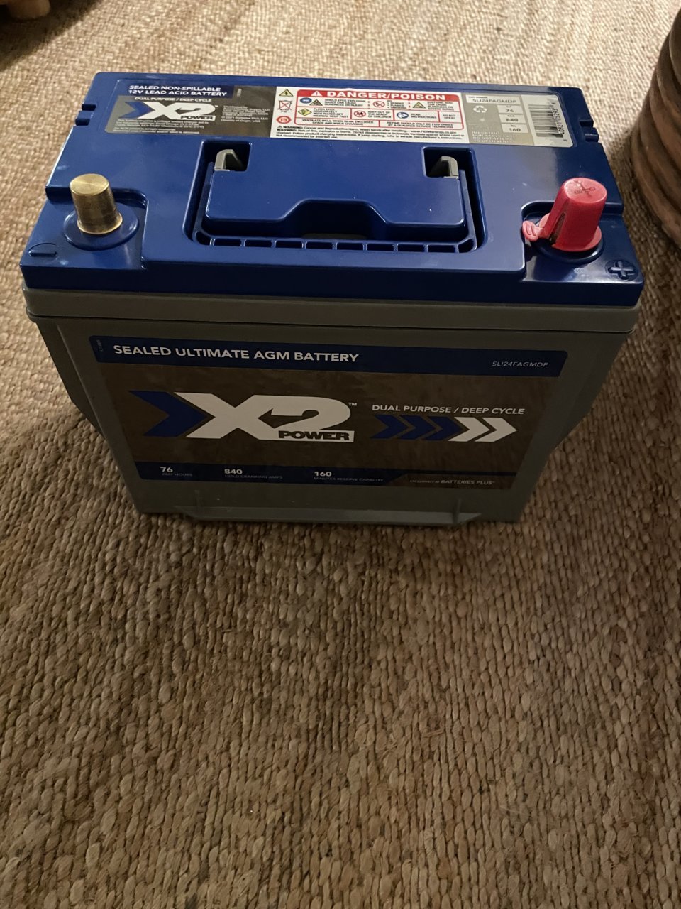

    Went ahead and got the battery. Got the smaller size 24f because I think I will do a double setup eventually. I also think they will be easier to fit behind the seat. This one still has more cca than my original. Safety reminder I wear a respirator and glasses with side shields when grinding and welding. I still managed to get a big chunk of metal lodged in my eye. Could of been a lot worse. The doctor said I got pretty lucky it was just the white part of my eye and not my pupil or else I would of lost some vision. Just ordered goggles I will use from now on. Just remember simple things can prevent a lifetime of regret if something bad happened. Everyone stay safe.

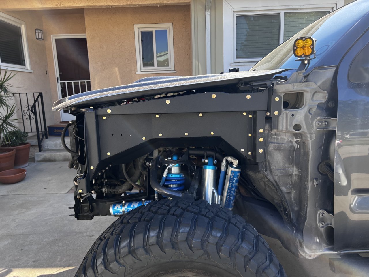

    Had much less time to work on this than I had hoped. Made some progress today. Mounted the fuse box and had to head to work.
    Feels so solid.
