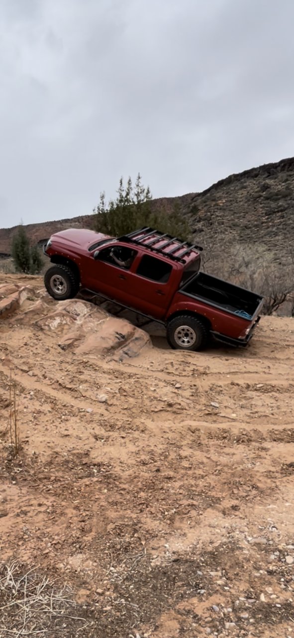

    2014 DC TRD OR
    JD Fab Lower Pivots, JD Fab Slide Rack, JD Fab Inner Fenders, JD Fab UCA, DIrt King LCA, King Coilovers, 4.88 gears, 91 octane tune, etc...
    Got to test out the inner fenders for a couple hours today on some trails. Still have a slight rub at full lock and full stuff. When I install the pivots that should completely get rid of it.

    rubbing on the inner fenders themselves or firewall?

    The firewall, my wheels are -30 offset as well so mine will be worse than a wheel with less offset. Still have a lot of room from inner fenders at least for stock setup.
