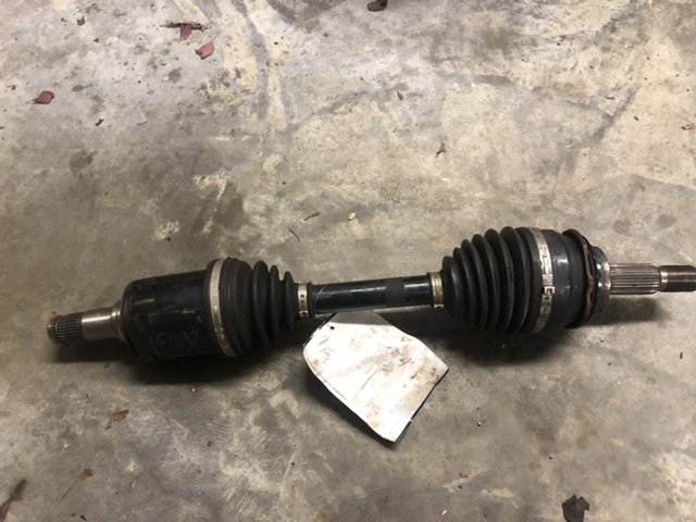

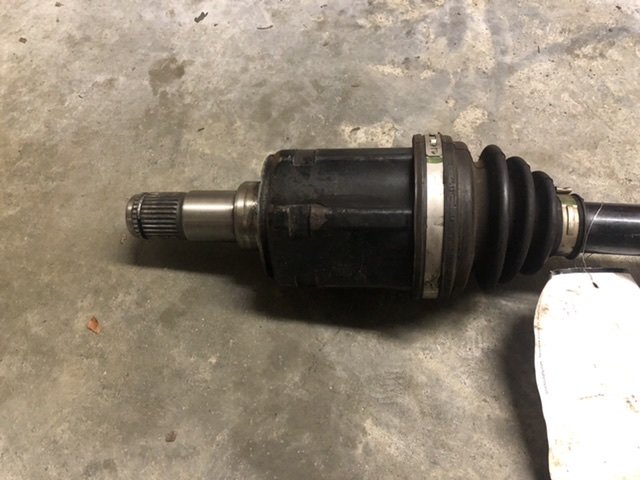

    Was curious to get a double check on if this axle is oem? As far as I can tell it is just figured I would double check. Getting the pieces togethor to get some 934’s hopefully this summer.

    It appears so. It's got those grooves cut out on the inner tulip and has OEM boot clamps.

    I need to see a better pic of the inner

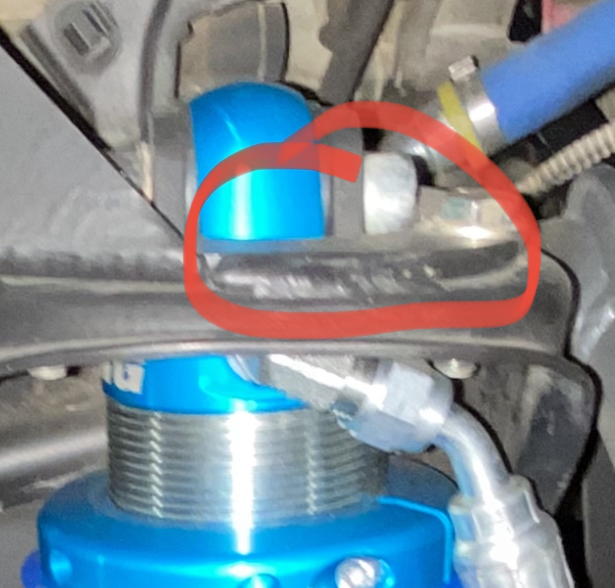

    What is everybody doing with the portion of the bypass mount that sits on the tower? Welding it in or just leaving it? I can see some benefits to welding it, but everywhere I look they appear to not be welded. Any particular reason?

    We welded mine in at the top with small stitch. As soon as we unbolted it, it wanted to pull inboard and all the holes were misaligned. Held it back in place and had a 1 inch portion welded at the outboard side to hold it in place.

    Yeah, I'm thinking about just welding it in solid since there is easy access with the inners off. I can't see any harm in doing it and would imagine it would only strengthen things.

    I left mine alone. Figure that welding it wasn’t necessary when everything is bolted together

    This is what I do

    upload_2022-3-8_7-17-37.jpgWeld it!

    Yes that’s OE
