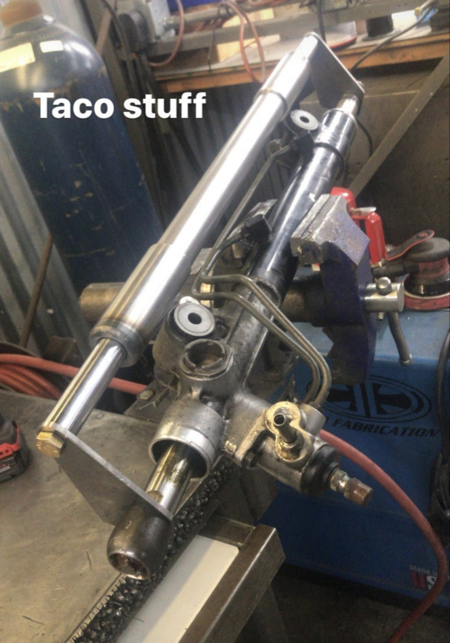

    81Trekker
    81Trekker [OP] Well-Known Member
    Aug 25, 2019
    #303299
    3,750
    La Jolla SD
    81 Trekker and 2015 CCSB Tacoma
    Too many to remember
    It’s not even close to being finished but I figured a little teaser pic was in order.

    Makes me wish I would have held off on switching over to full hydraulic.

    81Trekker
    Aug 25, 2019
    #303299
    3,750
    La Jolla SD
    Going to start with a Howe modified pump and quicker... will add a ram if necessary

    Excited to see how it works out. Have you had any issues with your rack ends bending/deflecting?

    81Trekker
    Aug 25, 2019
    #303299
    3,750
    La Jolla SD
    The reason the stock racks break is because of the deflection. The idea behind the slide rack is it will eliminate all deflection in the stock rack. The line pressure can then be increased and a quickner added

  16. Apr 14, 2020 at 8:10 PM
    #1276
    Robertocritser
    Robertocritser Well-Known Member
    Jul 21, 2010
    #40524
    7,216
    Levi
    KY
    08 sport
    ATM6969420 series
    Yea I killed 4 racks because of the deflection. Hopefully not anymore though.
