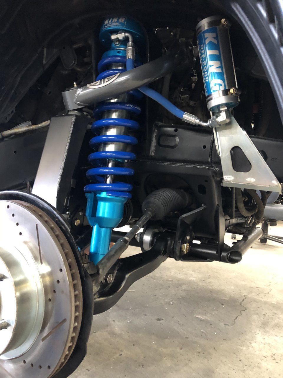

    So if you don't get the steering slide rack kit then you can't move your LCA's forward?

    Yes
    I'll let @81Trekker answer that one, I don't think so but I'm somewhere between half and two thirds stupid so I caution anyone against making life decisions based on anything that I say...

    I feel like if you keep your factory inner tie rods you should be fine. I had mine pushed the full 1" forward before the slide rack and didn't have any issues or notice anything. But then again I never did look either. Just kind of sent it...

    I may be 39/64th's stupid but yeah there is no way that your tie rod was not hitting lower coil seat or spring near lock

    May have been. I only drove it like that for a week.

    You can run the lca kit without the slide rack.
    Here is Harry’s original set up. How much caster built into the upper arm might vary others experience.

    Performance Elite? That’s a stock length shock?

    WAIT ! the other 25/64th's of partial intelligence just kicked in...the CO is attached to the LCA, the LCA is attached to the LCA tabs, the spindle is also attached to the LCA & the tie rod is attached to the spindle so when you move the LCA forward the tie rod moves forward with it so it's probably not as bad of a dry hump as I thought.
