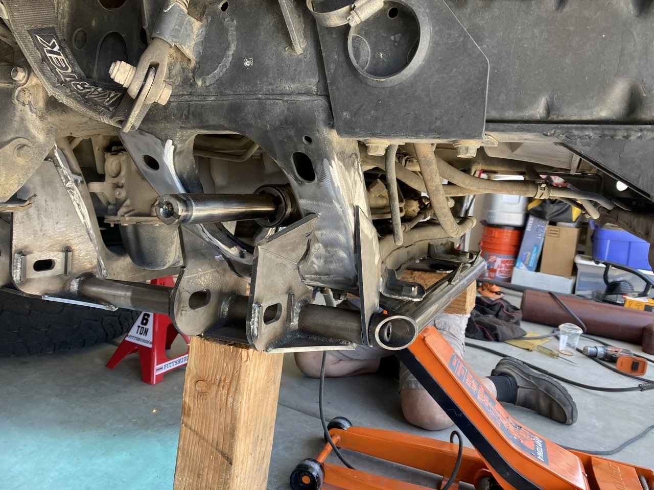

    I used floor jacks and 4x4s and the full weight of the truck to get the pivots as tucked into the frame as possible. As suggested by Harry.
