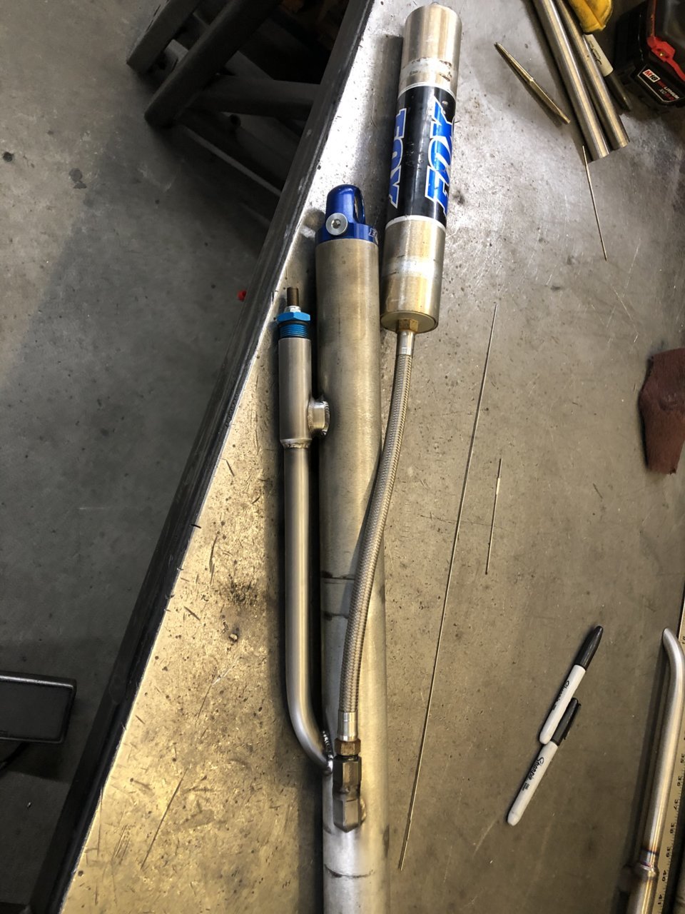

    This is what happens when king and fox have a baby... you get 2.0 free bleeds :)

    You going to use 5/8" or 1/2" tubes?

    5/8

    It would be awesome to use the fox tool less adjusters with free bleeds.

    King already makes the same thing

    Should have gone with a bigger hose for a 7/8" shaft. :boink:

    I just used what fox supplied these shocks with for decades... hopefully they finally figured out that the hoses they used forever are too small :)

    Is my thinking correct that the resi being mounted low on the body has a substantial benefit over being off of the top cap? I've had theories in my head for a while, just never really asked anybody.

    From what I’ve researched, it helps on compression dampening. The piston doesn’t have to fight with a variable area where the nitrogen is. Also read that the nitrogen section would not see spikes in pressure from the compression stroke. I guess it creates more control on the compression. At least from what I read about it.
