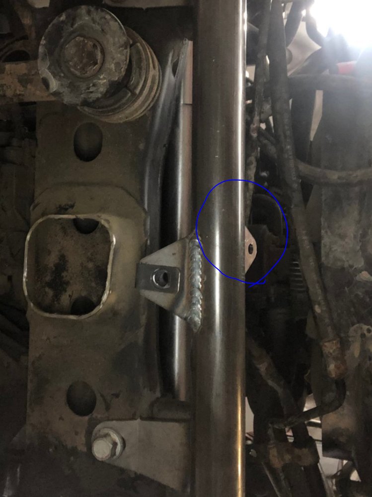

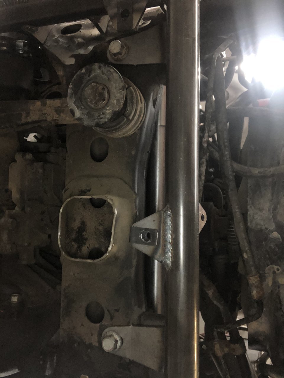

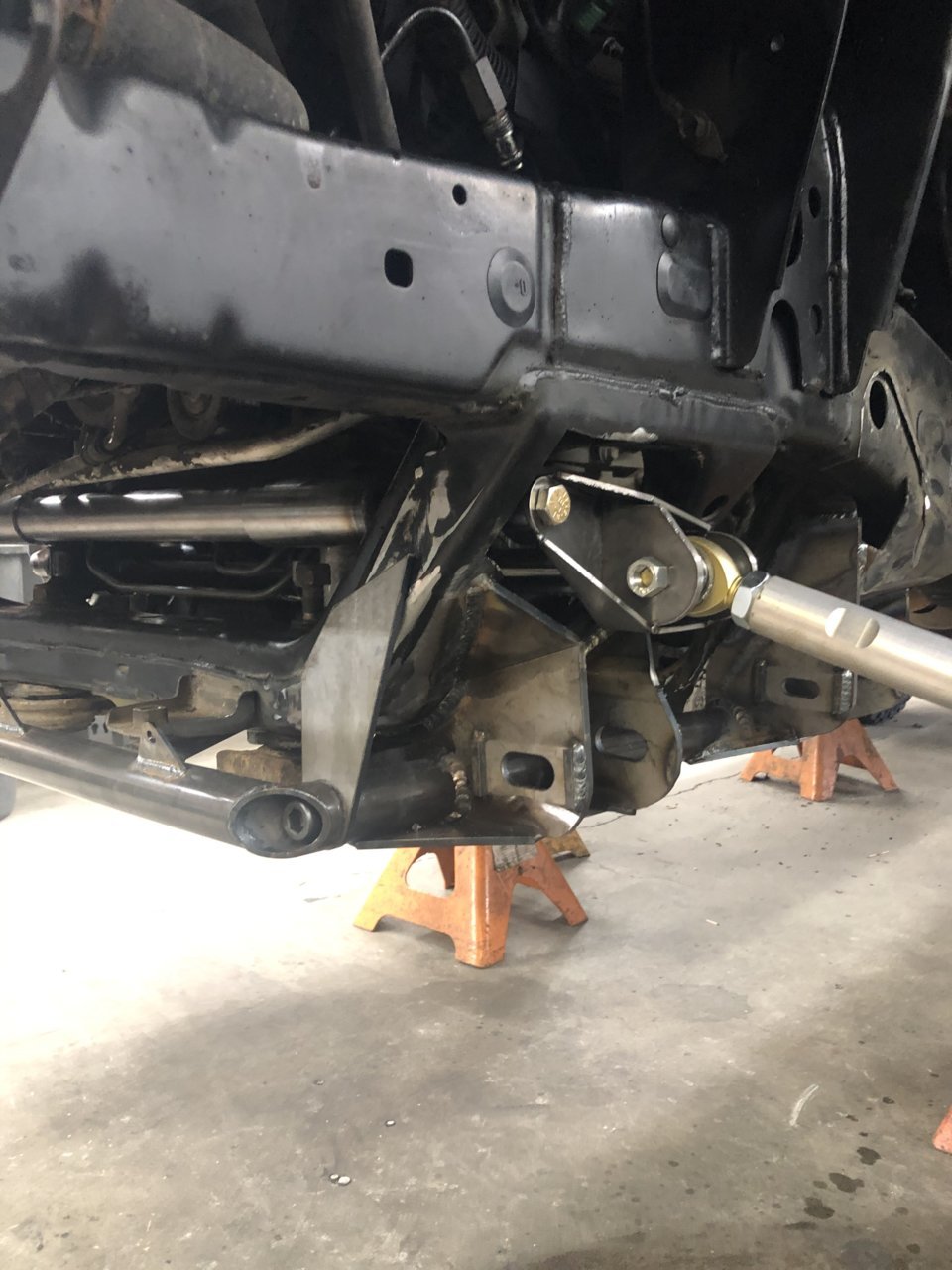

    Was hoping for some description of the two upward facing tabs on the front cross brace. Haven’t seen these in other pictures. In the parts list I see reference of 2 bolts for transmission lines. Are the two tabs meant to hold the cooler lines in the event a user wanted to completely relocate them and cut off the lower forward crossmember of the frame that holds those lines now? Only thing in that region is power steering lines currently.
    I see a pic of OP’s truck on page 18 that has the front crossmember cut off but can’t see what happened to the lines that go to radiator and trans cooler.
    Thanks

    Those tabs hold two factory crossmembers that go from the sub-frame forward to the cross member below the radiator. They also are the front mounts for the factory skid plate. Most aftermarket skid plates that I've seen have you remove them to install their skid.

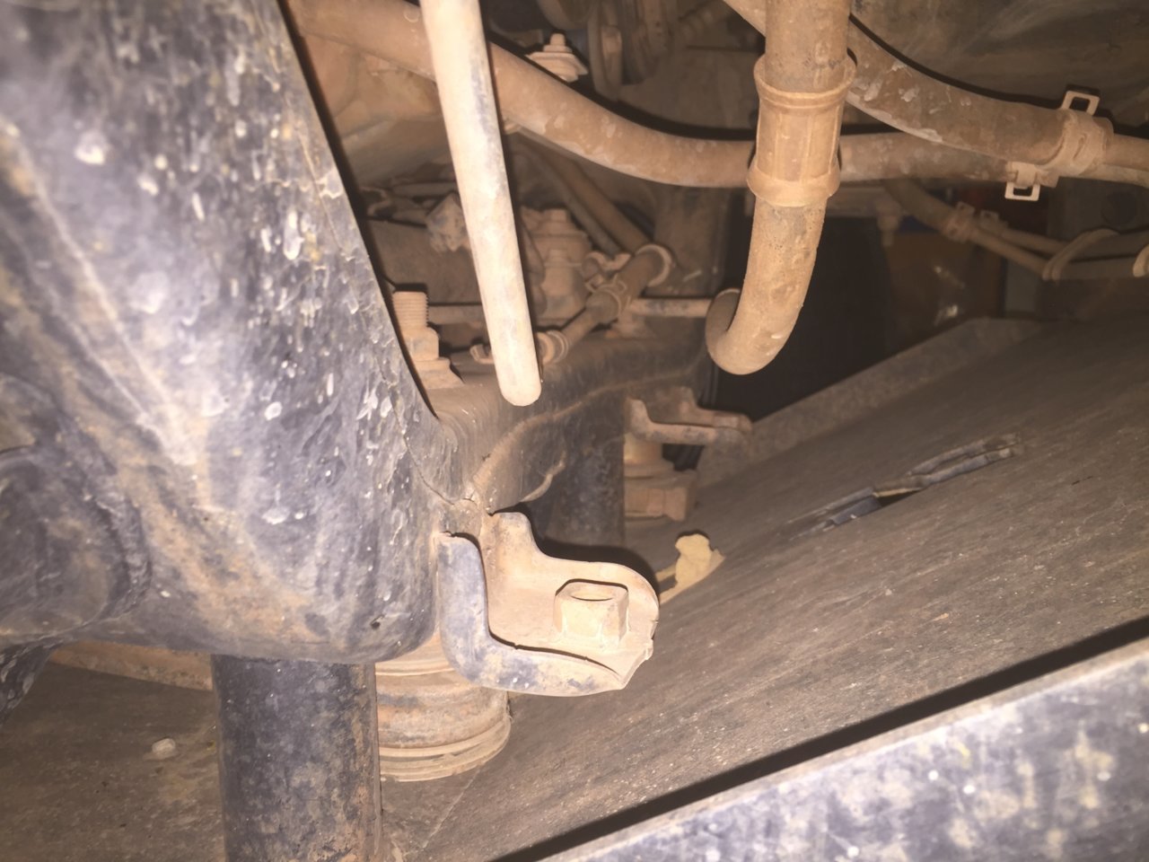

    I thought the factory skid plate bracket/mounts went from the horizontal threaded locations on the cross member (visible in first photo), and up to the radiator cross member on the bottom side. But maybe my memory is bad. Yes, most skids including mine have you remove those, but it has been a really long time since I've even seen those parts, kind of forgot they ever existed TBH.
    The two tabs on the new assembly are both biased over to drivers side.

    This is correct, it’s for cutting off the low hanging stock crossmember

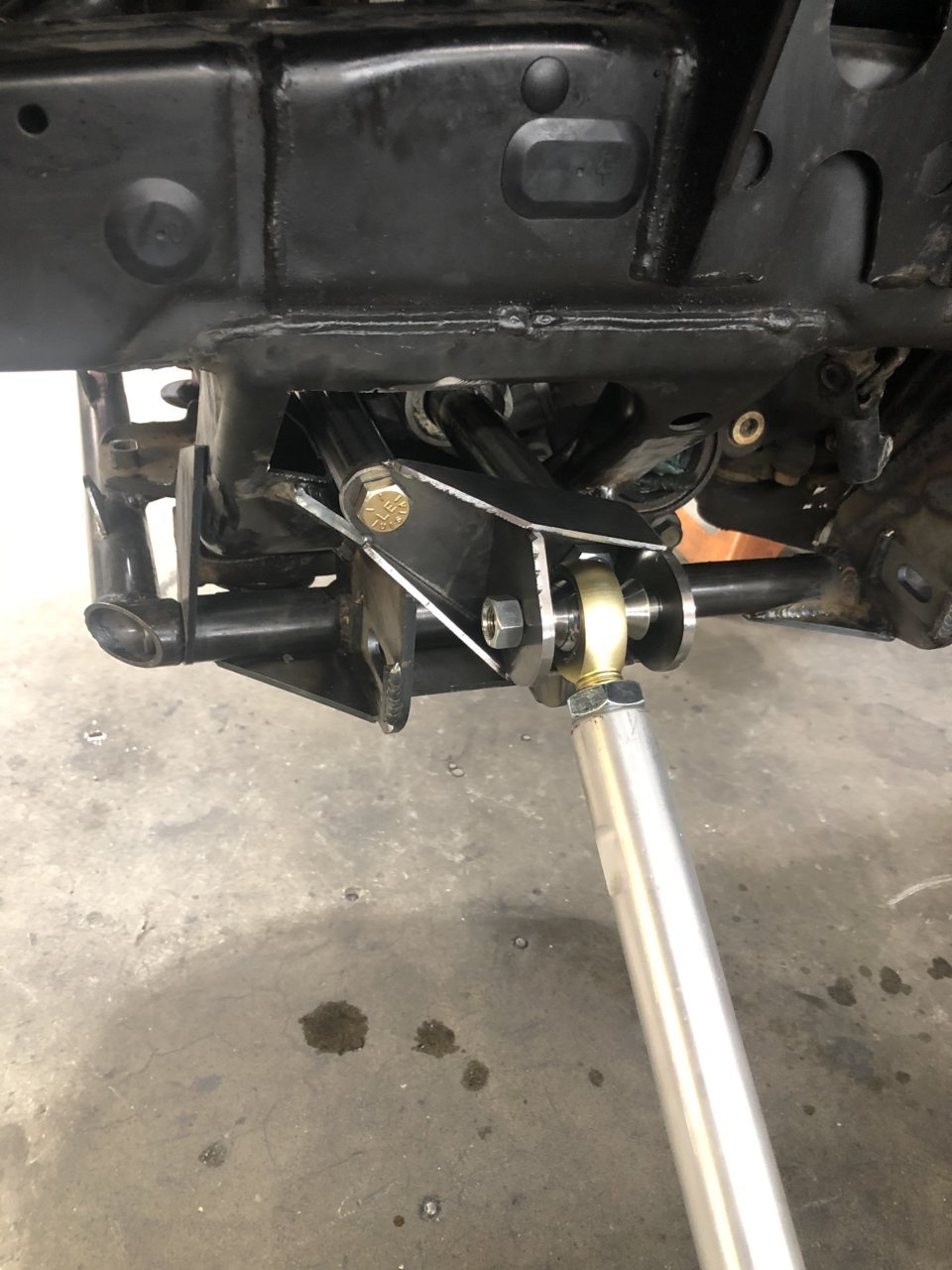

    Big boy steering

    I think racebug was asking about the tabs on your part there, not the horizontal tabs with welded nuts on the stock frame

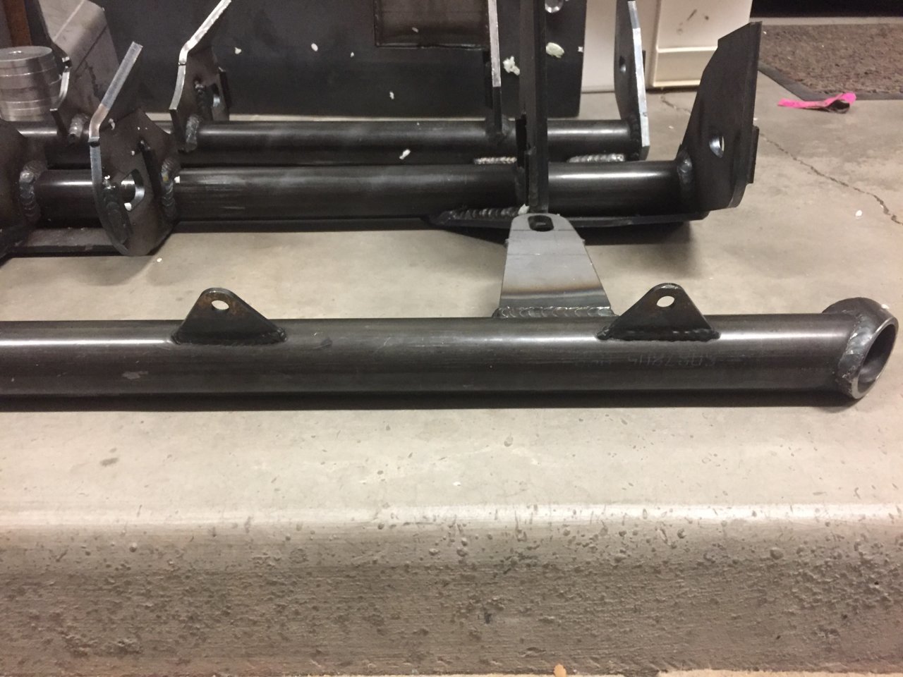

    Here is the answer to race bugs question

    no, I get the alignment tabs that are on the backside. self explanatory there. These are the ones in blue that I am asking about.

    Those are for the tranny lines when you cut the stock front crossmember off

    And perhaps the steering cooler for those that install this on their 3rd gen though those guys don’t really off-road of course

    OK, that is what I was originally asking/thinking. Acould probably do some hand bending of the hard lines, then re-make the rubber portion to mate up (passenger rubber lines could probably be shortened, but new longer ones on drivers side)
    Thanks for confirming.
