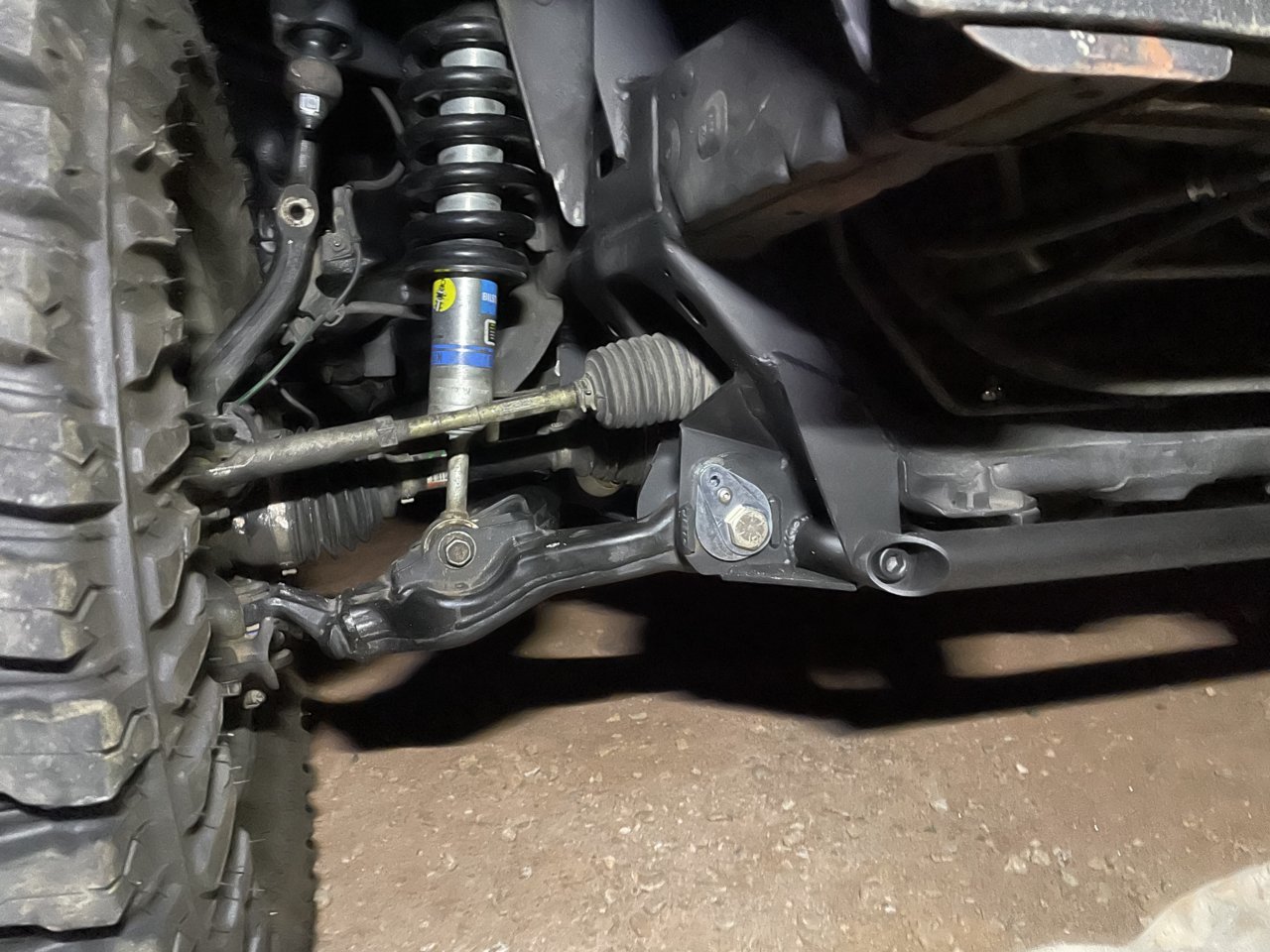

    That driver front bolt I was fighting to get it to sit right but that was the only way I could get it to sit in the tabs properly. I mean as long as it’s locked down where it’s at it should be fine right? I might re-do it when I do my slide rack. I just want to understand it. But I can’t seem to understand the difference between the 2 options and the proper orientation. I messed with it for like an hour trying to see if it would click in my brain but it just never did. I’ll probably just have Harry explain it to me when I go get the slide rack.

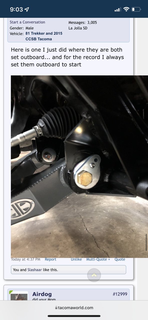

    Here is one I just did where they are both set outboard... and for the record I always set them outboard to start

    Trust me.....I had the same issues getting my head around it also. But the rear config the way it is could be why you cant get more caster.

    they definitely weren’t right(aligned to the outside) before the flip. It’s almost like you put them back the same way they came out.
    I’m also one that was challenged by understanding the cam setup too, for the record.

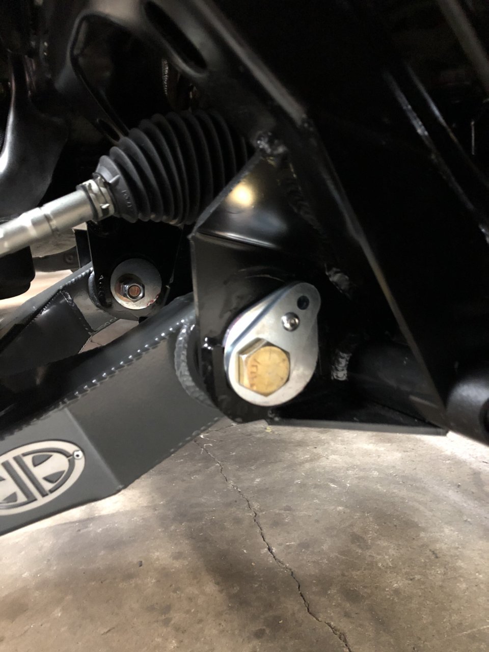

    So hopefully this isn’t a dumb question just trying to fully understand.
    So in this picture if this is pushed all the way out you put the teardrop rotated as far left as you could with the skinny side of the washer out on the opposite side. Then rotate as far as you can clockwise?

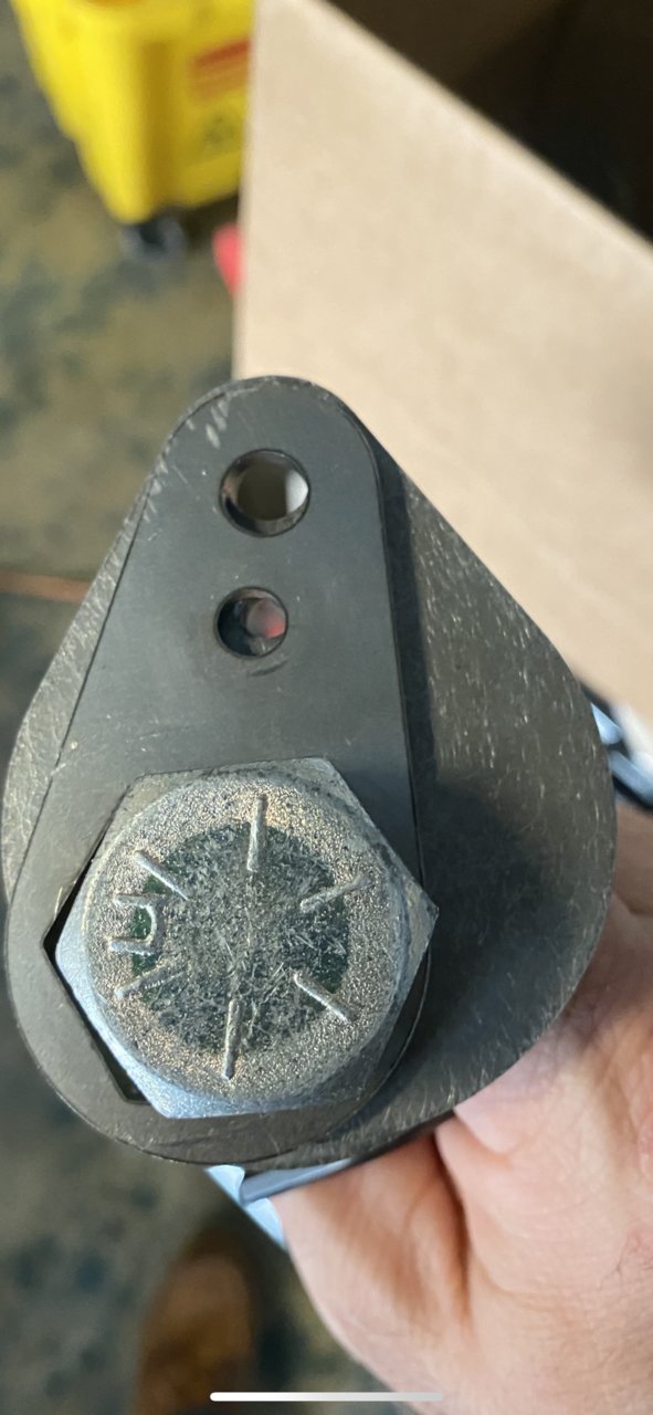

    I don’t know if you can see from this picture, but the bolt hole is not centered on the tear drop. It’s offset to the left here. Once installed, when looking from the front, this would put the passengers side arm in a position to be more outwards(negative camber) than if it was flipped. The round cams for the back side of the bolt operate similarly. So you want them both in the same “phase”. This design allows for more adjustments in the slot. While still getting the locking force of the tear drop cam.
