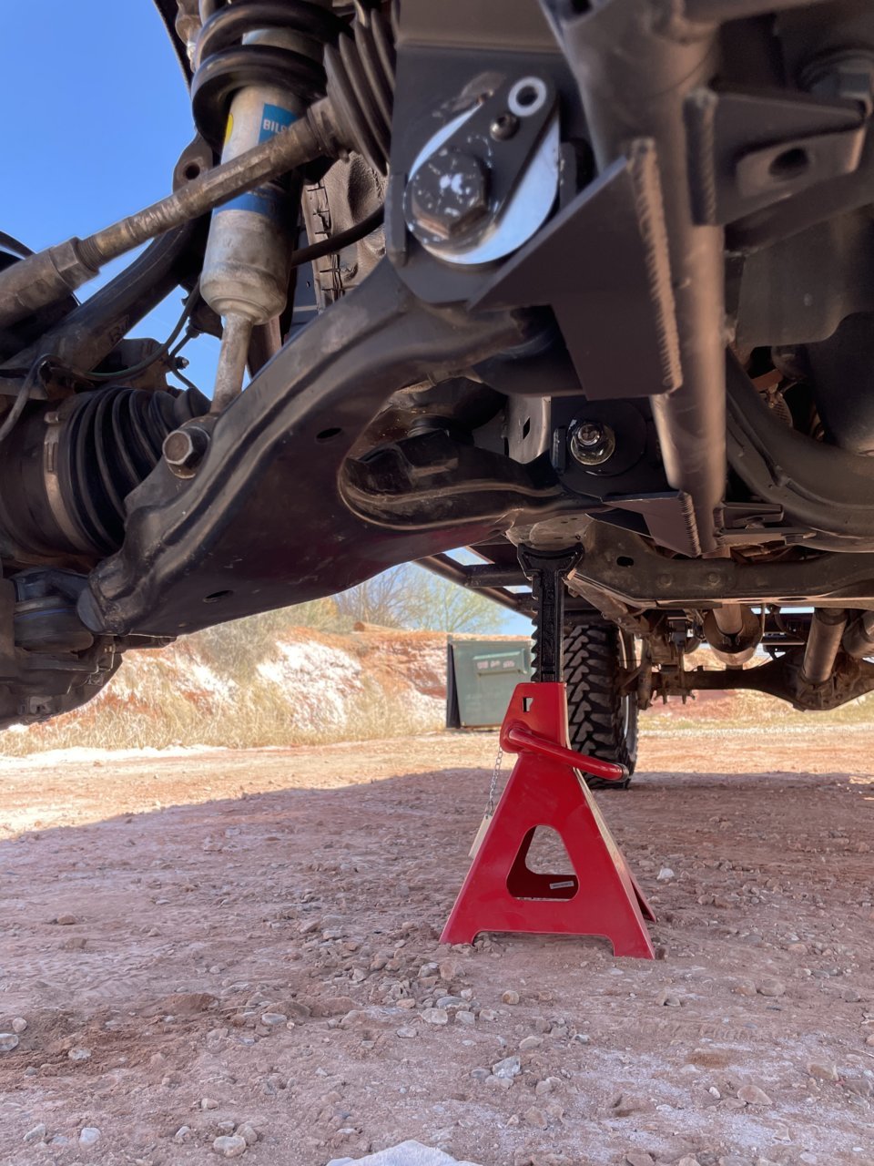

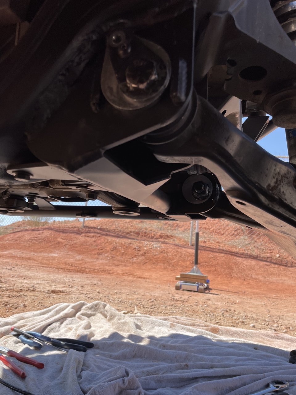

    Pushed both all the way out. Then adjusted toe. My camber looks way better. I can tell there was quite a bit of force on the bushing when I loosened it so glad I fixed it.

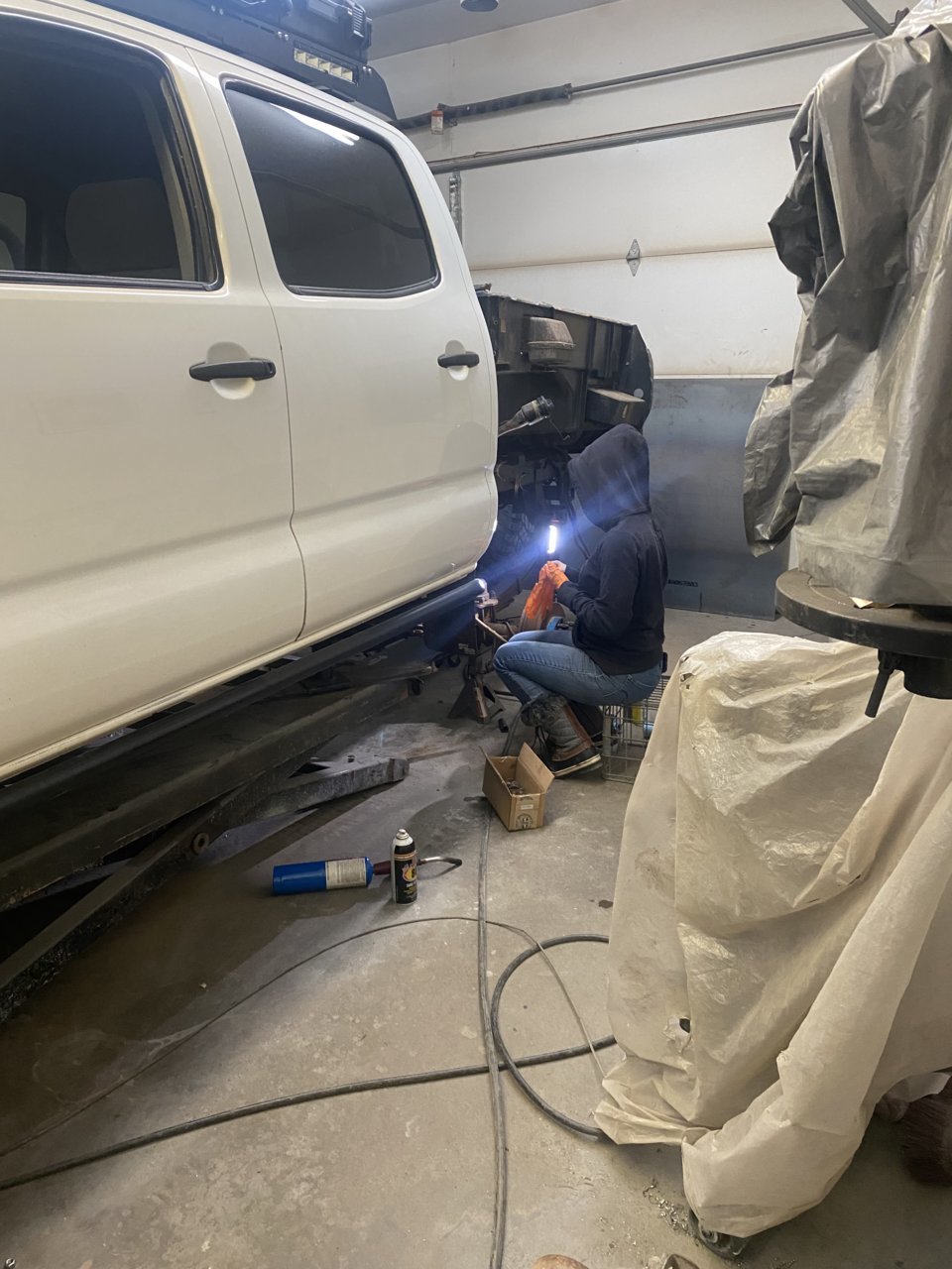

    Starting on the rear tonight. I’m stripping parts down and probably drinking too much while the fiancé does some cleaning to get everything ready.

    Dang, at least get the woman a more comfortable seat :help:

    Two things, it looks to be cold there and she appears to be a keeper.

    I gave her a nice rolling stool and the next time I turned around she was sitting on that lol.
    Lol, it was a warm day at 34*. And she is. This is our thing and we’ve been building it and enjoying it together for the last 4 years.

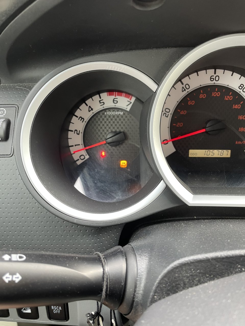

    So after driving around and messing with my alignment to see if I can get it dialed in this light is stuck on

    Was there any grounds that you loosened, un bolted while installing the LCA brackets? Check the driver side frame area behind shock mount.

    Just went through this same issue but on my 3rd Gen. Just needs to be reset. For my truck it was just a scanner reset and disconnected the negative on the battery for 10min.

    I’ll go back through and double check. It was fine with the first alignment then after I switched the cams it turned on. Might of just taken a while to turn on though.

    Abs/brake light on too?

    No just that stabilization light or whatever it is.

    @lferrara what @Airdog and @AY_ARONTRD said. The steering wheel angle is off center. I use the same method he posted in the other thread.

    Thanks! Yeah I am doing that now. Seems straight forward. Thanks for linking it @Airdog

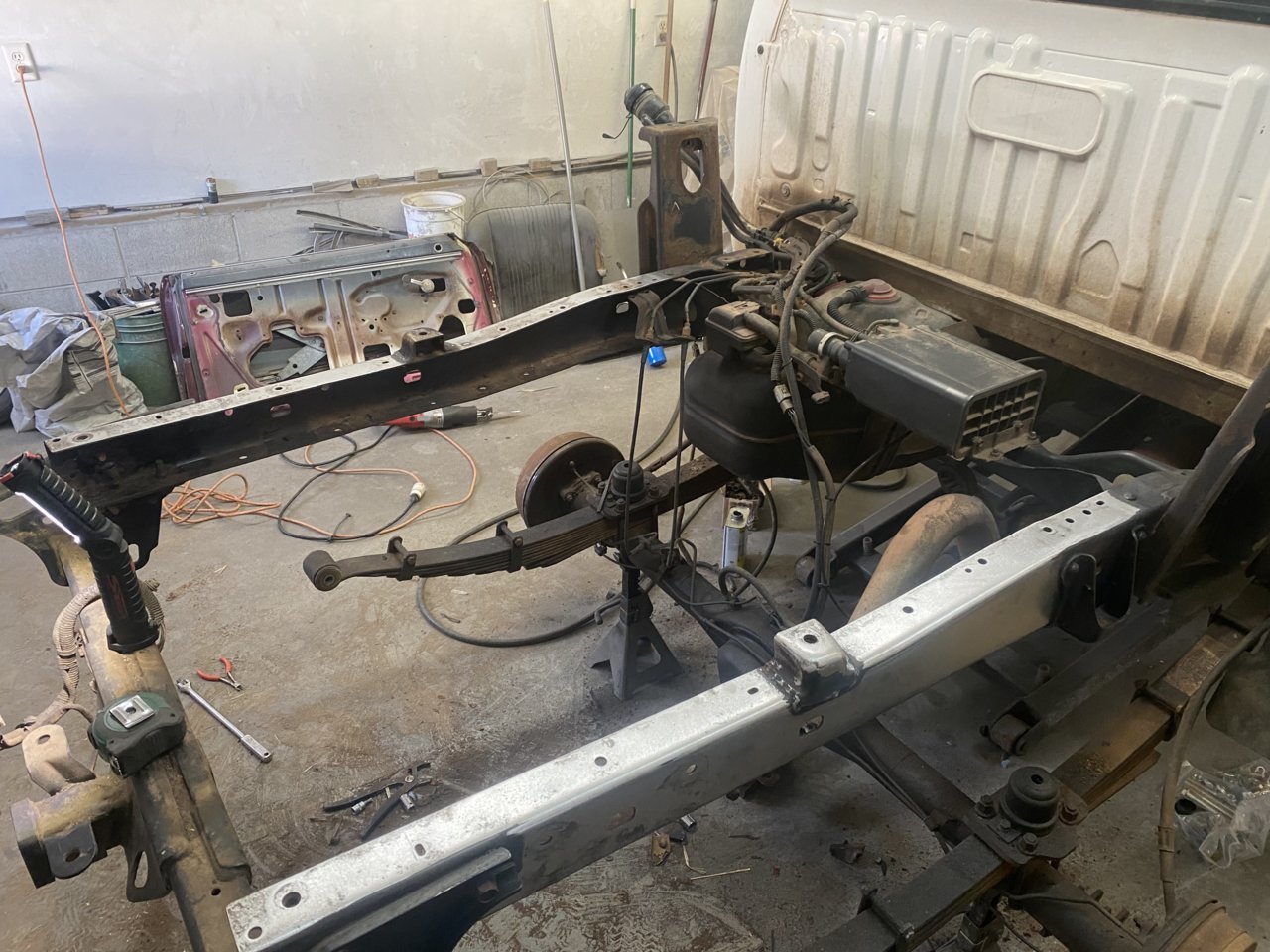

    Having fun today!

    what / how are you replacing the spare tire cross member ? did you get the jd fuel cell kit ?

    Just boxing the frame and doing tube work to brace it.
