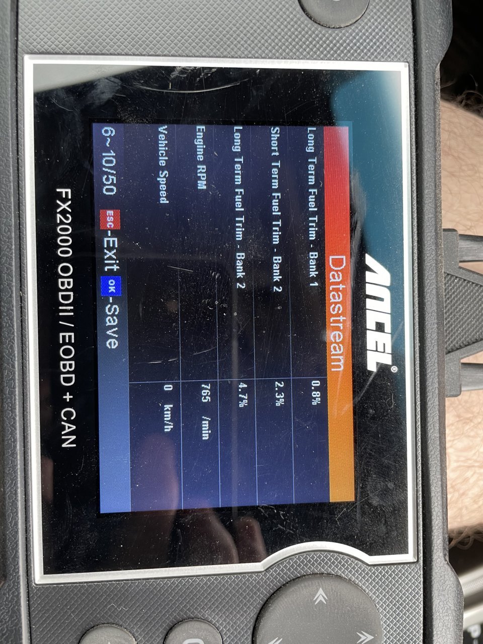

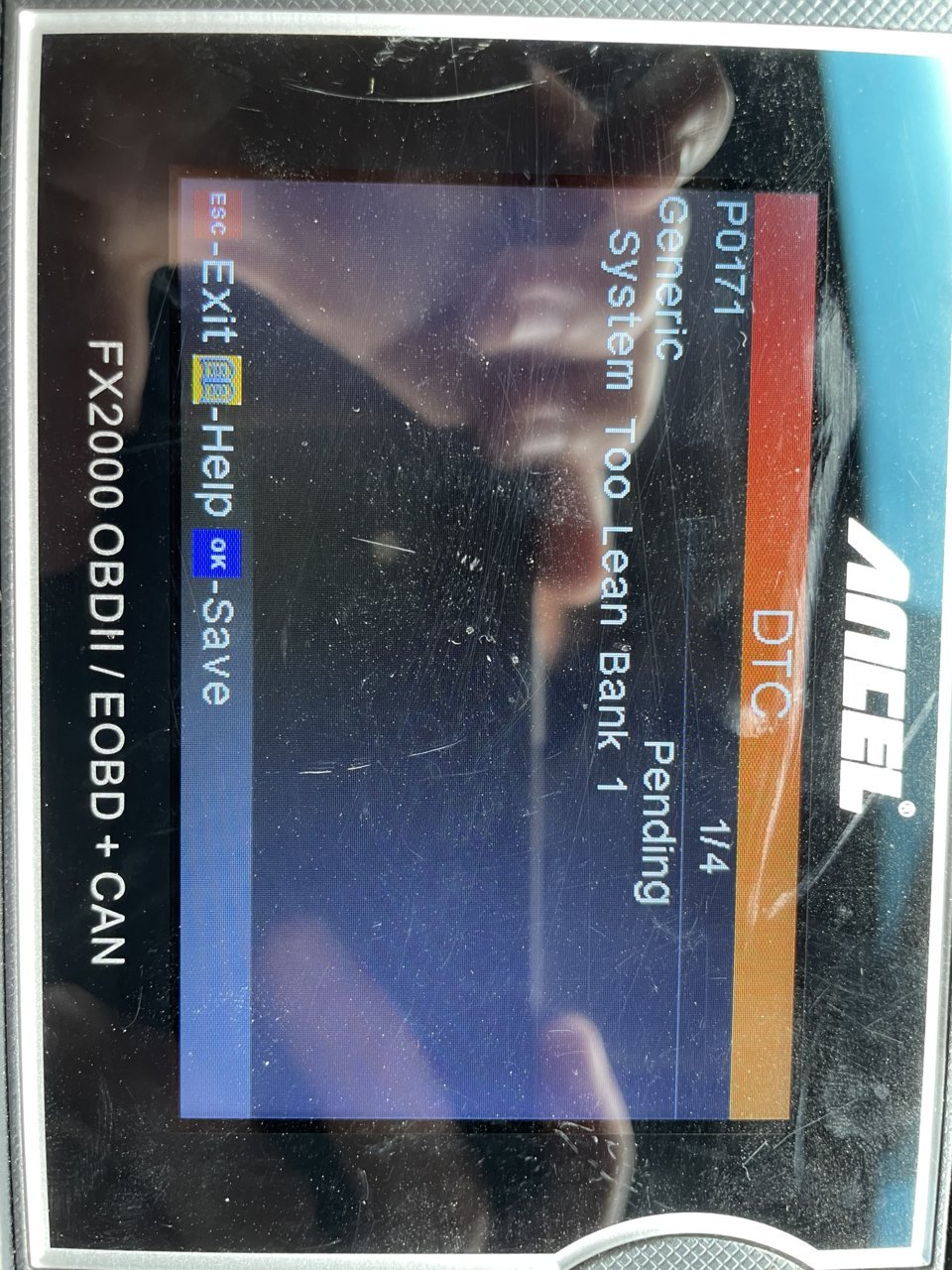

    Okay cleared that by recalibrating the vsc. Then I got a check engine light and a trac light on. Wtf. All 4 codes are lean codes.

    Are they for both banks? Did you accidentally knock a vacuum line off or something

    Yeah and a random misfire code. I did put a oil separator canister in. Must be that. I will double check the lines.
    edit: I feel like an idiot. Haha I had the breather hose on the oil canister and forgot to change it to the gasket cap. That was definitely it.

    Well that was simple and easy fix glad it was just that.

    Yeah me too. It was idling like dog shit. And my fuel trims were bouncing around everywhere. They look better now.

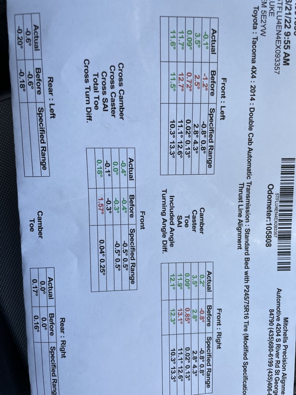

    Okay so with both cams properly setup and maxed out I was right around -1. I decided to bump up the caster and bring the camber to 0. Seems like the max I can get with 884’s. Must have more of a lift in the front than I thought. Probably could hit the 4 caster and -1 camber with stock springs. Unless something’s tweaked but for me that seems like the best I can get. Drives so much better with the additional caster from the pivots though!
    edit: I made sure to go in with a full tank of gas so I think when some of that weight goes away after driving they will even out perfectly.
