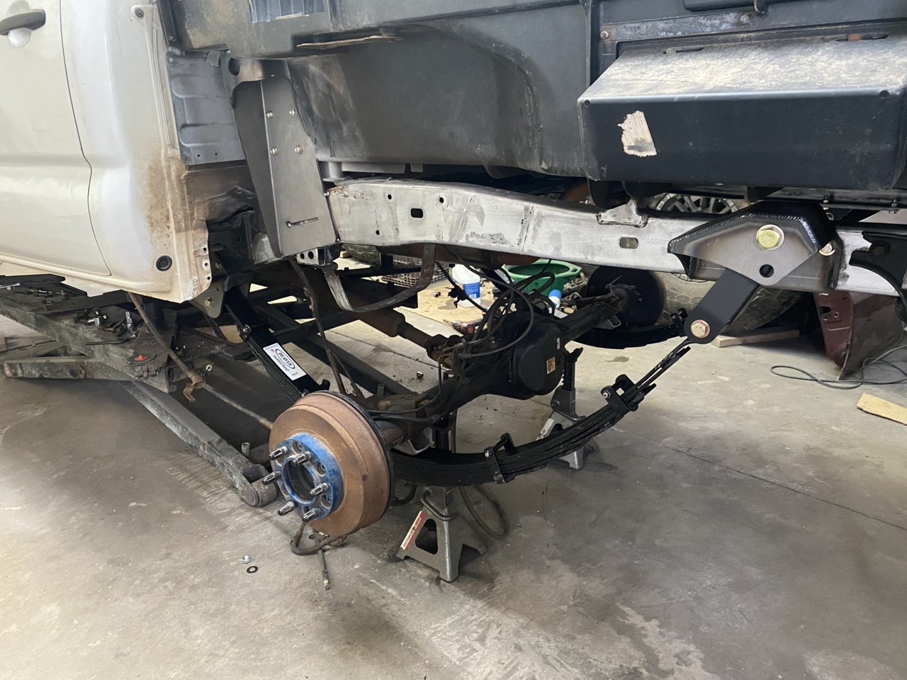

    18hrs on the second go with the jd fab subframe. Subframe, uca double shear, and a respring/revalve. Working my way towards Harry status and 16hrs although my arms are absolute jello now.
    Only picture I took all weekend lol.
    Old welding glove sleeves make great shields for the cutting/ grinding phase of the subframe. Complaints before starting everything were clearance issues with 35’s and harsh top out. Clearance issues totally solved, but I got scared on the revalve and only made minor changes. He said it still tops our real hard but we switched to 700# springs from 650 and with all the geometry changes I didn’t want to change valving too much until the ride height and alignment were dialed in. Alignment in a few days and revalve probably next weekend with some more drastic changes to rebound.

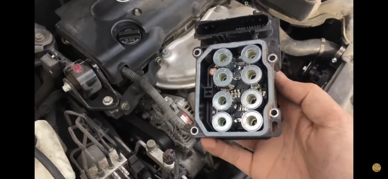

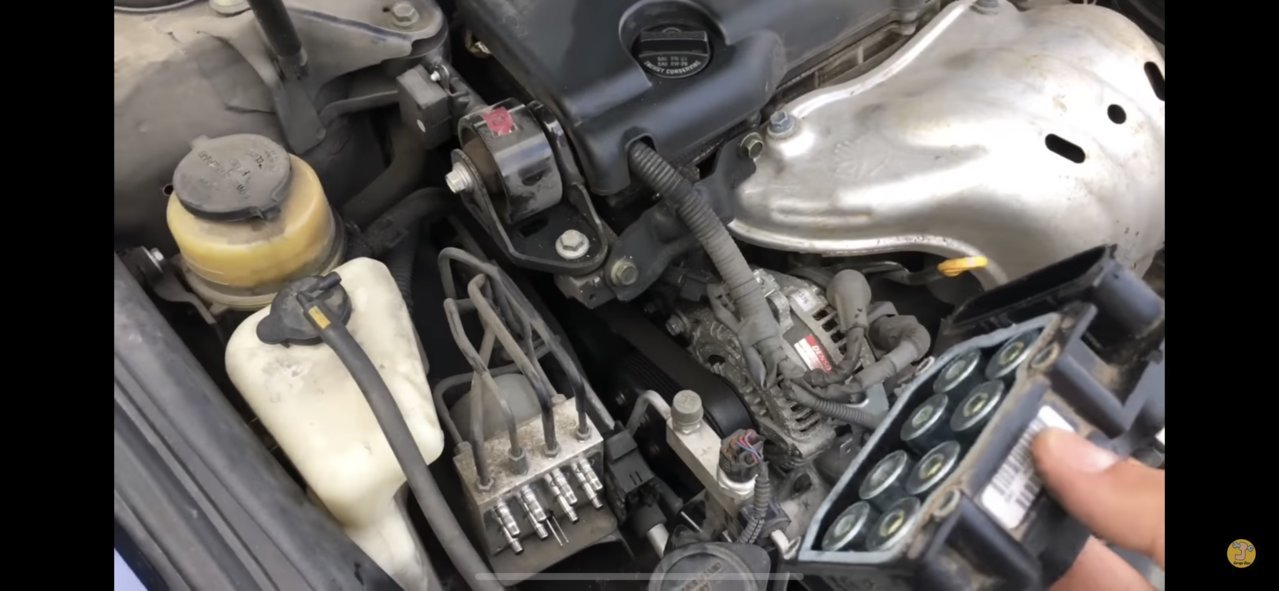

    I’m not having any luck with Dakota digital using the abs wheel speed sensors for an input.
    I’m still waiting for a response from them for next step if they think they can make it work.
    Their speedometer module is looking for an AC signal most times generated from the older style tone rings.
    Toyota uses an active 2 wire Hall effect sensor for their abs sensors. It has a 12v source without a direct ground. The ground/signal wire floats off a resistance in the abs module(I have not verified the value) but the skid ecu monitors a change in current for keeping track of the abs wheel speed(7-14ma differences). I’m leaning on their next answer is they cannot use the Toyota abs for input.
    I’m going to be sticking a sensor in my Tcase for VSS.
    I tossed the idea to @Airdog of keeping the smarts of the abs pump on the truck to keep moving forward with abs removal. Deleting the mechanical pump side, hydraulic side, but keeping the module tucked somewhere might be the best option for 2wd trucks looking to ditch abs when going to full float.
    Here is what the abs module off a Camry looks like. I’m assuming it’s similar on our trucks. If this was kept on the truck, sealed with a plate instead of the other half of the abs pump, it would keep wheel speed once you rewire the front sensor into the right rear input. I will test this once I get my T case VSS working. I would still think the abs light and stability control lights would come on though. At some point it must monitor the circuit for abs pump and realize it’s missing.
    welderf15, Camazon and Slashaar like this.
