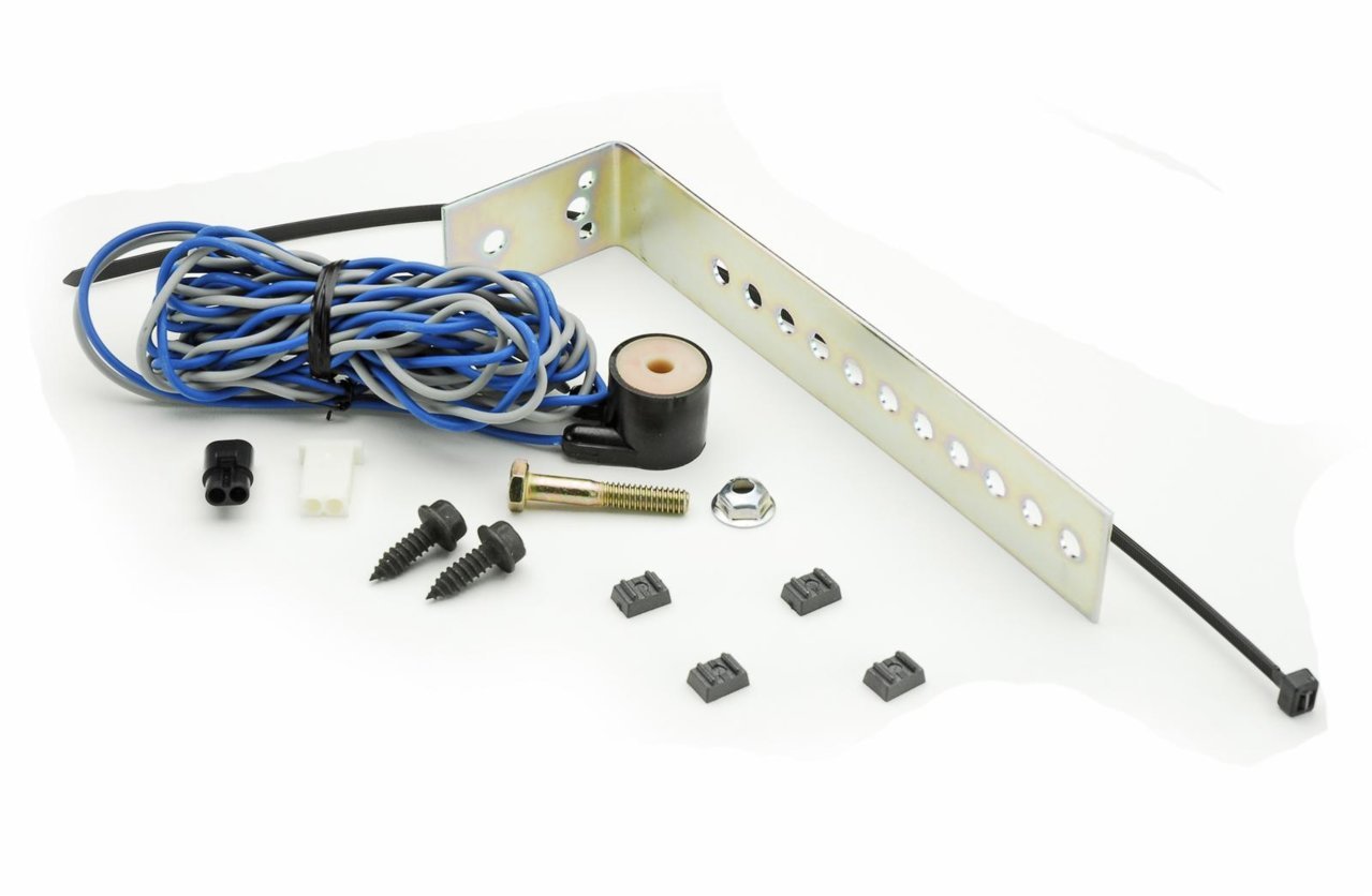

    Well abs sensors on our trucks is out for using them for speed sensor on full float and a complete abs delete and a Dakota digital speedometer module.
    They did however recommend using their magnetic pick up sending unit off the driveshaft.
    Slashaar and EatSleepTacos like this.

    Yeah. Unless someone wants the option for a complete abs removal from a 2wd truck.
    I still plan to stick my T case for my speed sensor and completely delete abs.

    Yeah, I’ve never quite understood why Toyota would use the abs sensors on autos and use a t case sensor on the manuals….

    Because the autos have all the fancy modes like atrac and that’s how they function. Really no other reason for it.

    You should just do a worm gear sensor off the back of the transfer case. You can use the search bar and learn that many have tried and failed at using tone rings for ABS on the Toyota Canbus system. You need to feed your ABS ECU information that it is traveling otherwise if you have an automatic transmission it will be very in happy in the long run and shifting will not be as crisp. The ECU itself pulls from the ABS system to set shift points as it is moving. If you have a 2012 + you will
    Not get the speedometer working. However you can feed the abs ECU with a worm gear speedo and it will display in an ultra gauge and tell the computer it’s moving and to shift normally again.
    Ultimately the move is just buy a semi float and don’t worry about these problems if you want to retain ABS and have an Automatic.
