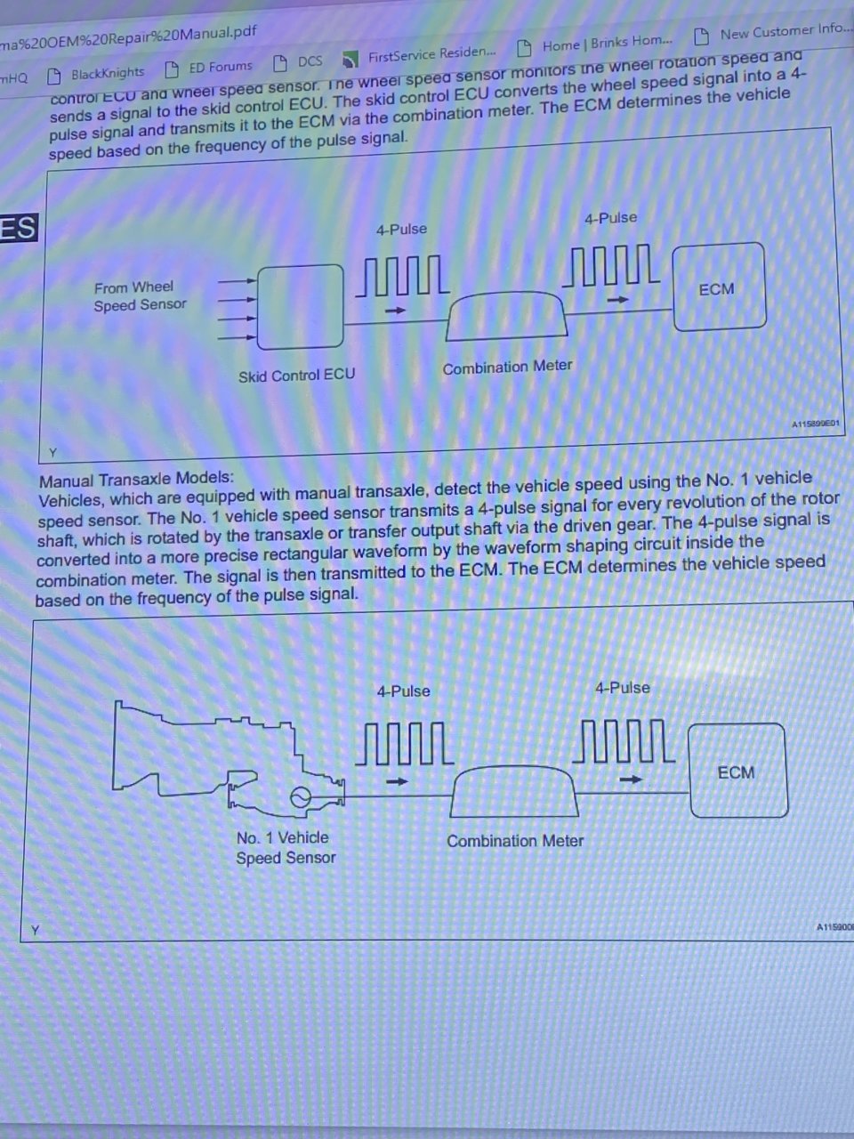

    I am 4x4 and had all the intention of just using t case sensor to feed my speedometer directly. You don’t need to feed it to the abs ecu. The FSM shows manual trucks feeding straight to the cluster.
    I have all intention of ripping the whole abs system(electronic and hydraulic) out of my truck and being 4x4, it’s much much easier. I’ve been going down the rabbit hole of testing because I wanted to know if there was a way to completely remove one from a 2wd truck. @Airdog found his solution, that we know. Live with the abs unit still on the truck, remove some lights from the dash. Done.
    I’m just toying around with my curiosity to take a 2wd solution farther than redirecting a sensor and having the abs module live there just to condition a tone ring signal.

    I have not looked or verified if there was a point in the wire harness closer to the t case. I do know however you can bring it straight to the the speedometer.
    https://www.tacomaworld.com/threads/upgrade-to-full-float-rearend-limp-mode.588516/#post-25289239

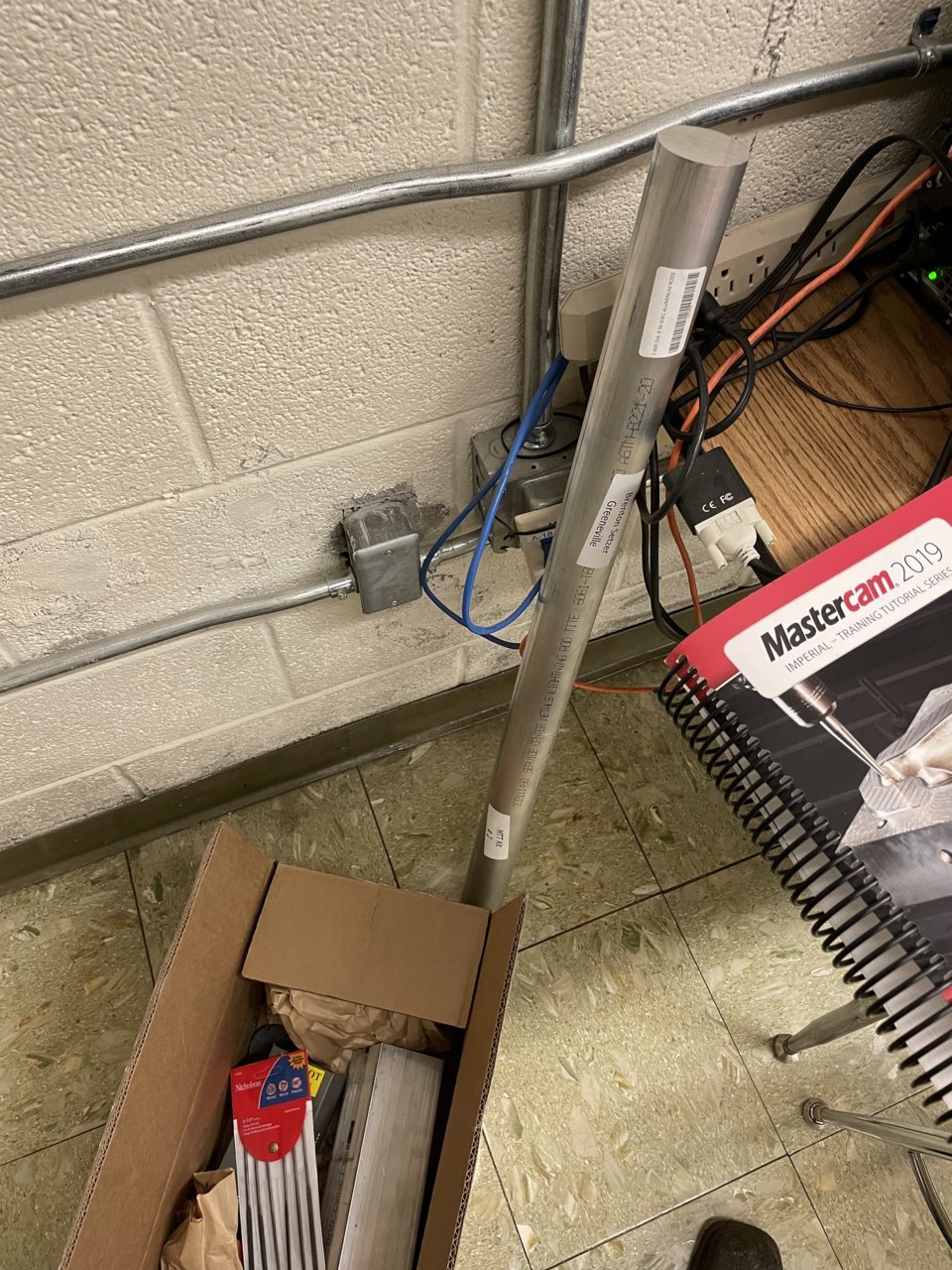

    Any way I could get the length and small od of the billet tie rods you sell with the steering kit for 2.25” lt @81Trekker?CBDFC7B5-85B5-4958-BACE-466B6B6173FD.jpg

    Learning MasterCAM?
