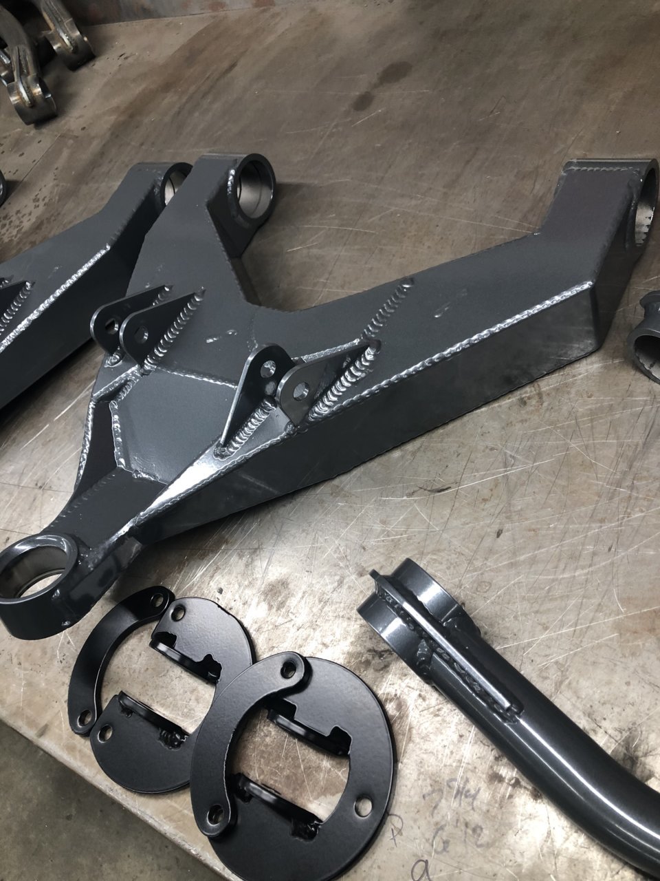

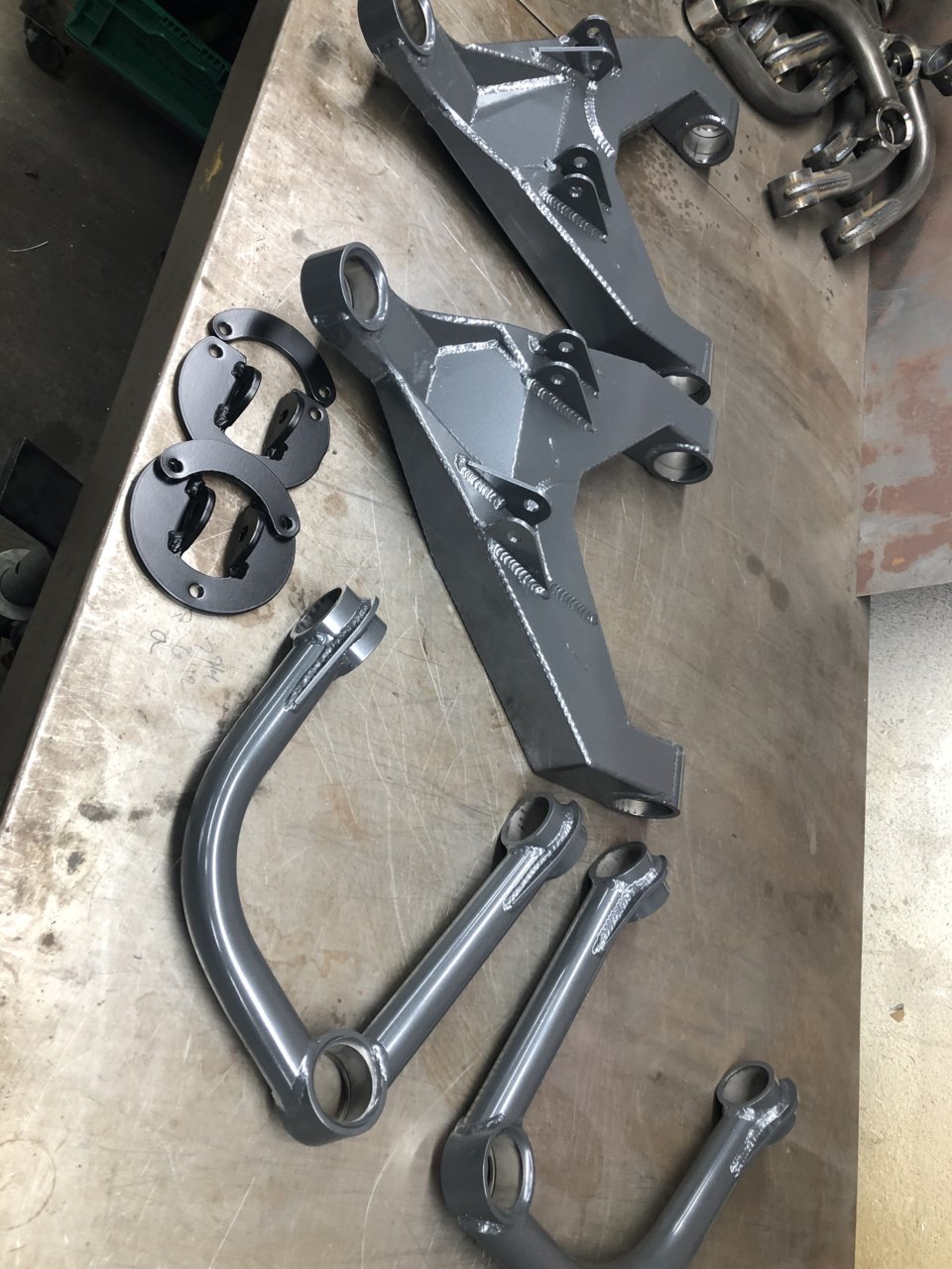

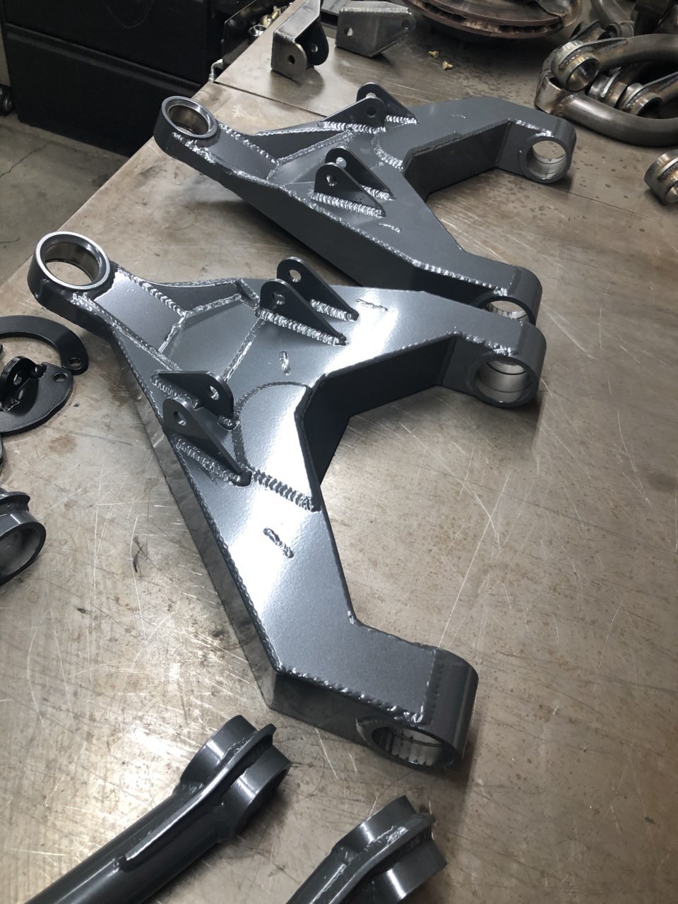

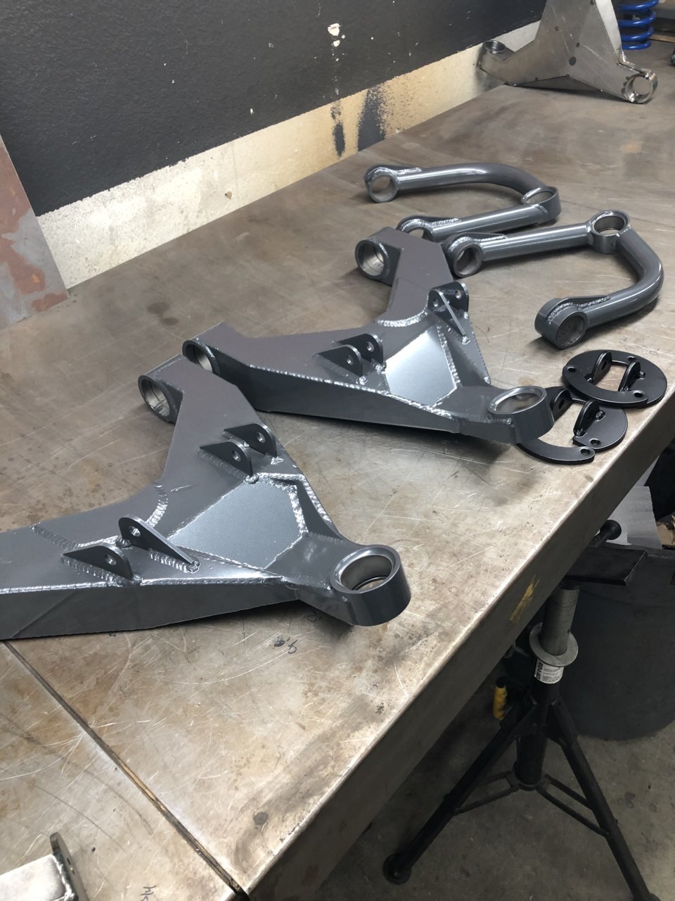

    Back from powder coat
    CMScheid, Hawk373, Jpiskura and 6 others like this.
