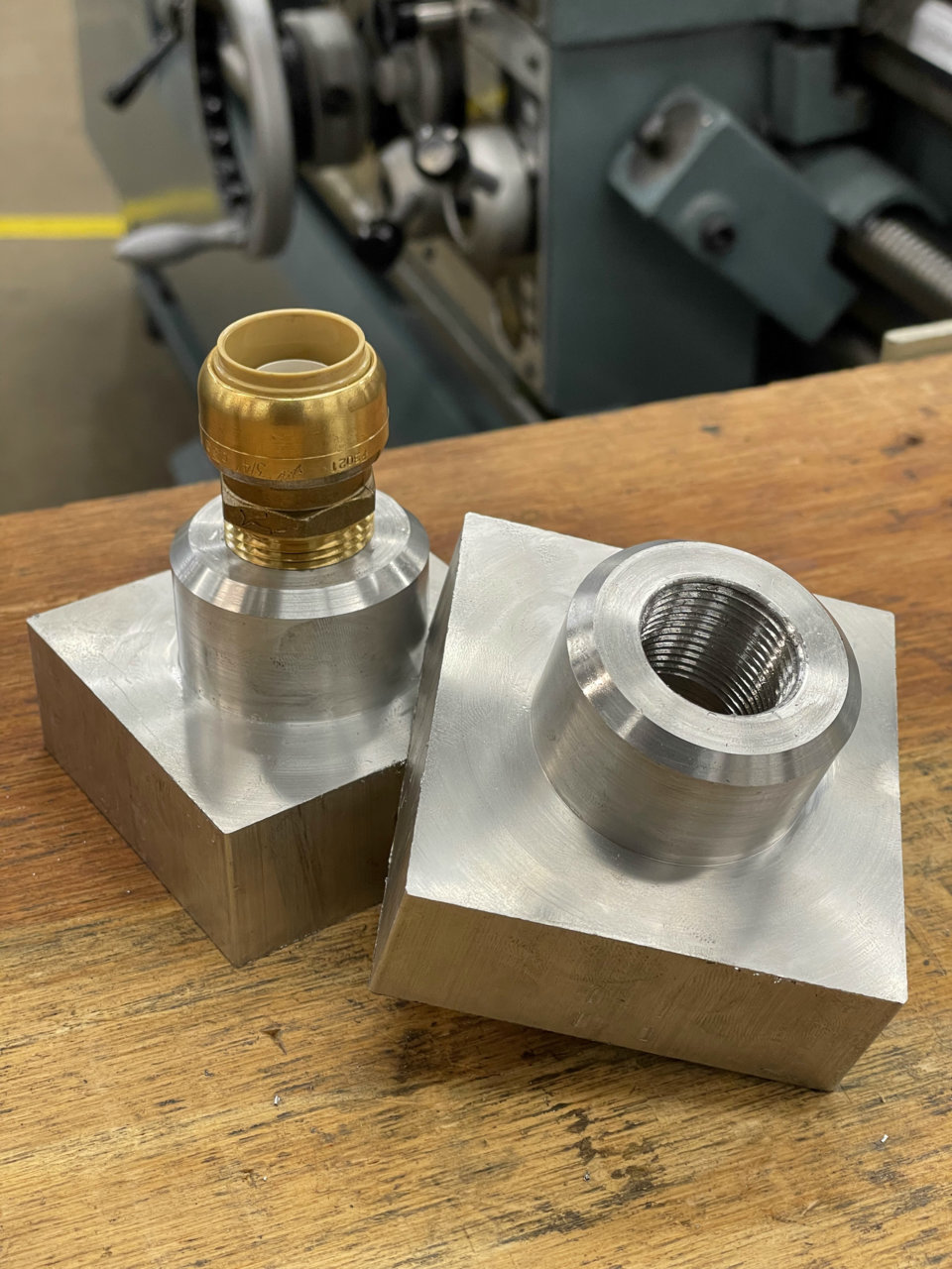

    Yeah I'm halfway through my machinist certification. I honestly hate master cam cause I'm use to having a histogram in fusion 360 for when I use my plasma table at home. These were my last two projects.

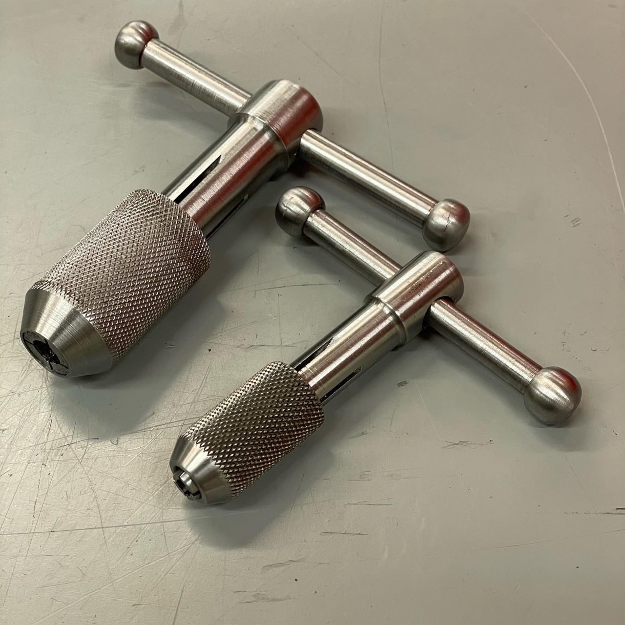

    You got to make some pretty cool stuff all I got to make was a clamp and a bunch of competency samples for the different operations. Once I was done though I did get to make a set of forward controls for my old motorcycle that was fun and a neat project while I was learning.

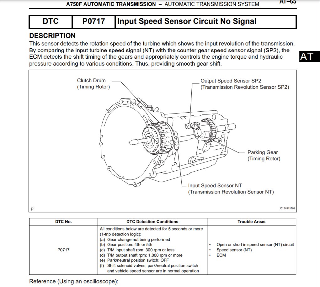

    Looks like they’re there alright. I was hoping for unused sensors. They’re inputs to the ecm.
    Still could be useful. I’m looking into piggybacking the signal without causing issues to the ecm. Issue with that is with using diodes, it will clip the ac sine wave. I’m not sure if that played nice with the Dakota input or not.

    The ol' tap handle, a staple in machining education.

    Tonight I tried the No.2 speed sensor. I left it plugged into to the ecm from the transmission. Paralleled the signal to Dakota digital, took many attempts and the set up but I was able to drive the truck. Abs module completely disconnected, I had speed only at the ultra gauge, no speedometer. I was not getting any check engine p0500 codes, cruise control worked and I was about a mile off gps speed.
    I have thoughts of maybe the signal ground being a different location than the speedometer or even still set up on on the Dakota digital programming for my output is wrong. I will try more into this tomorrow.

    Thats the output speed sensor for the trans. I wouldn't start playing around with it because that's how the ECM/TCM knows what's up with the trans. It would also be highly inaccurate in 4 Low. Which isn't a big deal, but yeah.

    That’s true. But I’m more along the lines of testing for 2wd guys. Im going to use a Tcase vss signal for my truck.

    Unless someone is willing to do a full stand alone system, the only way I can see it possible is to use a reluctor wheel on the drive shaft. I'm digging through diagrams now and the sensors on the trans cant be messed with, nor used for the speedometer as they are monitoring shaft speeds. A reluctor wheel on the driveshaft isn't uncommon, nor is it hard to do. Down fall is, it would have to be located at the pinion as its the only fixed position spot on a 2wd shaft.

    The transmission sensors are variable reluctance sensors. Sharing the ac signal with a parallel configuration did not interfere with my shifting at all. Mind you I’m still sending the signal through a Dakota digital box. I just didn’t have time last night to see if I was sending the right output to the speedo.
    I wouldn’t bother chasing the use with custom machined parts to make this work. Just keep the abs module on board to supply a vss. You just have to send one of the front signals to the right rear input. Also must make sure the abs is physically not part of the system with the sensor redirected from the front. You’ll have to live with the dash lights or remove them.
    I’m not looking to retain abs at all. Just trying to figure a way to completely delete it for the 2wd trucks with the vacuum booster set up.

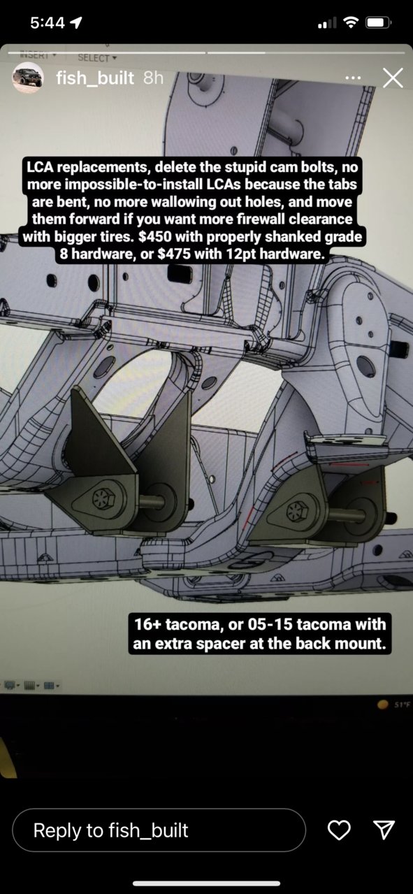

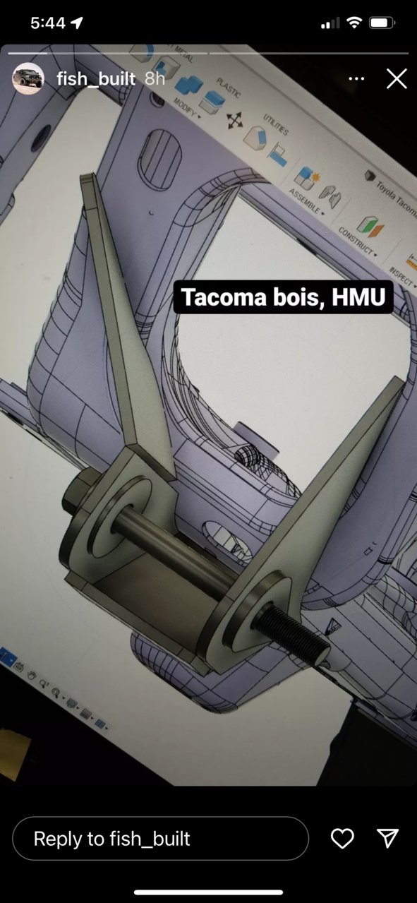

    61055105-5657-4CA4-A2D5-2227221293EE.jpg CD515A12-1D31-4896-B9A2-2F6359B92C65.jpg
    Can’t wait till the first garage mechanic does this. Nothing to help you align the LCA tabs. Can’t imagine the time it will take to get them straight in height and width. That is just going to be a nightmare install.
    It’s stuff like this that makes you see the genius in what Harry did with their setup.

    That was the first thought that came to mind. No way to locate or align what you’re welding onto the truck. At that point just weld on a marlin crawler reinforcement and one of the “cam tab delete” options on the market and call it a day. Basically the same thing they’re offering for half the price.

    Pretty sure you can just weld these wherever you want. Much better design

    You can, and a good fabricator could even figure out how to put them in the OEM "correct" spot too. But watching the harbor freight welder crew burn these into fucked up spots, then bitching about alignment, should provide a summer's worth of entertainment.
