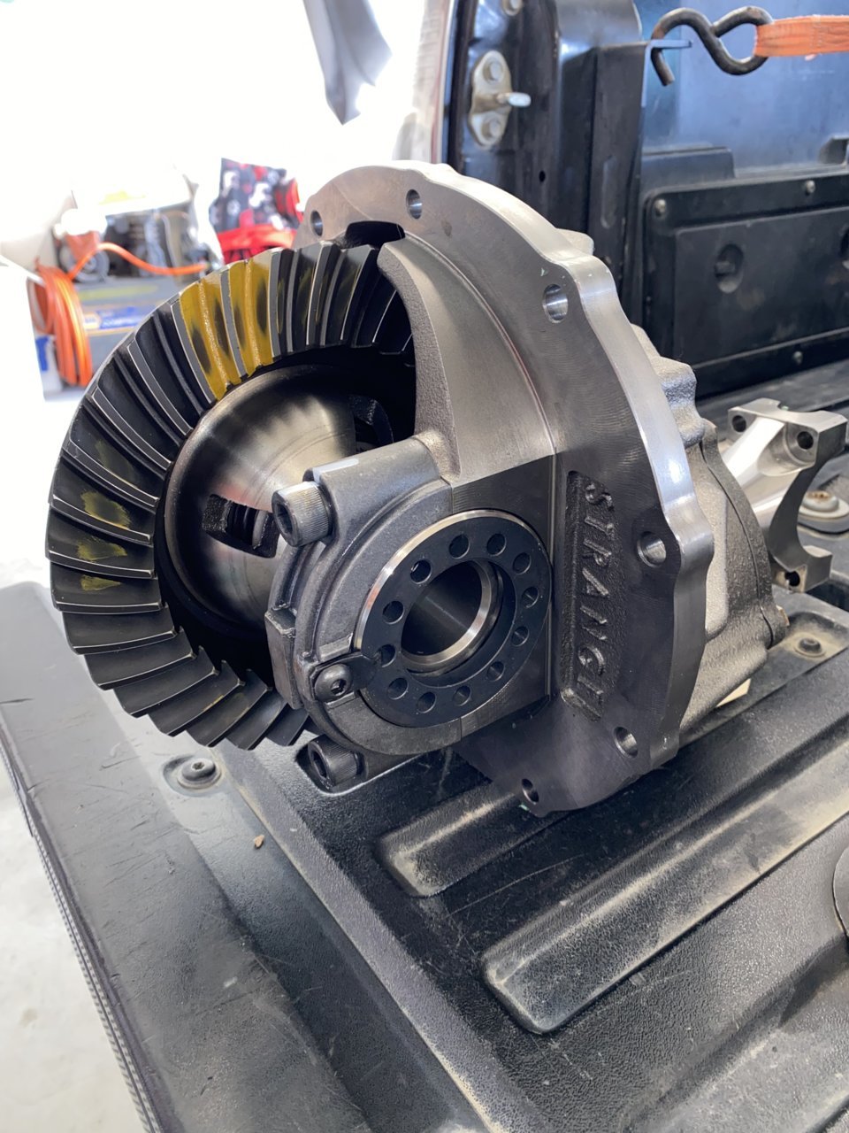

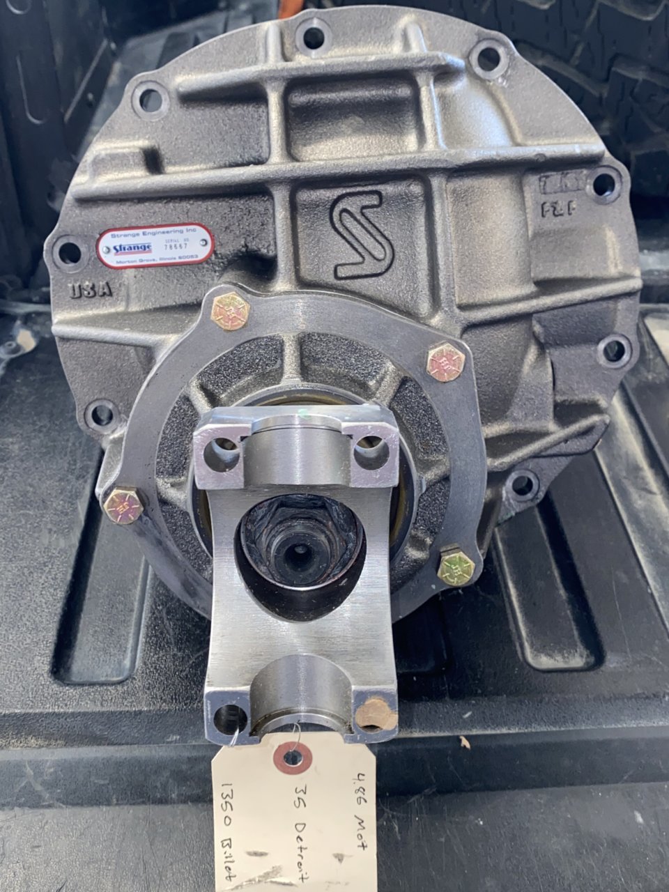

    This bad boy showed up today. Took about 7 weeks from Quick Performance from ordering it to my door.

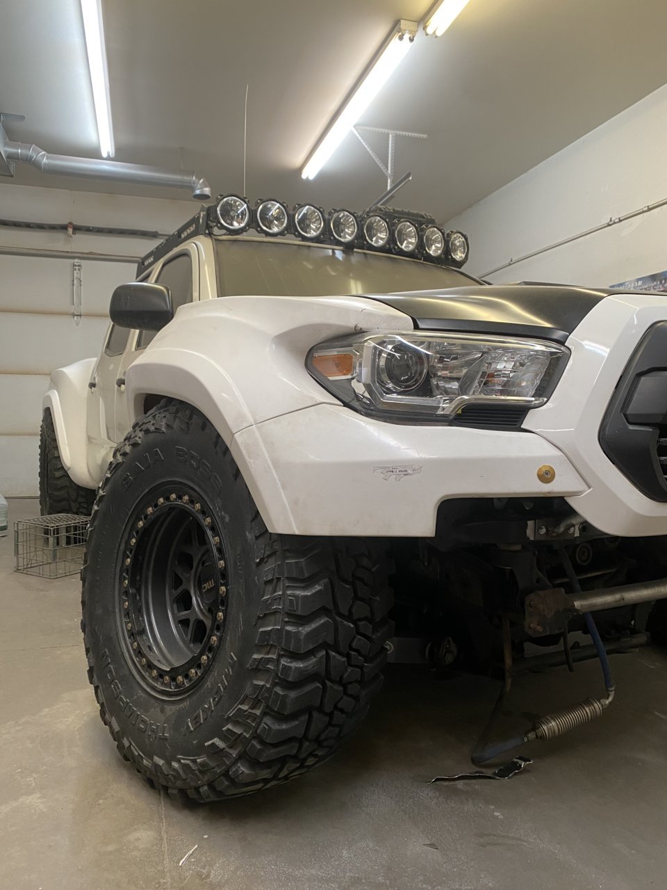

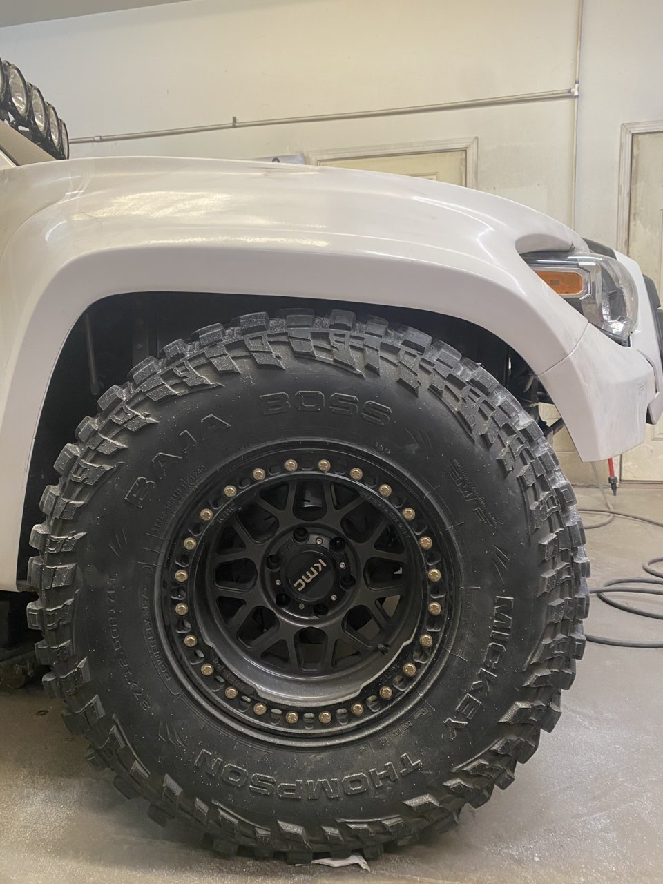

    Got the front end clearanced now lock to lock at all points of travel. There was some trimming on the inners for the 37’s but it wasn’t much at all. With the .875 from the arms and one spacer to the rear for a total of 1.375” forward seems about perfect. But the +4 arms and my -38 wheels definitely helped the situation. If you’re not wide enough I wouldn’t suggest 37’s with the inners as you would be hacking a substantial amount out of them.

    You should trim another inch out of the top edge of your fenders to account for frame and coil bucket flex on a hard impact. Look at what happend to @kasnerd his frame flexed 3/4" past full bump when he had a hard hit.

    At full bump the tire is inside of the fender. Fender would have to move 2+ inches to make contact with the tire.

    Cool, from that side view it really looked like the tire is below the lip of the fender

    Yeah it does for sure. But this is how it actually is. And this was before cutting.
