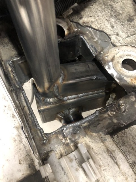

    I just ran extensions off the frame out on 3x3x3/16 boxed in tubing and then gusseted even more in the frame and connected the boxes with more tube. About the strongest way I could think of to keep the tubes all the way out without doing 90 degree bends at the bottom.

    Did both the a and b pillar like this and then the c pillar cross bars intersect to where the tube lands on its box. The 3x3 boxes are landed on doublers that I welded to the frame as well.

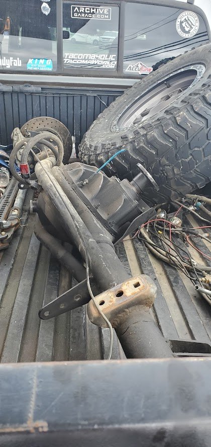

    So speaking of ford 9s I scored this today for a very reasonable price. It's ready to get swapped in. Bonus is it's right at ~68-69 WMS-WMS and everything is set for a direct swap into a yota. Came with a line lock set up to bolt to the ebrake pedal and everything. The kid I got it from just had a shop redo his SAS build with 2 currie 9s. He isn't running any WSS in it at all. He said the shop tuned the ABS off with HP tuners and the Spedo still works. Sadly he isn't very savvy to understand everything so I have the name of the shop and maybe they can give me more info. The 9 I bought from him has custom machined bearing blocks and WSS rings on the axles it's not a FF though which isn't a complete deal breaker. ARB 35 spline with 5.29 gears, disc brakes, chromoly axles, big bearing. It's a decent set up not sure what center section it has I have to look it up he sent me the full build sheet.

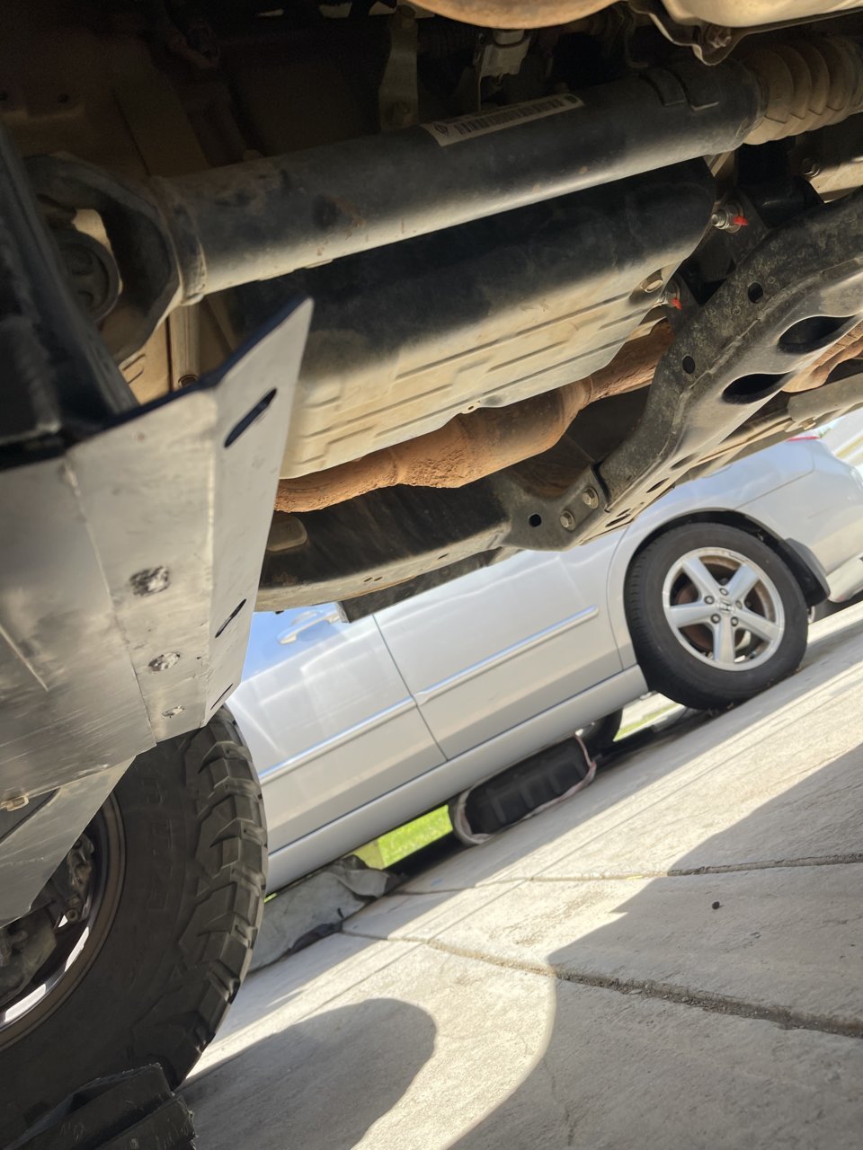

    I had the shop weld a lip so I could use my BAMF skids

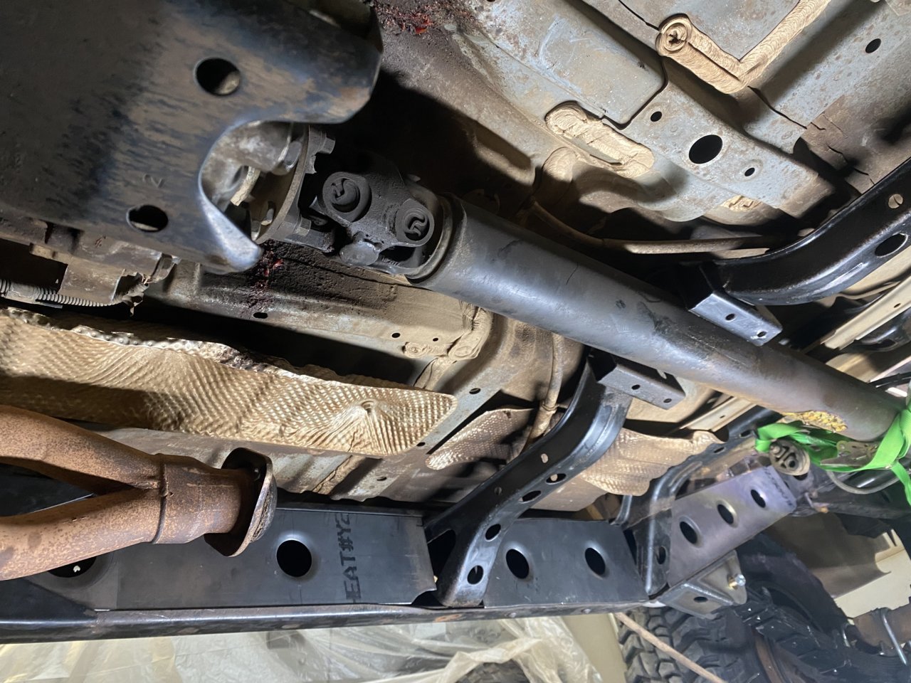

    What’s the best way to access the bolts for the skid plate? I had pane one else weld up the pivot kit and seems to be a pain to access the nuts to remove the skid plate. Maybe I’m missing something but having a hard time getting to the nuts.
    has anyone welded the nuts so it’s easy to remove?

    Are you talking about removing the skid that comes with the LCA kit? If so it uses captive clip nuts so you don’t have to hold the nuts for removal

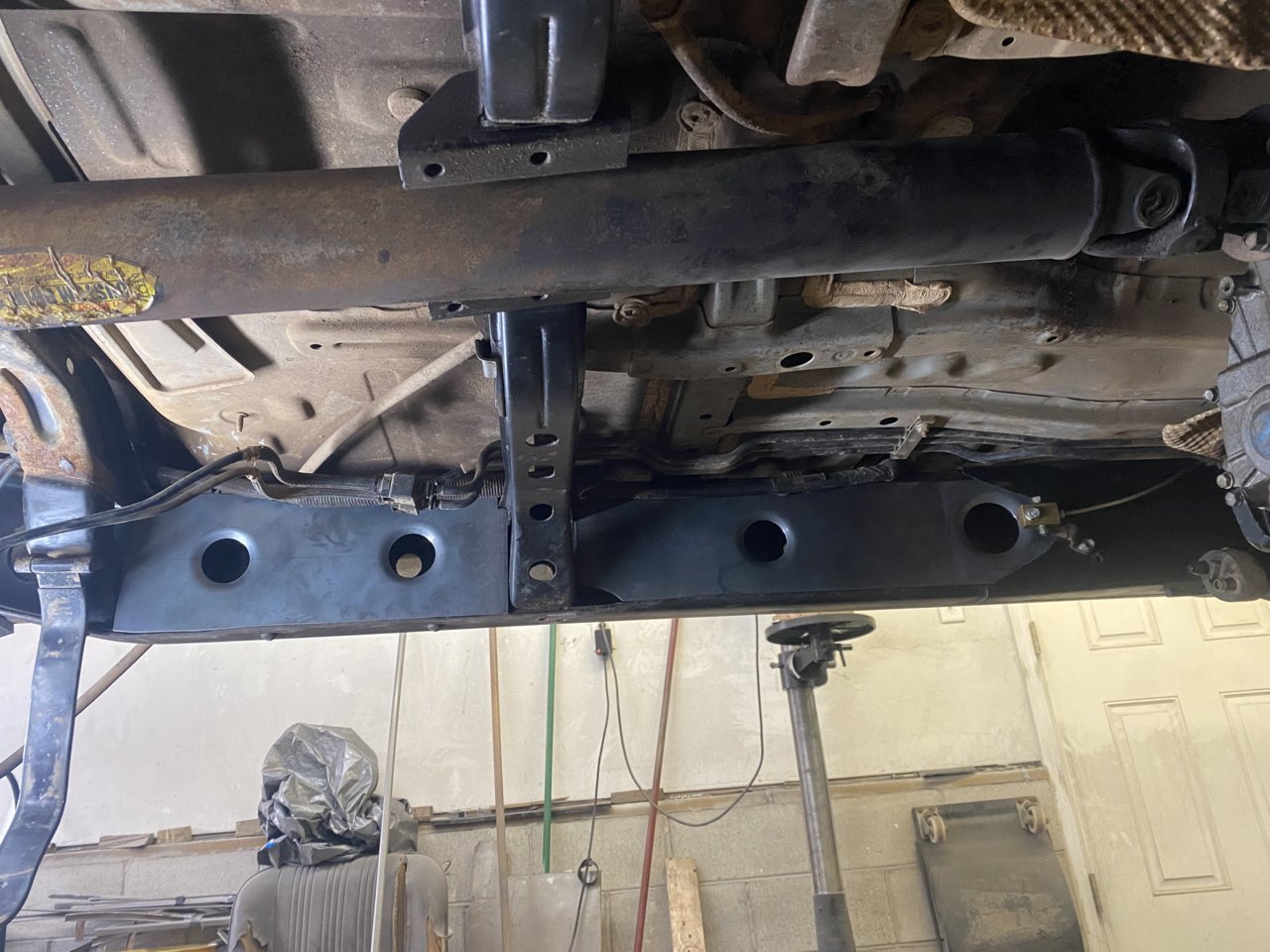

    Spent the day making the rest of my frame plates. Once these are burned in it’s on to bumpers and paint. Praying for some shocks by the end of the month….

    Very nice. How are you drawing & cutting the plates out? Cut a second pair and I’ll buy them from you. Lol
    How long have you been waiting for shocks now?

    I am doing all of it by hand. Making templates and plasma cutting it all out.
    I did save all of the templates, I’m doing another Tacoma over the summer. Going to see how the templates fit on that one. Not really sure how different one frame can be from the next.
    It will be 9 months at the end of this month for shocks.

    Hmm I’ll have to try again they were spinning and we’re not loosening.
