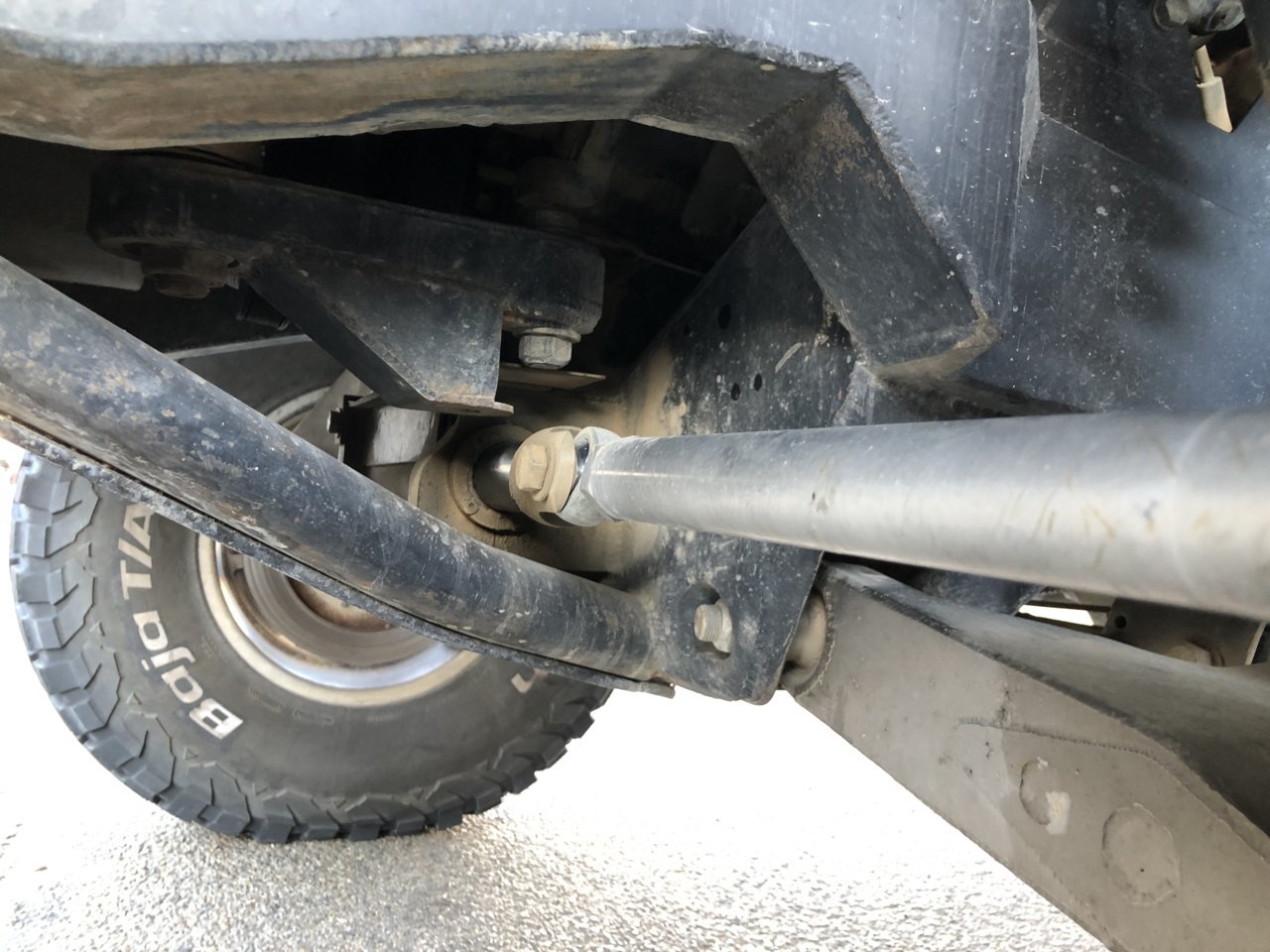

    Still wouldn’t turn at like 2k rpm. I don’t think it’s the pump not providing enough pressure, but the rack not outputting enough power

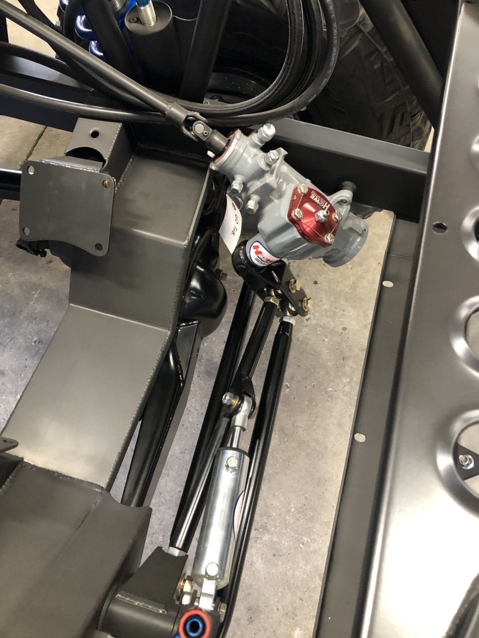

    Correct it has nothing to do with the pump, you need a hydraulic ram to physically push the steering around.
    Call me at the shop and I can get a new clevis and bolt out to you this am

    The best bet for a Tacoma is to build a huge slide rack driven by a box and ram like jesses Chevy. The issue with a swing set is the AC compressor is in the way

    You build a slide rack worthy and ready for hydro assist and I'm a buyer.

    I need to build one on a truck first ... cough, cough @zcweisman

    Just be prepared to spend $4k on all the parts you need from Howe in addition to everything else along with a lot of fab work

    What box are you thinking of using

    3 or 4 bolt saginaw

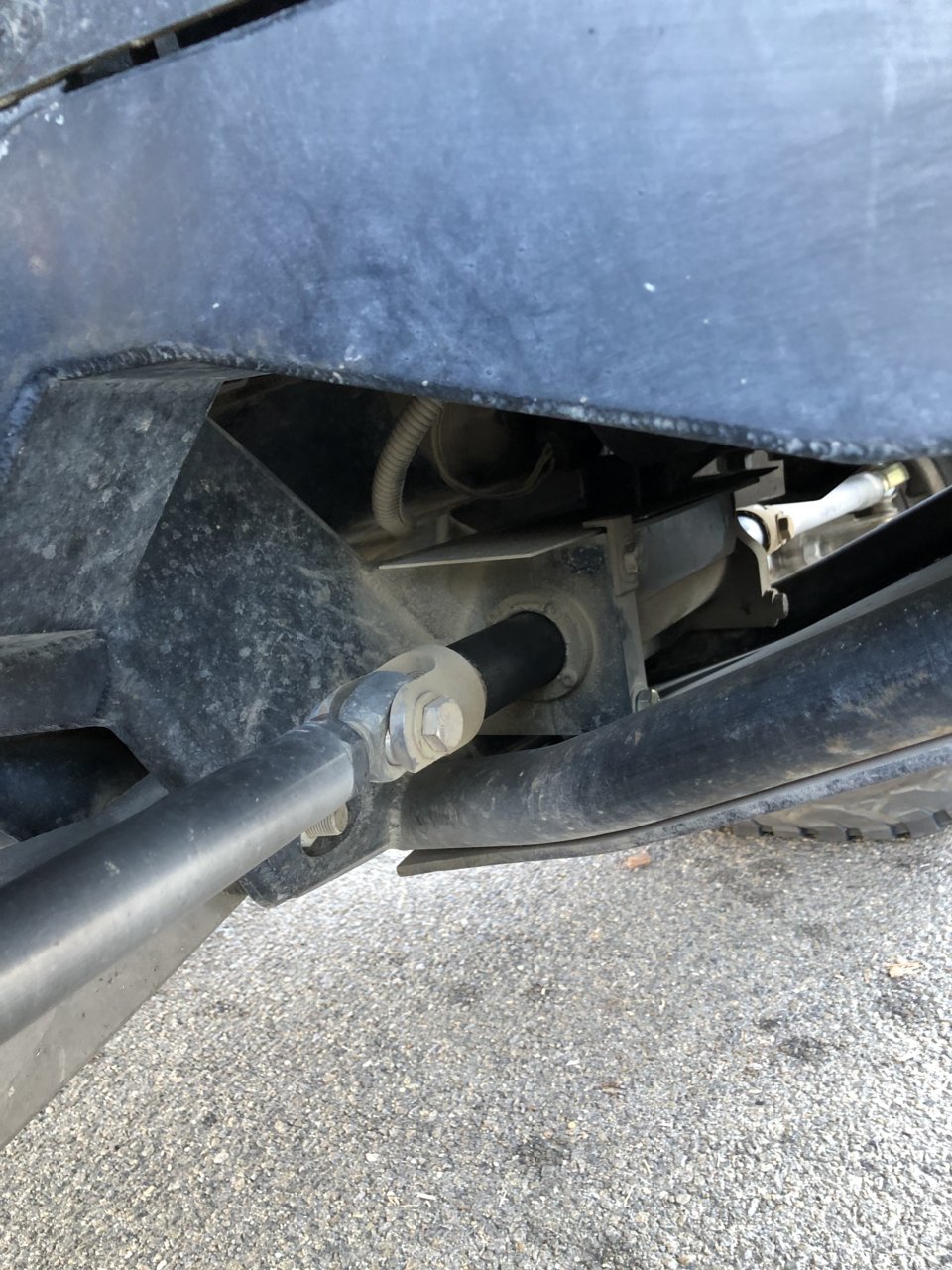

    Just got off the phone with Harry. And man do I love the customer service over here for one.
    But yeah sounds like a fun and not cheap project haha. Maybe next summer for me. For now gonna get a new clevis and keep the knowledge of its gonna be hard to turn in the rocks. Good thing the jeeps and 4800 car broke this weekend too so there won’t be big trips for a little bit
