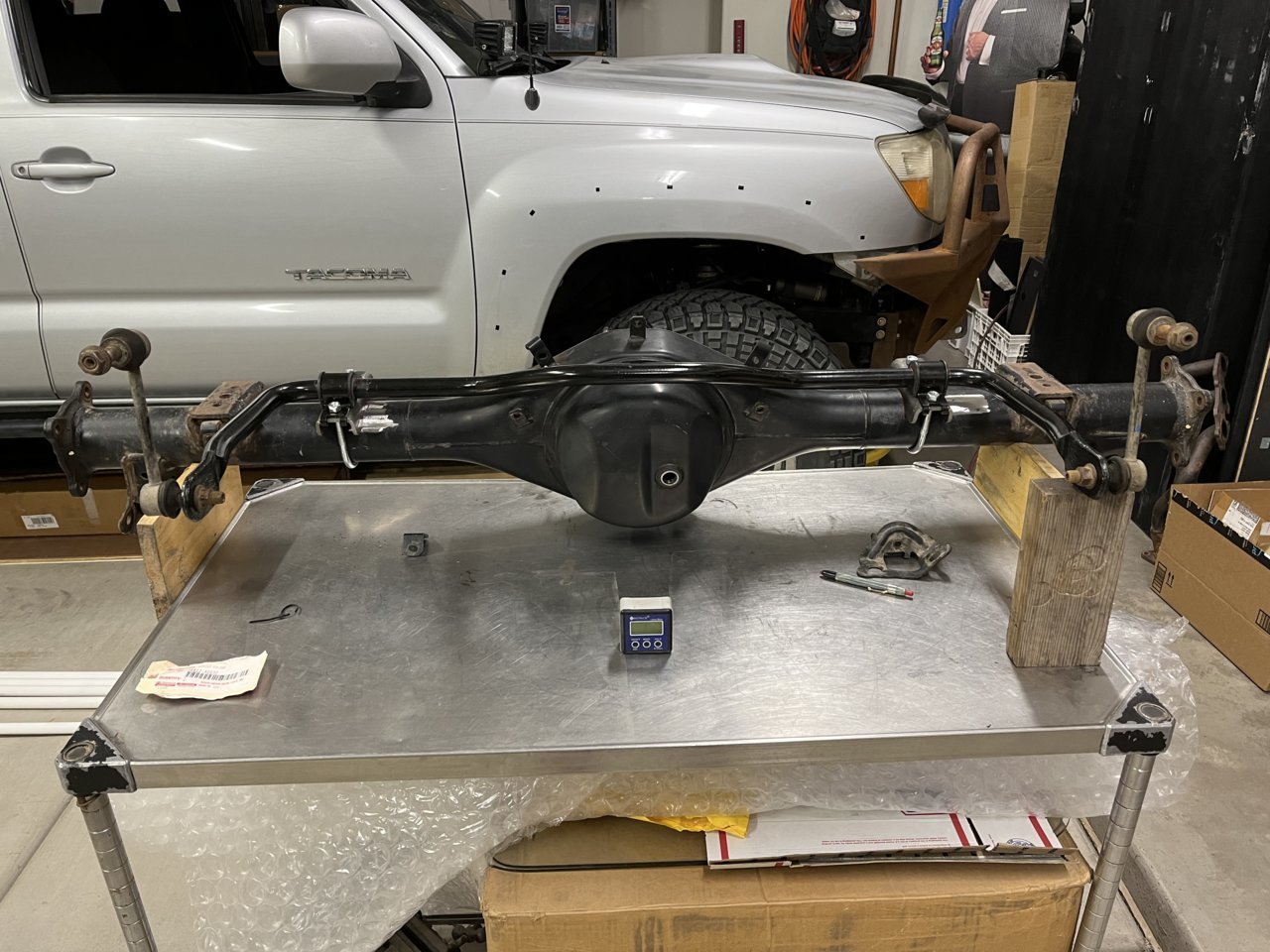

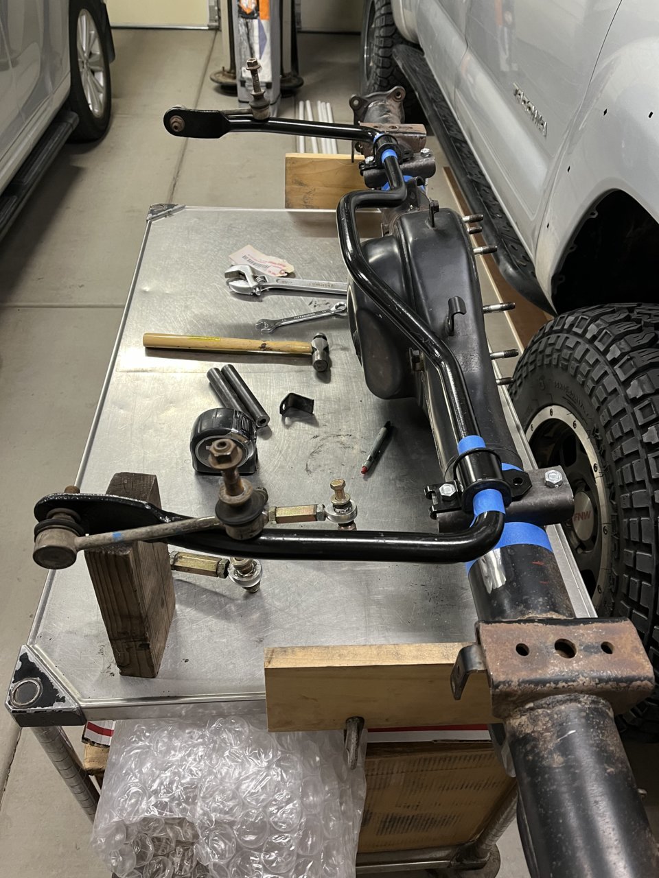

    I am interested in adding a rear sway bar to my setup. Have started on the project already, but not sure how long it will take to complete since it is coupled with other changes at the same time. But I'm putting a TRD sway bar on the top of the axle. Didn't want it on the under side acting like a tail hook or reducing ground clearance. It will involve moving some brake line brackets and re-forming the lines to clear. Can't decide if I'm going to leave on the diff skid (it is very scraped up from my past trips and inexperienced driving) or save the weight - keeping it complicates the brake line brackets and overall install, removing is more clearance and less weight... I have several options for links, and I think disconnecting one side at the link and tying it out of the way will be easy and it will still clear everything when articulating - If I even want to disconnect. Some feedback I've heard from other folks with other truck platforms... once the rear sway bar is on, assuming front bar exists also, why bother taking it off, truck works just as good offroad, if not better in those off camber situations, and WAY better on road, even on dirt road...
    I don't do the hard core 'wheeling' that I see discussed in this thread, but the truck sees its fair share of 4low, scraping the skids and adventuring. It is a very heavy expedition (don't like using the 'O' word) setup for the family of 4, and much of the weight is way higher than the original center of gravity so I do feel the truck is more tippy than I'd like. Hoping the rear sway bar helps with the handling on the road, as well as offroad. I've never had an issue with not enough articulation yet, so thinking that a small reduction in that articulation would be worth the trade off. Have air lockers front and rear for situations of reduced traction and articulation.
    Will be adding the smaller diameter trd offroad front sway bar to the truck at the same time. My truck is trd sport so it originally came with larger front bar (which has been off for years). Can play with that later if I want, easy enough to change it out. I sure wish there was a different style front bar setup that was available, something that went off the main crossmember at the LCA front pivot or something, and connected to the LCA instead of the spindle... but I'd guess that is way more complicated to make it work correctly and nearly zero market. Maybe someday there will be an available 2 piece front bar setup, where you remove the trailing portion of the bar and the link on one side to disconnect so the unconnected side is gone and doesn't foul with the CV boot.
    Brackets will be welded to axle, clamps for mockup. I may have to put a small spacer between the welded mount and the bushing clamp to space it out and up more, depending on clearance and brake lines and such. Waiting for a parts order so I don't have to take my truck apart to get the brake lines figured out.
    Speaking of parts - anyone have the bracket that the rear flex lines go through when connecting to the hard lines on the axle? I want one to cut-up for my brake line re-do, maybe someone who has put in a different axle in this thread has one sitting around. It bolts to the axle and holds the lower side of the brake flex lines.

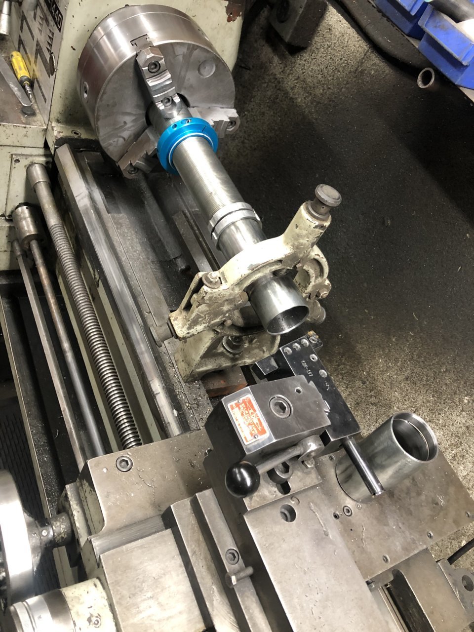

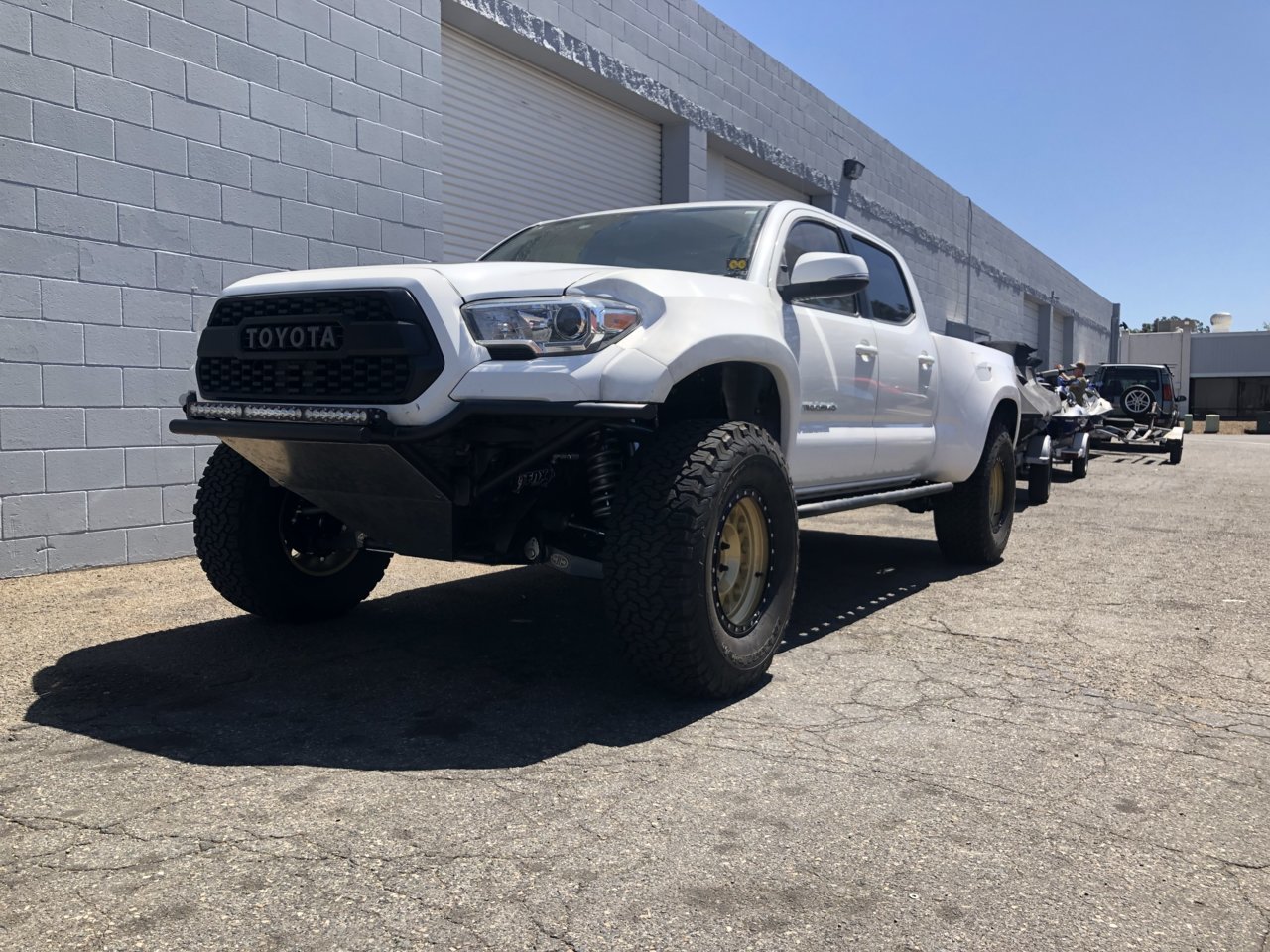

    Desperate times call for desperate measures... when you don’t want to wait 10 months for new shocks you modify existing ones to work :)
    Cutting 18” shocks down to 14”
  18. Apr 22, 2022 at 3:40 PM
