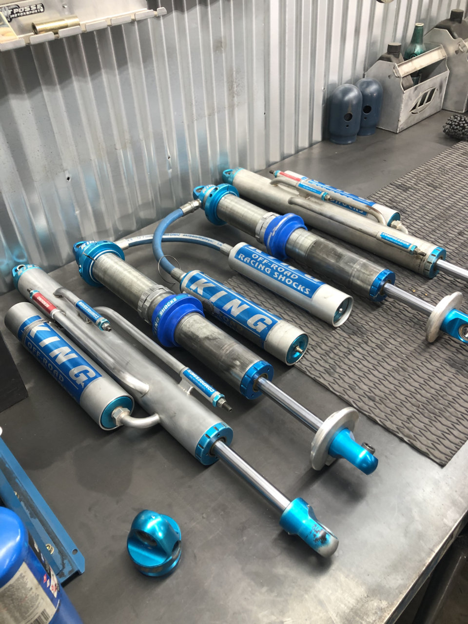

    Yes... now I can pull them all apart for ano and magic coatings. Oh and yes I welded welded the check valves closed because I hate bypass shocks

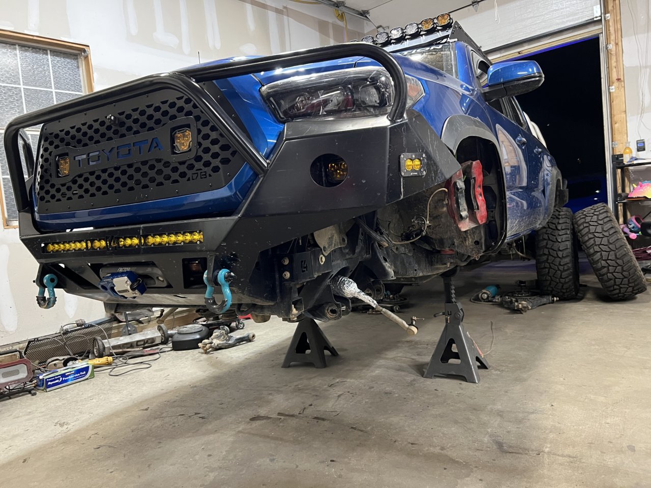

    Well shit… haha I need to get all of my other stuff from you installed before I get this haha… I started on the lower pivots tonight. If you were wondering, yes the aluminum foil was a bad idea haha or pictures tomorrow.

    Is that what you do to make them free bleeds?
    What in the fawk is that contraption. 3 resis, like 6 bypasses. My goodness that thing is insane.

    Why was the foil a bad idea? A lot of places, including the old California plant that made some of these Tacoma frames used foil to protect the frame jigs from slag build up.

    When I did the first subframe kit I used foil and it caught on fire and melted the tie rod boots. Granted that was when I was plasma cutting the old tabs off. The last one I did I cut the sleeves off some old welding gloves and slid them over the tie rod and cb boots and it seemed to work well. I also didn’t plasma the second one

    There was a couple times where my foil burned through just using cut off and grinding wheels. Even using that HD stuff lol.

    I just took off the tie rods and cv’s for the extra room. Wasn’t too much extra work and made it a lot easier to cut the tabs off. At least with a grinder I needed the extra room.

    I just set a piece of angle iron over the boots and used a cutting torch. No problems that I have noticed. Done just like a proper hillbilly. I did get fancy when I did the inner fenders and use a cut off wheel.

    The reason it was a bad idea because it caught on fire like others stated. I just used some C channel I had laying around. It is going well though.
