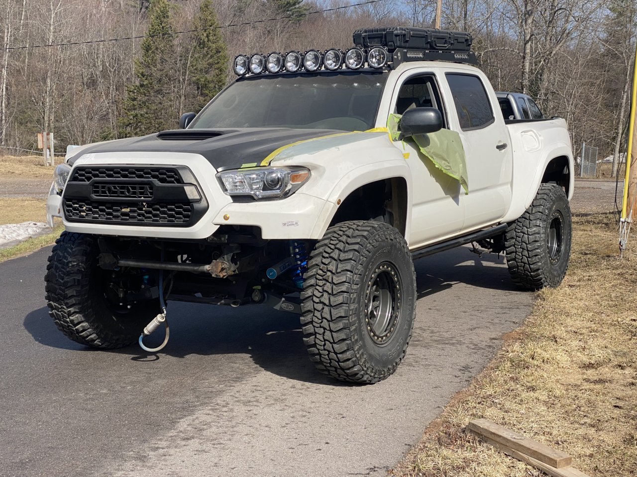

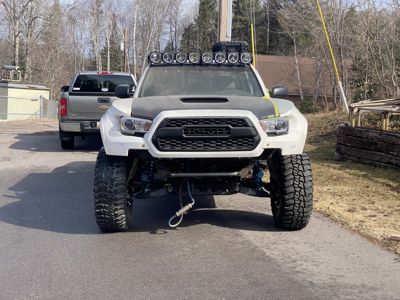

    @snowsk8air2 doing Jeep things.
    Needs an alignment, and see if we can get it to settle some more. 18x600# springs. Upper uni almost vertical slightly extended. Maybe hitting dirt next weekend. . .

    Is it just the pic or is the front end sitting that high? Maybe my front end is just low, I have no point of reference. I’m just comparing the angle of the LCA’s.

    No, its sitting high. But the uniballs are just past vertical. So, once the spring settles and I actually put some gas in it. Its on super empty. Should come down. yes, it sits way higher than Snowsk8air's truck.

    Might have to follow your foot steps and drop to 550. But we'll see how it does. Need to get it out, run it. See what needs to be tuned, Etc.

    Couple of notes from my truck so far; again.
    The ADS coil overs so far, built much much better than the Radflo for this LT kit. They aren't the limiting factor on droop and they aren't the limiting factor on bump.
    Bump can fully compress the DuroBumps and have plenty of space left on the shock.
    Droop, the limiting factor on droop is upper ball bind and UCA to spring contact. Even though the straps are at the highest point on the frame and the offset is set to the highest. I am ordering some shorter straps. We still have contact. So ordered up some short ones and we'll go from there.
    As far as the ride height. It looks high. Aint gonna lie. But needs and alignment. Plus if the springs settle just a little. Then the upper uni balls will be vertical. Right now, just a lil past vertical. This is with 0 spring pre load on the 18" 600# springs. Vs with the Radflo 16" 650# we actually had to put in preload? Idk, I'm not experienced enough to under stand that.
    All in all, much better than a few months ago.

    Its sitting a little high but let’s see how things are after alignment and a test drive. Getting close though.

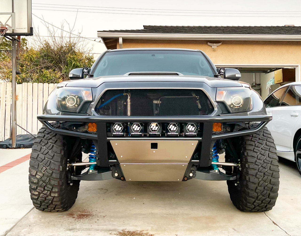

    I wonder if lots of it is in the alignment or something. I don’t have a bumper on mine and it sits lower. I’m also on 18x600’s.

    Mine sits low. Edit, added a picture with the preload on the springs too. I think these are 650lbs?
