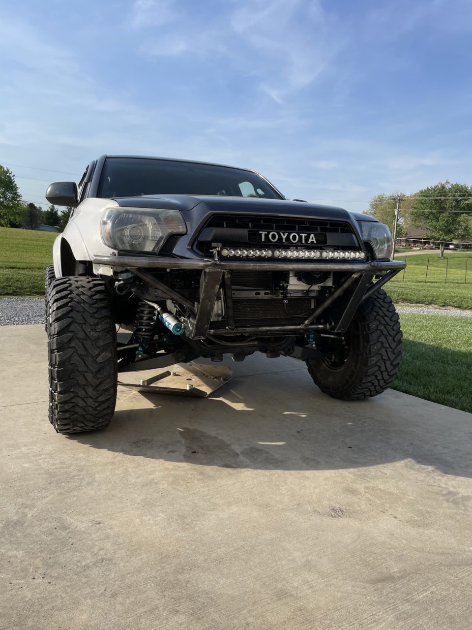

    I’ll have to measure coilovers when I get home but I think my bypass sits right over 4” extended.

    The truck does look to sit high. An alignment MIGHT help and the springs may settle a bit but I don't think it'll be quite as much as you need.
    Assuming it's a 7.5" shock, you'll want to sit at about 50-60% in the travel making 4.5" (7.5*60%) or 3.75 (7.5*50%) of shaft at ride height. Where are you getting your preload measurement from? The numbers don't align with what everyone else has done.

    There is 0 pre load. The collar is as high as it goes. Just enough to hold pressure on it.

    Either way. I’ll be fine with it at about 5” which is 62%.

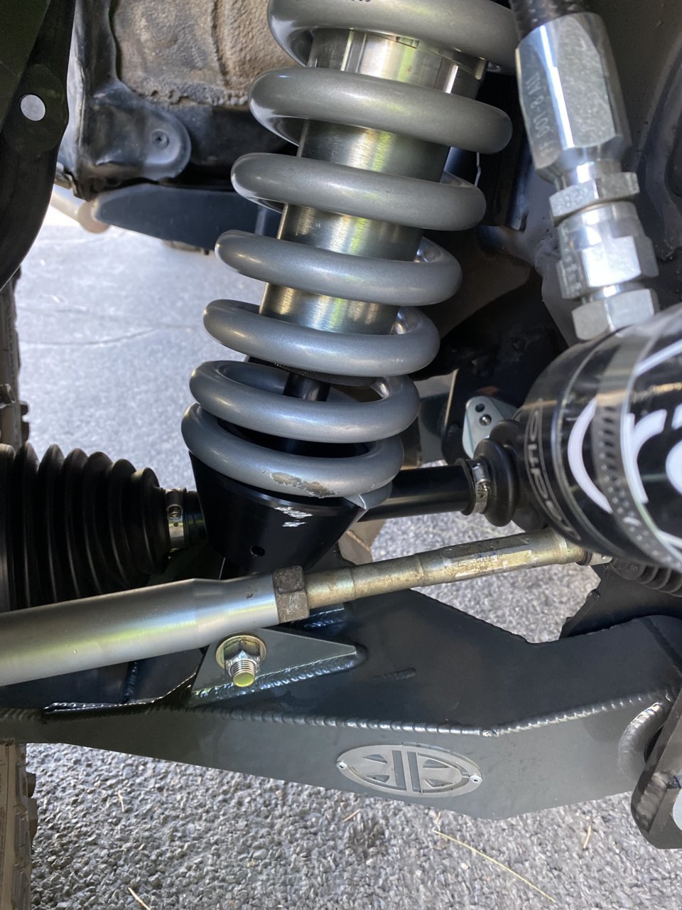

    Looks like you have a little different rod end on your coilover?
