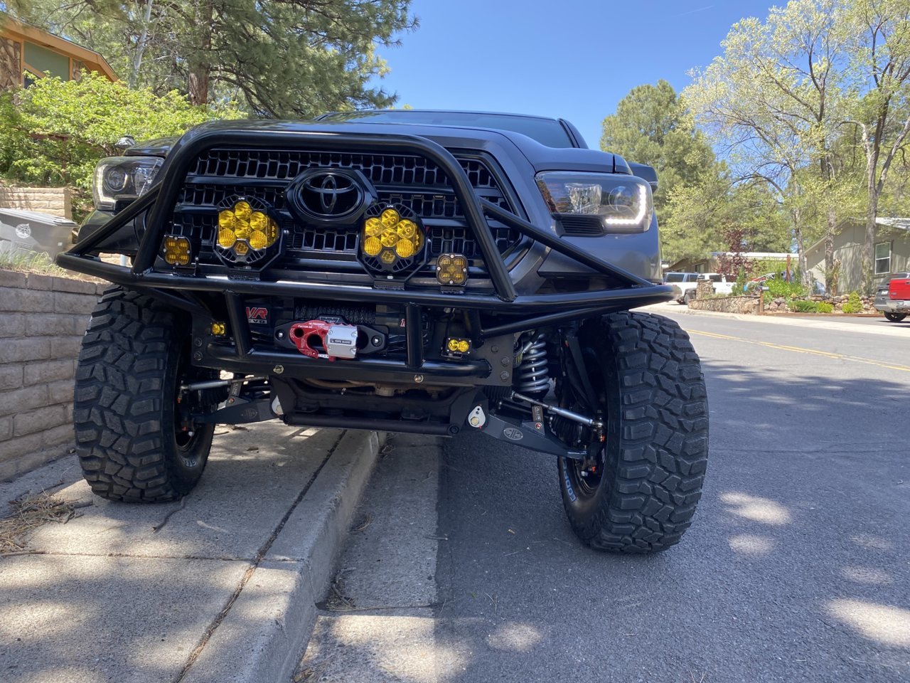

    Hells ya. Oh man, +4? Wow, yea. I can see it.
    Were swapping springs tomorrow. Cant seem to get the 18" to work right it seems. So, gonna swap in the 16"

    Yep 4+ kit, I love the stance, can't wait to get the glass on.
    Which springs do you have? Mines riding a little tall atm, we set the truck to level but I think I'm to lower it down some up front. @EatSleepTacos , how much preload are you running on your 18x500s? So far it I'm riding too stiff on the street for my liking, and there's little to no body-roll. Could be because I have no weight and there's at least one good inch of preload on the springs. I'll snag a pic when I get the chance.

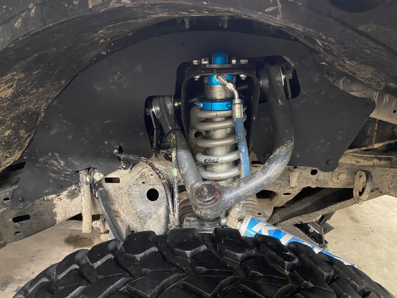

    This is the only pic I’ve got handy.

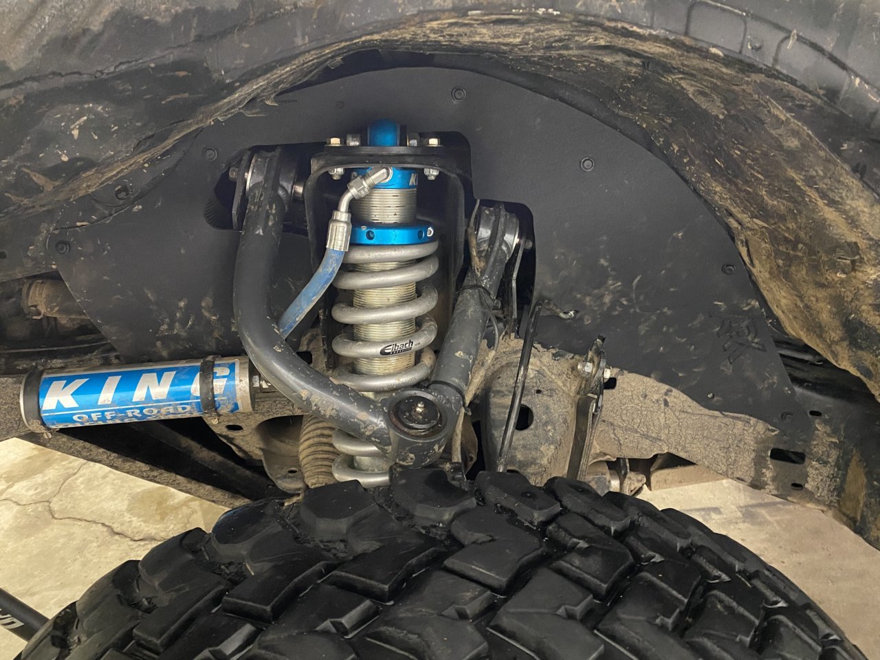

    Actually here we go, found these.

    I put 1” of preload in your springs, with zero preload it sat where I like it. Once you put a bumper and winch on the front it will bring it back down

    The 18” 600 are on. With about 1.5” of pre load to install them. Once we measured yesterday.
    So swapping to the 16” 650 to have more adjustment since we can’t lower the front anymore.

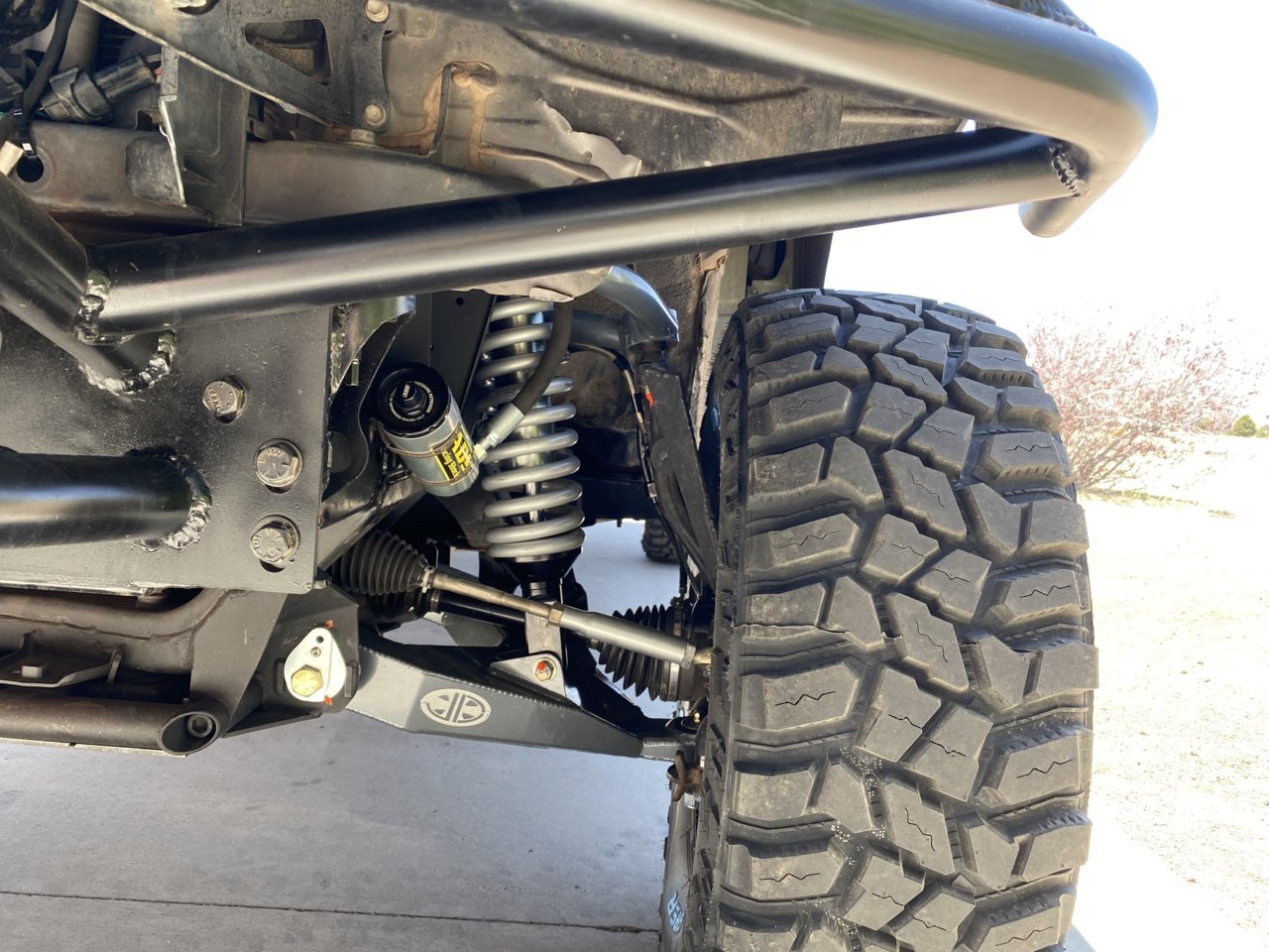

    Ah okay thanks, I’m running slightly less. Need to add my bumper to see where I’ll end up. I wanna get my IFS flexy like yours.
    Yessir. I’m just planning on the aluminum bumper, so I’ll probably lower it to half an inch. I’m taking ride quality with a grain of salt right now since the system is brand new and there’s so much feedback coming from the rear. That and since these coilovers were meant for a first gen, no clue what valving is in them. I’m looking forward to dialing it in.
    18x500lbs.

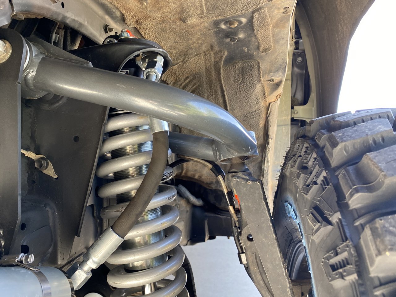

    Well today was a good day.
    We swapped the springs to the 16x650 and it is sitting oh so much better. Messed around with the limit straps and different lengths. Have a good setup now. Did have to get new bolts for the steering as one got some mangled threads. But easy enough to do.
