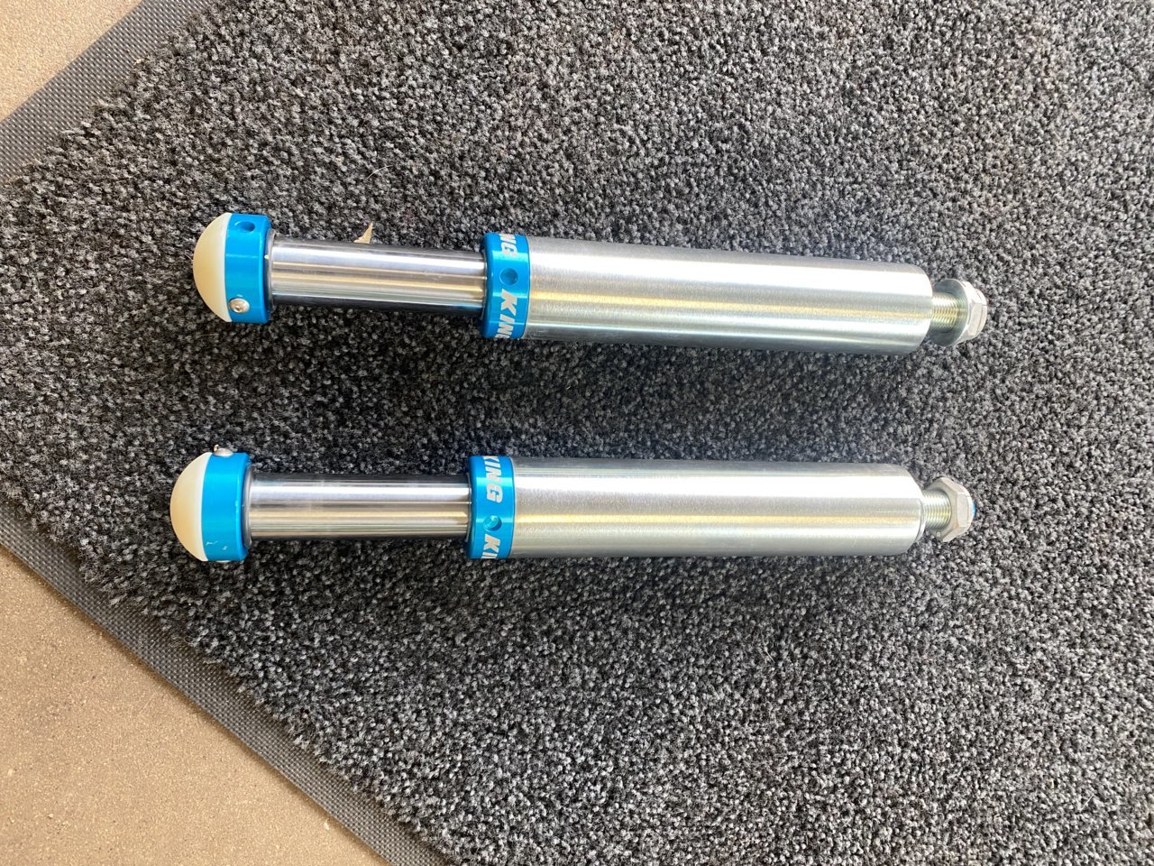

    Picked up some 2.0x4’s for the rear end for a really nice deal. I know Harry doesn’t recommend hydro bumps with SUA, but I’m the type that likes to “explore” a little bit.

    Shorten them to 1.5” and they won’t be too bad

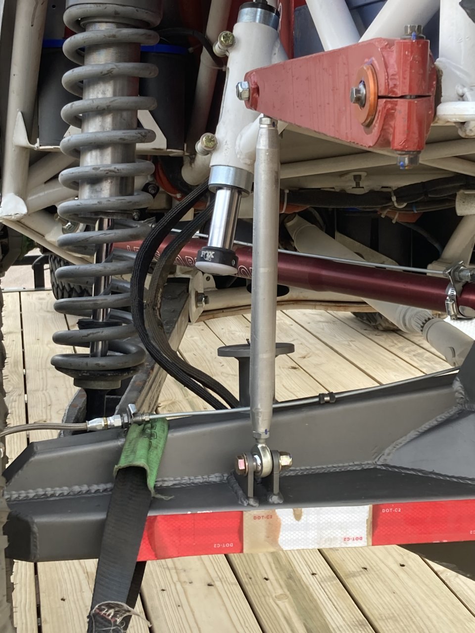

    https://www.tacomaworld.com/threads/airdogs-2012-prerunner-access-cab-slow-build.264263/
    Shortened mine to 2 inches...much happier with it afterwards.

    Swear to god...I thought the same thing posting those pics

    anyone have feedback on the new style of king bumpstop? I like that they have a threaded body for adjustment, not sure if they have the same internals as the regular style, or even the same stroke as a 2" bumpstop, or what. The price is pretty insane if you ask me... but the they look the part, and have built in mounting for the reservoir.

    Honestly, I don’t get the point of a threaded bump. Bump is bump and I can’t see why you would need adjustment once they are in.

    Fair point, and if you are creating your own mount, after you have "finalized" your truck weight, springs and other suspension items, that's very possible. However, if your truck changes, and you add or remove leaves (change the pack thickness), spring over/under, or change shocks that change where full compression is... then an adjustable one might be good. I know my truck is not static, and the one size fits all bolt on bumpstop mounts don't work for me, at least with that fixed style of king bumpstop. Icon and others are clamp-able so the height can be set somewhat.
    I think it is interesting at least. Probably too much money for me considering I already have superbumps in place that seem to be working. And I don't do the high speed stuff where I think the hydraulic bumpstop would be of more benefit.

    These aren't really that new. I know king and locked offroad has been doing them for around 4 years at least. Most OE replacement hydrobumps are a threaded body because there are so many variables depending on setup. Nobody who is doing a custom suspension setup would use the threaded body style.

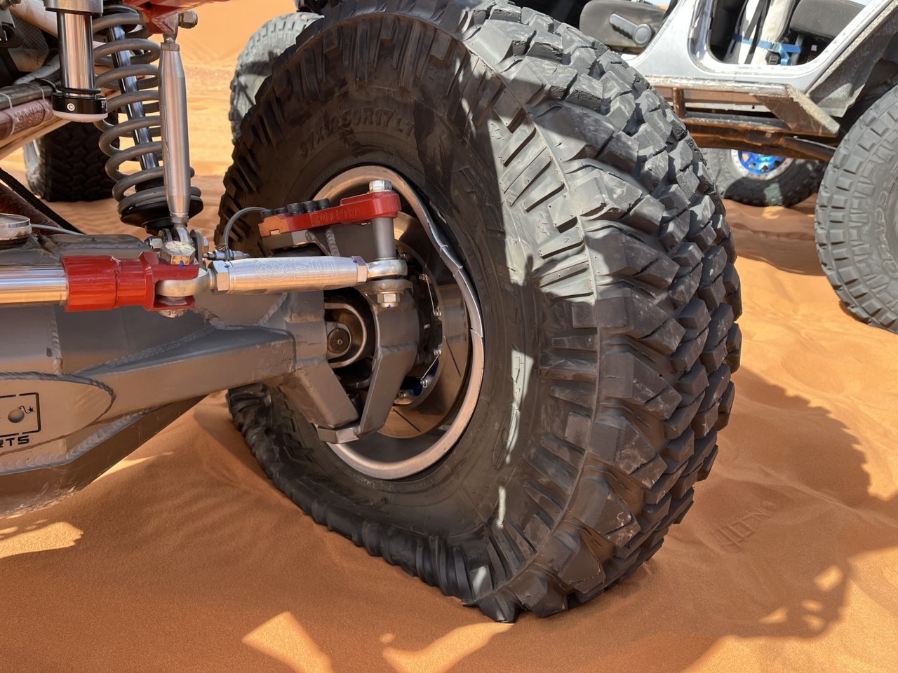

    Really? All of my friends bump stop mount locations and angles changed on a whim when he jumped off the back side of a dune 15’ to flat rock in his 4800 car. It was a hell of a way to break in his new to him race car.
    He also rapidly changed the tire pressure in his front tires along with the mounting placement of his engine
    Along with a few other things.
