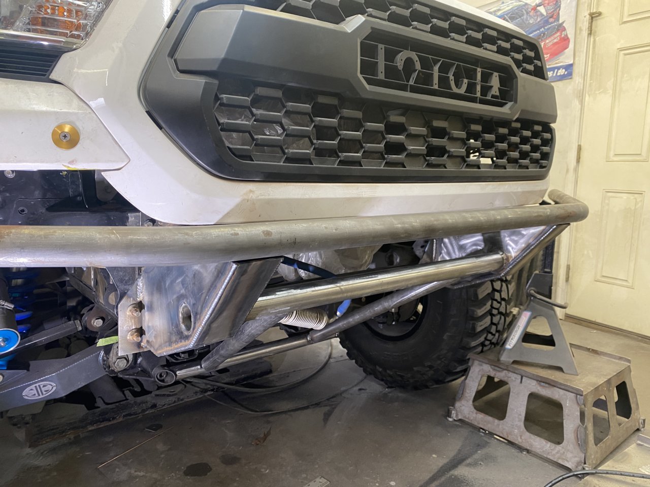

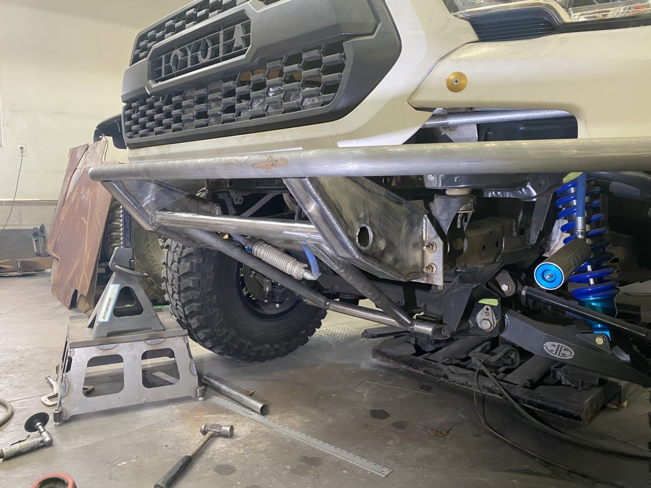

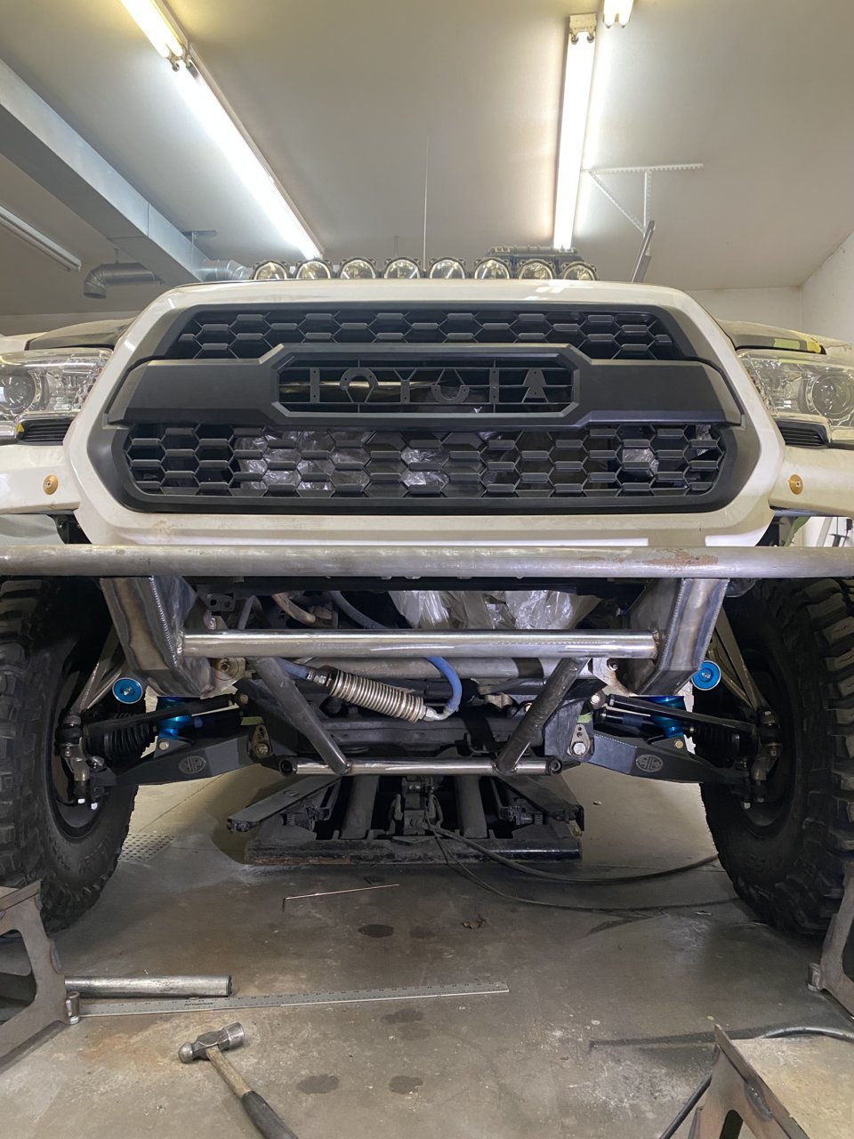

    Last of the fab work should be complete before the end of this week, shocks should be in route this week as well. Things are looking good! Can’t wait to be done with these 100+hr weeks and out enjoying this thing!
