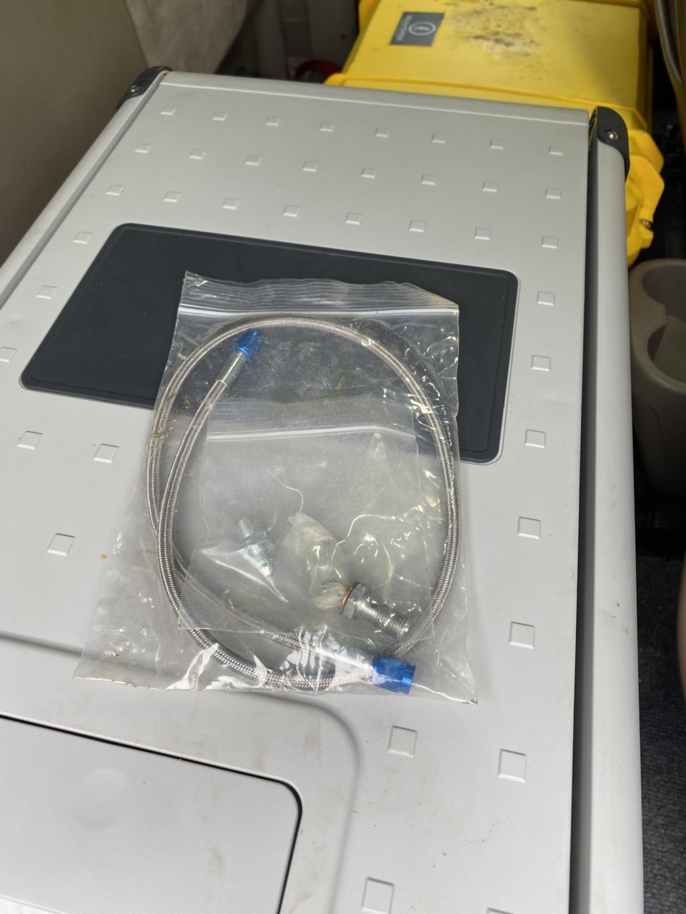

    That’s why I thought the tundra rack was the solution, because full lock with that is like 85% of tacoma rack and would give enough of a gap for deflection. I’ll shave some off of the tab as well as be mindful of full lock, but just wanted to share my experience to inform others as well as see if anyone else has experienced the same (which so far, seems like I’m the only one).
    At least this time it just barely knocked the banjo bolt loose so all I had to do was tighten it down and bleed that caliper and it made it 300 miles home.

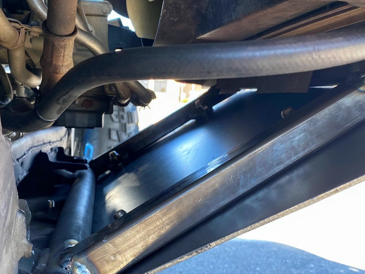

    I have to add some more structure in that area. Also going with a thicker skid. I already pushed mine in on that area.

    Edit: it’s also why I started carrying spare banjo bolts and a new brake line. After losing brakes I realized how crippling that could be.

    Yup. Used some extra limit strap tabs I have for the mounts and 3/16” plate.
    Figured make it easy to fix or replace if/when I bash it in.

    I scored a big chunk of 1/4 aluminum for free.99 so I think that's what I will do mine with. Trying to keep as much weight off the nose as I can.
