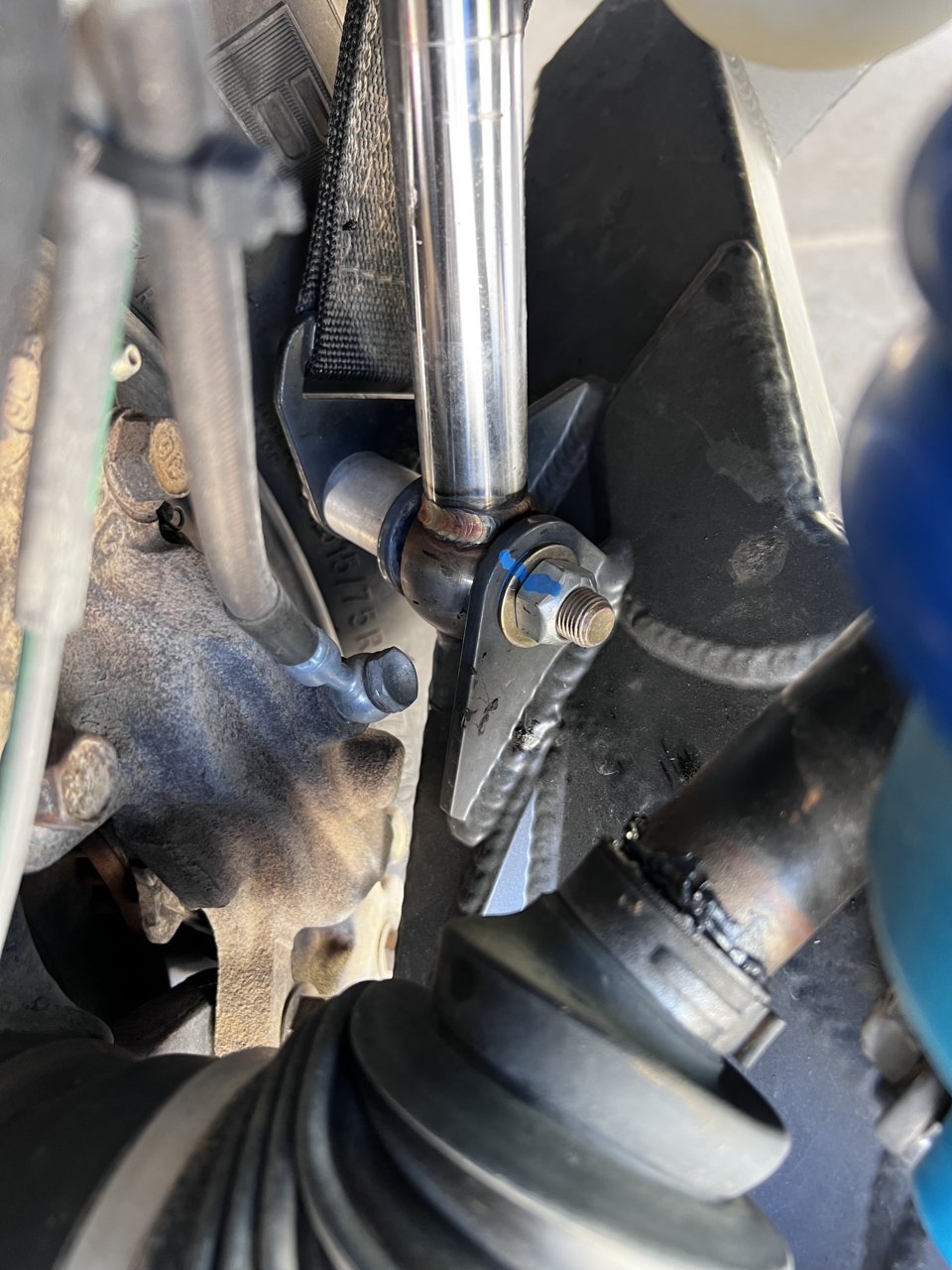

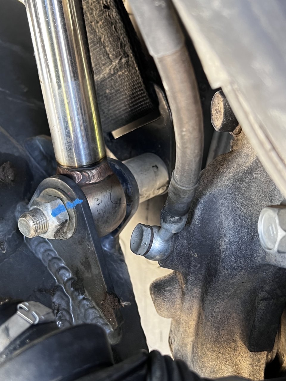

    I cut my steering stops off completely and when I cycled mine at droop, I clear the the secondary shock tab with the banjo bolt. Are they moved back like the shock tabs on the +4?

    So what would be the cause of variance between my setup that allows the banjo bolt to contact the eyelet? Your implying the factory steering stop is trimmed too much?
    No, you cut the steer stop off the LBJ adaptor during the installation as there is not contact pad on the LCA. I would classify that as a component of "the kit." Knowing what I know now I would have looked into leaving the factory steering stops like @906taco did but I feel that would be half assed without modifying the LCA to have some type of steering stop. My immediate inclination is you'll experience rust issues like you mentioned. I'm already experiencing gouging on the arms due to lack of steering stops so that's a mute concern.
    I also ran the DK LCA arms and didn't have a complaint about turning radius so to your point, "damned if you do - damned if you don’t." As mentioned, there is no "perfect solution" as what works for one doesn't work for another. It's a game of trying to appease the majority. I believe that's why TC came out with their Expo Series arms with a steering stop, to limit this exact issue and offer a solution to the "overland" market. That's also why I mentioned it was my opinion. Simply because it probably wouldn't be a concern if I ran the JD slide rack so opinions differ.

    Locked, I’m strapped but I wasn’t conservative with the straps. Slide rack and +4. No steering stops, but I’m making contact with the spindle bracket onto the lower arm.

    The passenger side lives a little closer but still clears.

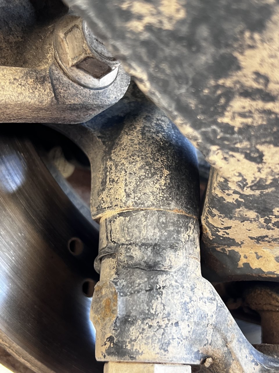

    Truck is dirty as hell, yes my cvs are seeping grease, I plan to redo the clamps this weekend for worm gear clamps that Harry uses now.

    My passenger side outer cv boot leaks grease all over the place no matter what I do. I've tried a tonne of different clamps. I found that with wormgear clamps, the bolt head hits the lower shock bolt, only on the passenger side for some reason, so I can't use them there unfortunately.
    I left the steering stops on. Yeah theres some gouges, but doesn't bug me... there are bigger gouges from rocks than anything else anyway.

    Have you tried oem clamps and squeezing the ever living fuck out of it with breaker bars in the pliers? That’s what I did, no issues yet.

    I wonder if it’s possible you did what I did on accident one time. The inner clamps are different diameters when comparing the inner joint to the outer joint. I had the two clamps mixed up and no matter how hard I tried I couldn’t tighten up one enough to stop it from leaking. Once I realized that and used the correct clamps in their correct spots, no issues.
