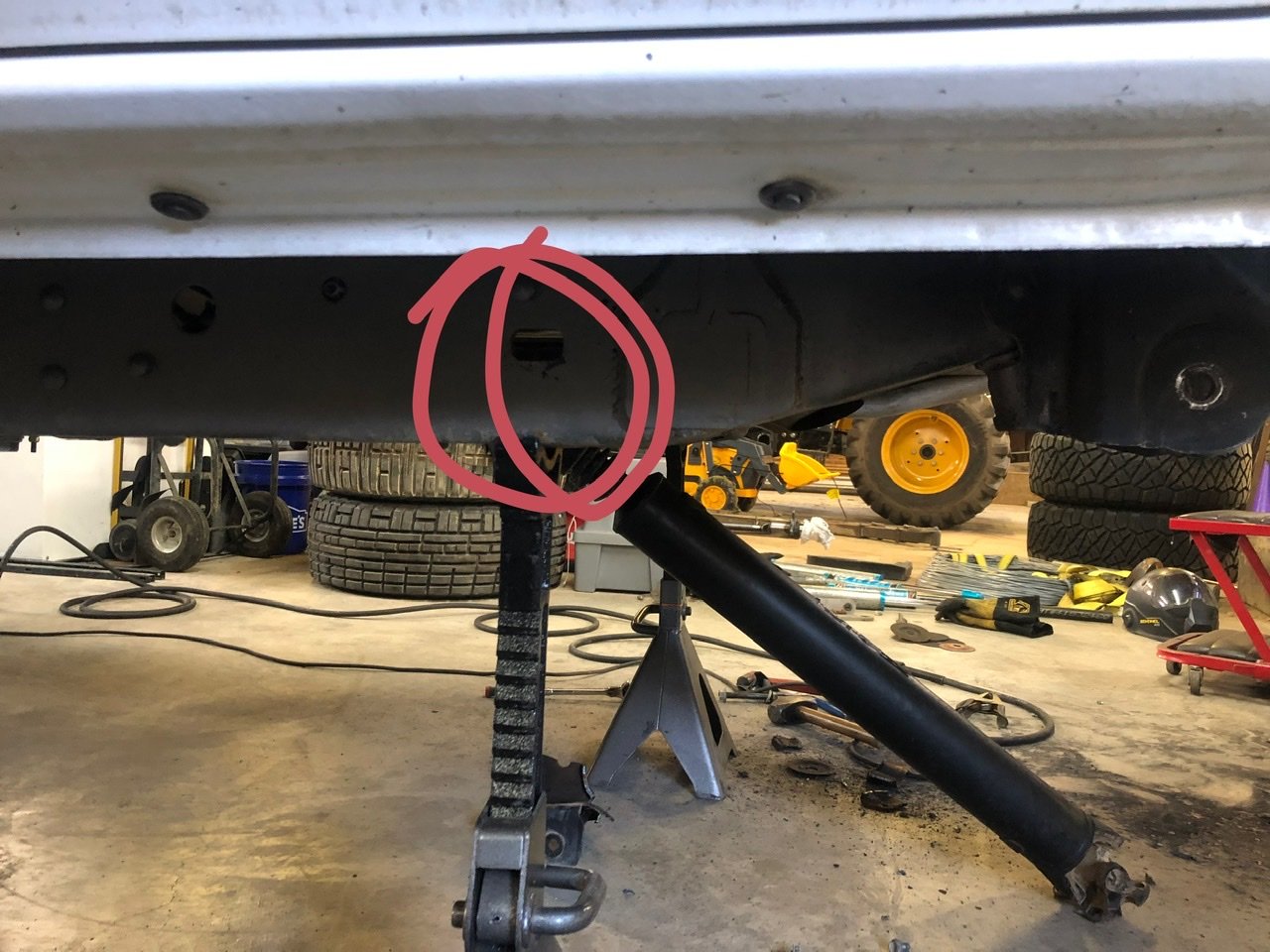

    Hey can anyone here with a double cab short bed do me a huge favor? after cutting everything off my rear i realized i never measured center of my axle to a known point on the frame... Seeing if theres anyone that can get a decent estimate of measurment from the rectangular hole in the frame forward of the front leaf mount to the centerline of the rear axle at ride height?
    Thats the spot i'm trying to reference from. I'm sure i'll figure it out one way or the other but would be nice to have a baseline to start from...

    I’m long bed, couldn’t you do a full wheelbase measurement from the front, then back track to your reference?

    .....probably....lmao but thats assuming my fronts are squared up.... haven't done an alignment since long before i did the jd mounts.

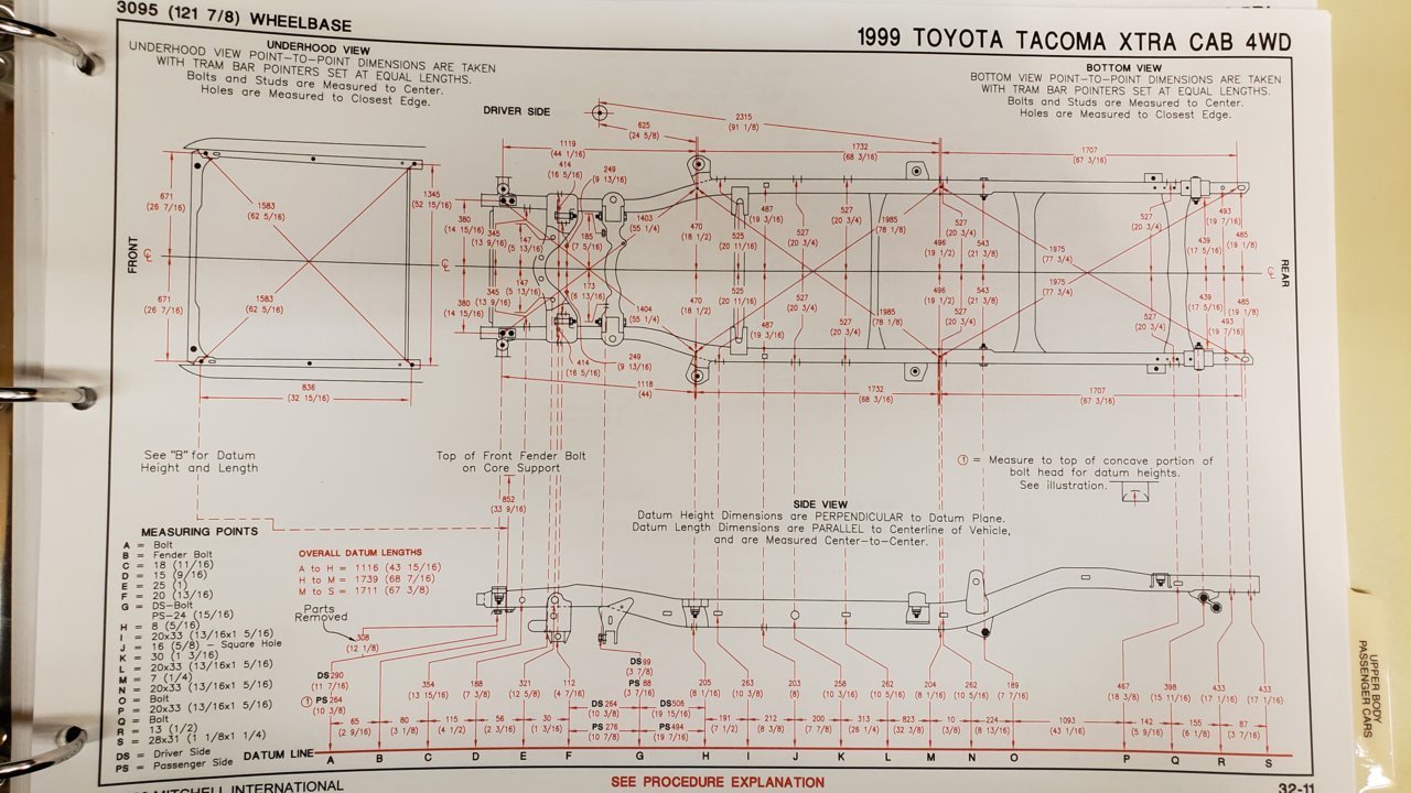

    I stumbled across this for a first gen, IDK where it originated from. But the version for your truck would be perfect.
    edit: actually I don't think that would help with locating the axle, nevermind.
    https://www.tacomaworld.com/threads/truck-cant-get-aligned-pulls-right.663778/page-3#post-23279091
