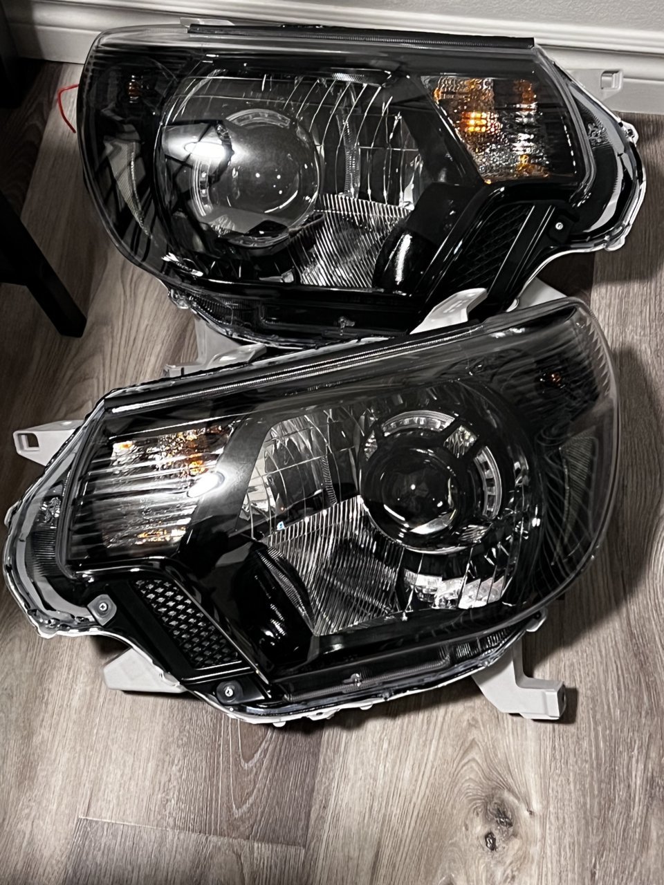

    What do you mean? I have archive garage spring under currently. Picked up some h70s form Harry, waiting for him to stock his hangers so I can switch to the JD spring under. I want a more comfortable ride that can play nice with the +4 while I wait and collect link parts over the next year. Since most of it is bolt on I’ll sell the whole suspension and axle take off.

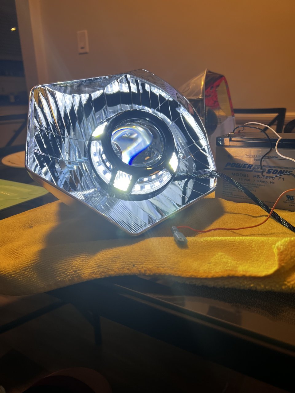

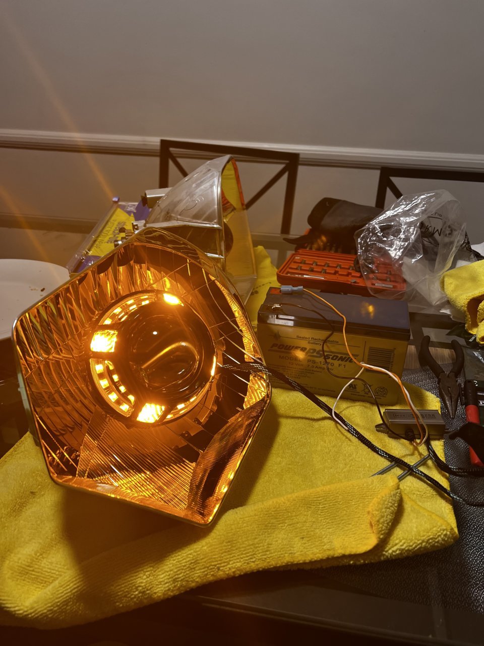

    It’s not a kit, full projector retrofit. I bought some new Toyota headlights, I used NHK bi led projectors, panamera switchback shrouds. Which are not compatible like most shrouds, found out the hard way. Lightwerkz said they didn’t know. Painted the surround and Epoxied the projectors in with the nut and bolt method. Sourced all my parts from lightwerkz.

    I really like that bumper. :thumbsup:

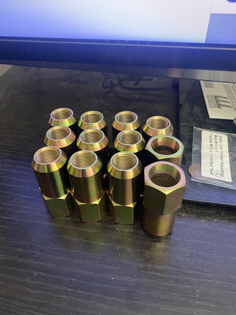

    Mmmm. 5/8 Lug nuts. Someday……

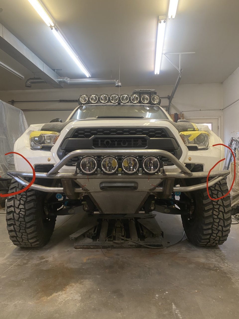

    How did you do the tube on the ends that is at a small angle? Every one I do that steep looks like the end of a fucked up soft taco.

    You talking where I brought the lower tube into the upper?

    Ones like these-

    They are kind of a bitch to get proper. It’s basically a compound angled notch. I basically just walk them in with a few passes on a belt sander I made for tube work. Bend angles also play a decent part in getting them to land right.

    No notcher just kinda shave a bit off at a time?

    No notcher. Roughed in with a cold cut saw and made right with a belt sander/3” sanding wheel. 95% of my notches are done this way. Just how I learned to do it.
