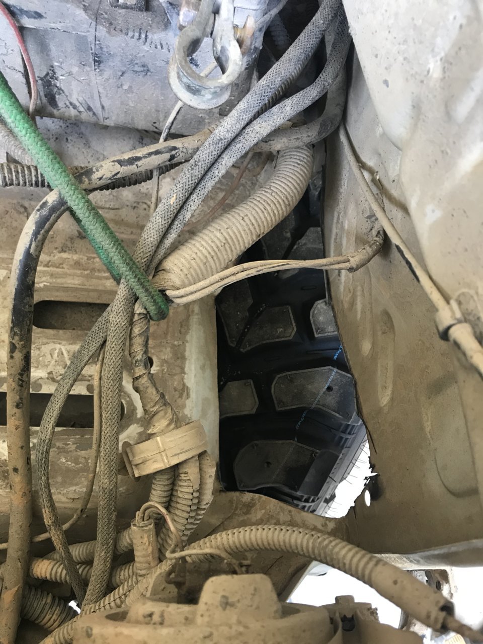

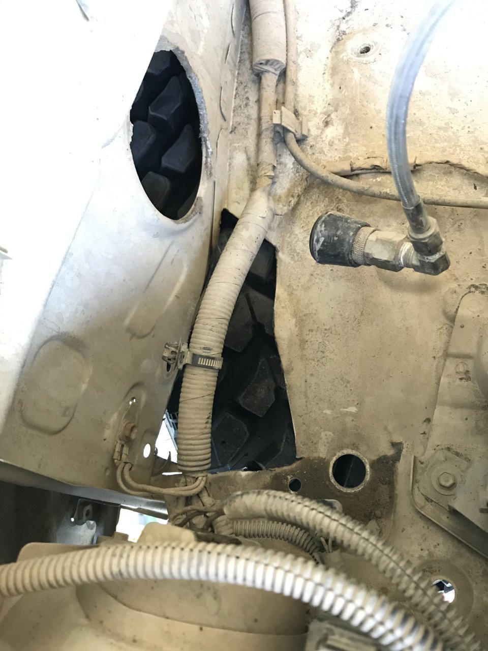

    That’d be pretty neat. Only reason I asked is I started clearing for 35s and lord there’s a lot to cut out, both front and rear so I’m curious how it’s combatted, the front part specifically. I am a second gen though.
    957C78A5-75C1-4B2D-8DF4-7B94B5A02B50.jpg 77F75759-3FA1-40CA-A669-58993CCCC7E9.jpg
