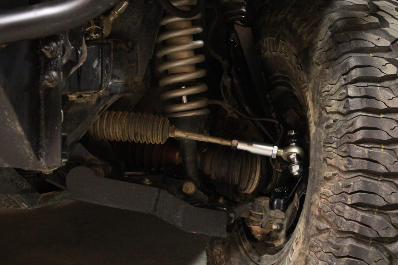

    Ive got 16X8 -12, 4 inches and its super tight. Thats about all you can get away with. I know pic sucks but you can kinda see how tight it is.

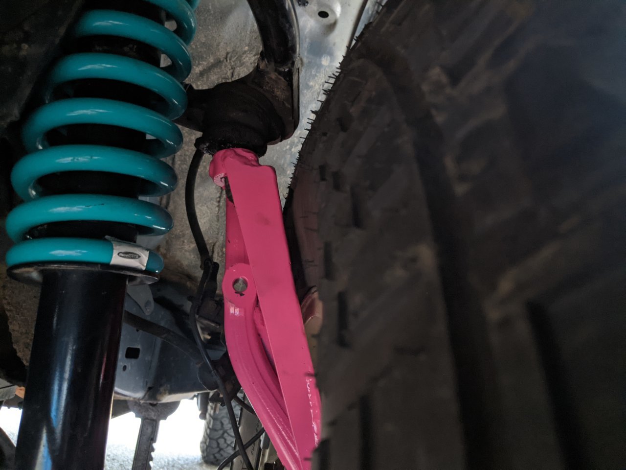

    I'm running 17x7.5" FJ wheels also with no spacers and 35x10.5 tires and it's reeeeaaaally close but does work. I've got some thinner bora hubcentric slip spacers and longer studs I'm going to try to give a tad more breathing room
    And yes, they are pink

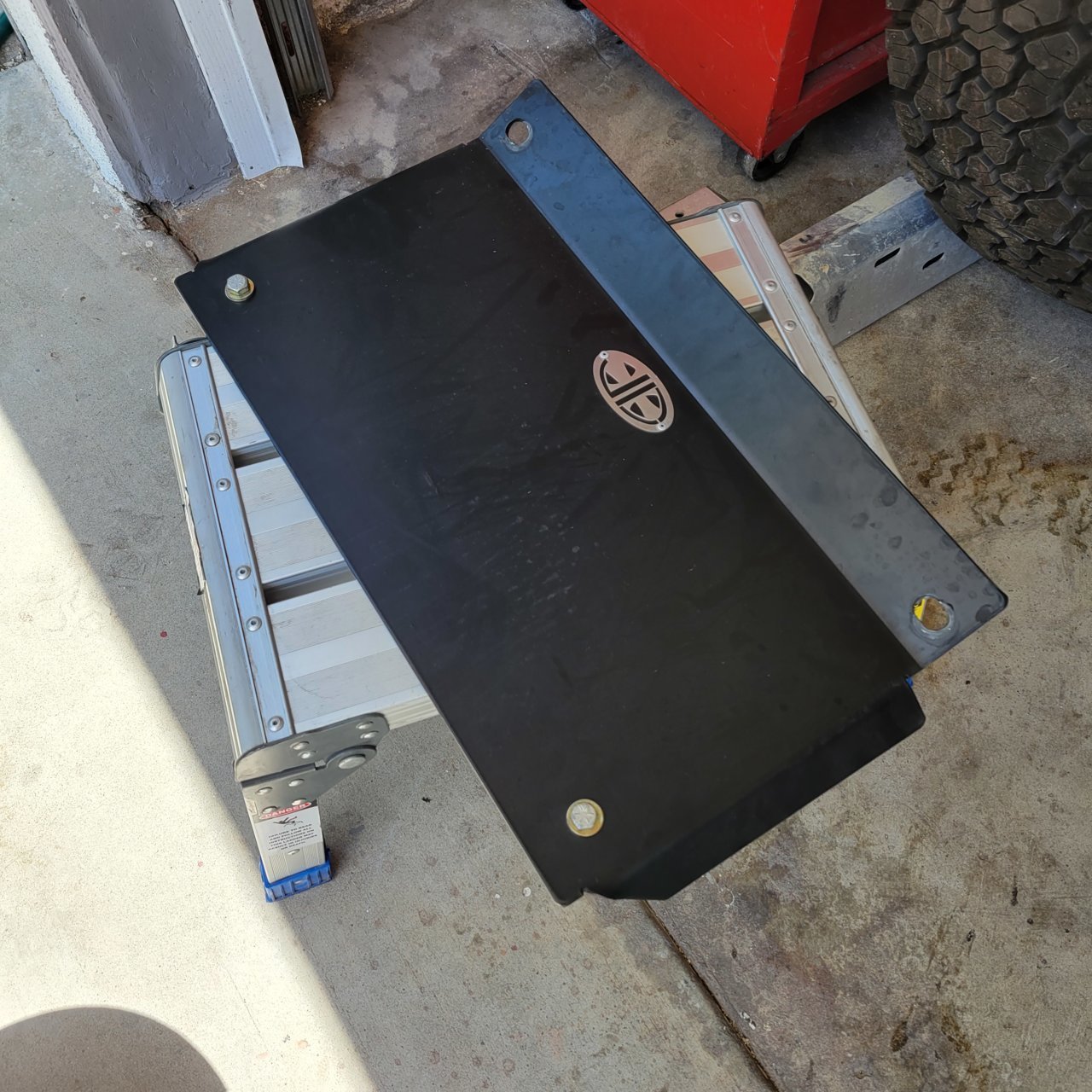

    JD LCA Pivot kit steel skid for sale. I went with complete new bumper and skid so don't have any use for it
    PM me if interested.
