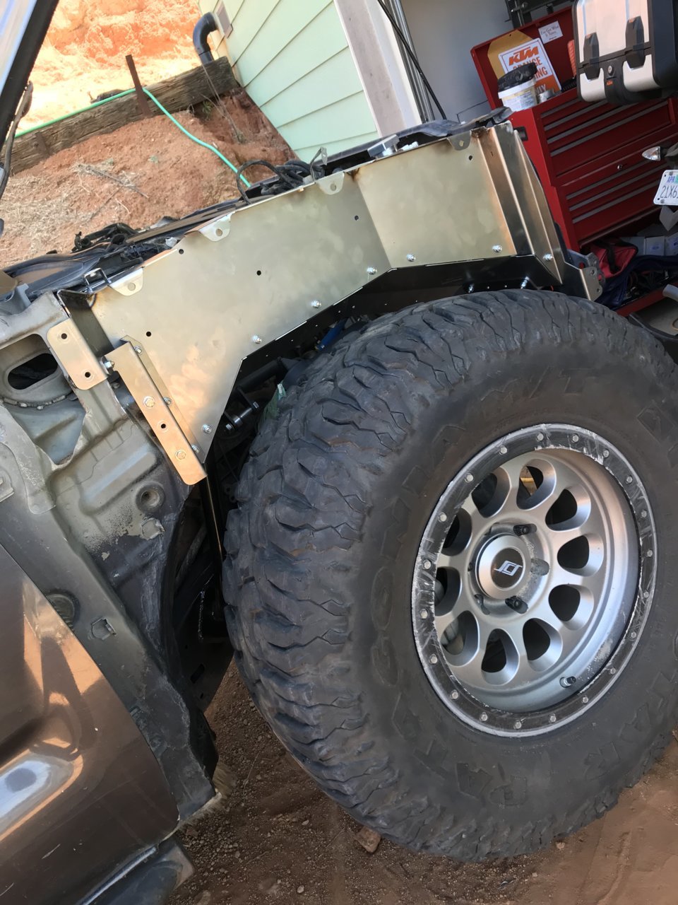

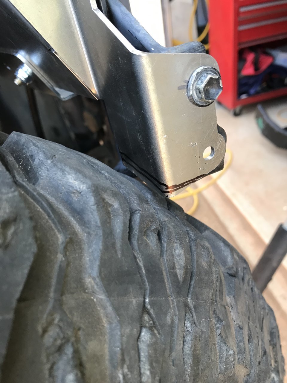

    Continuing this project. The kit is very well designed and fitment has been great. Plenty of room at full bump with 35”s. Only a little bit of trimming up front was needed to avoid rubbing at bump/lock.
    I’m taking my time on this to make everything fit right and fully cycling the suspension. I’ll be adding hydros this week or next weekend while everything is apart.

    don’t forget to trim a little extra as Harry has warned us about he is seeing trucks flex 3/4” + past full bump

    This. And it looks like your tires are wore. First time I tubbed I went with about an inch clearance all the way around. It wasn’t enough. This time I going closer to 2”

    How much you trim off the front depends on how far forward you end up going. On trucks that I go the full 1 7/8” forward I completely cut off the bracket that mounts the lower part of the grill.

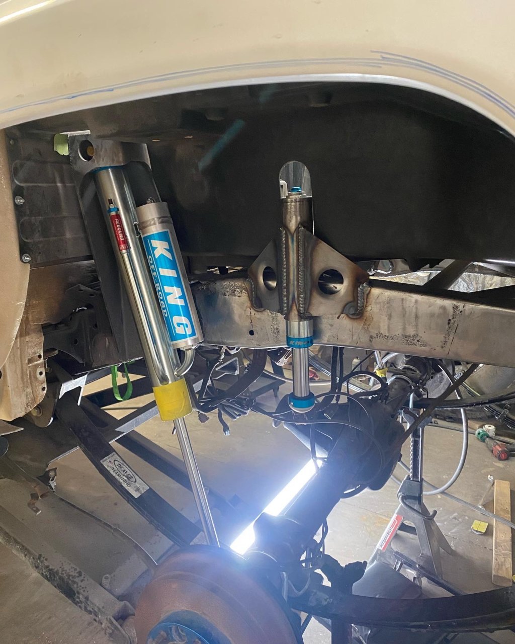

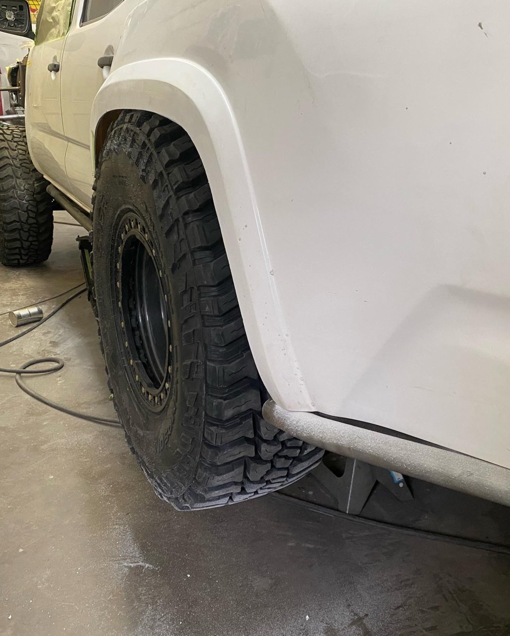

    This SUA kit sure cycles beautifully. Pulling 16” from bump to droop which is about the same as my archive setup, however the uptravel gain is ridiculous. H70HD’s also seem like they will be just about perfect. Going to tub out my bed to make room for the 37’s when articulated and it’s a solid wrap back here. May end up changing the bump can gussets as I’m not sure I like them. But for now that can wait.

    Looking good! It does look like you could mount the bumps up a little higher to squeeze another inch of travel out of it however I’m guessing the 37’s will be into the bed tub pretty badly.
    I really like the H70HD springs for the weight carrying capacity, the only down side is they don’t drop out as much (about one inch)

    My bump striker pads are only 3/8" from frame contact with around 1/2" of shock shaft remaining. Its pretty tight under there. Zero tire contact even with the axle pushed into the frame. Under articulation is a different story though.

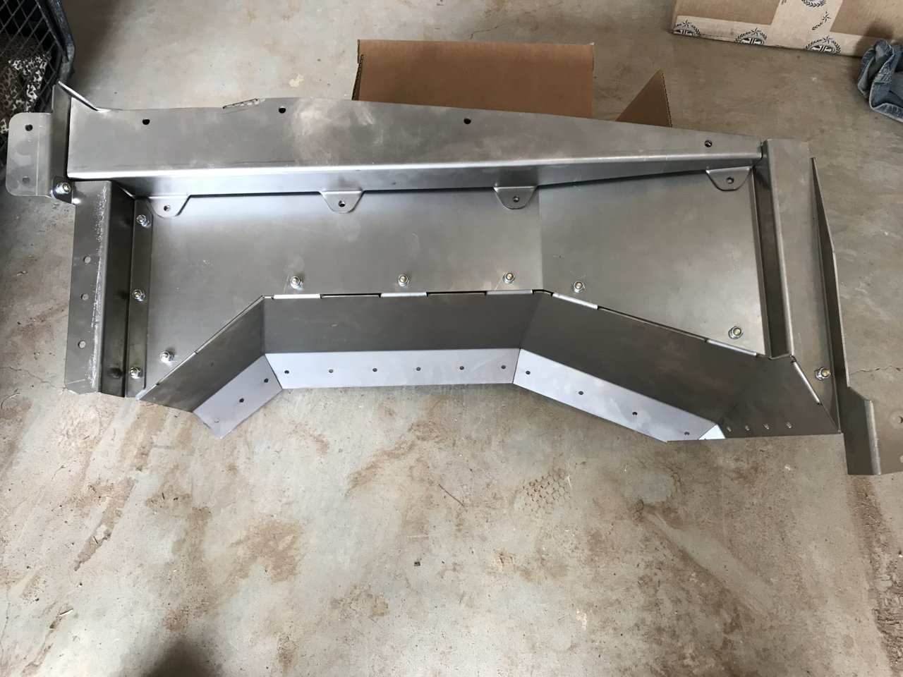

    Just a heads up you guys might want to check out the inner fenders on the website....

    A combination of covid material prices coming down and the new tooling we have have has greatly reduced cost.
