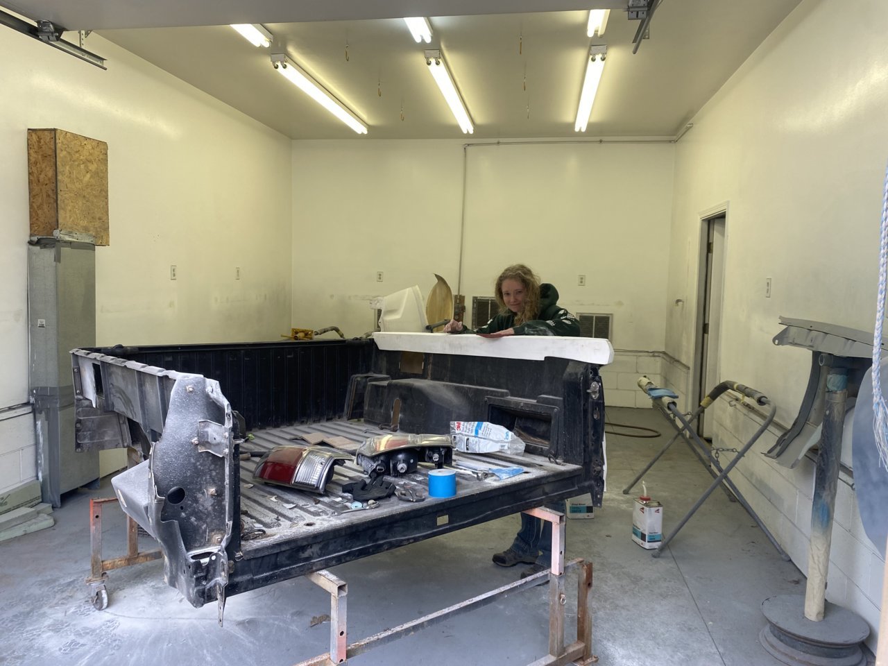

    Today we are prepping bed sides and the cab for primer. It’s nice having good help! Man, the excitement is absolutely off the charts.
