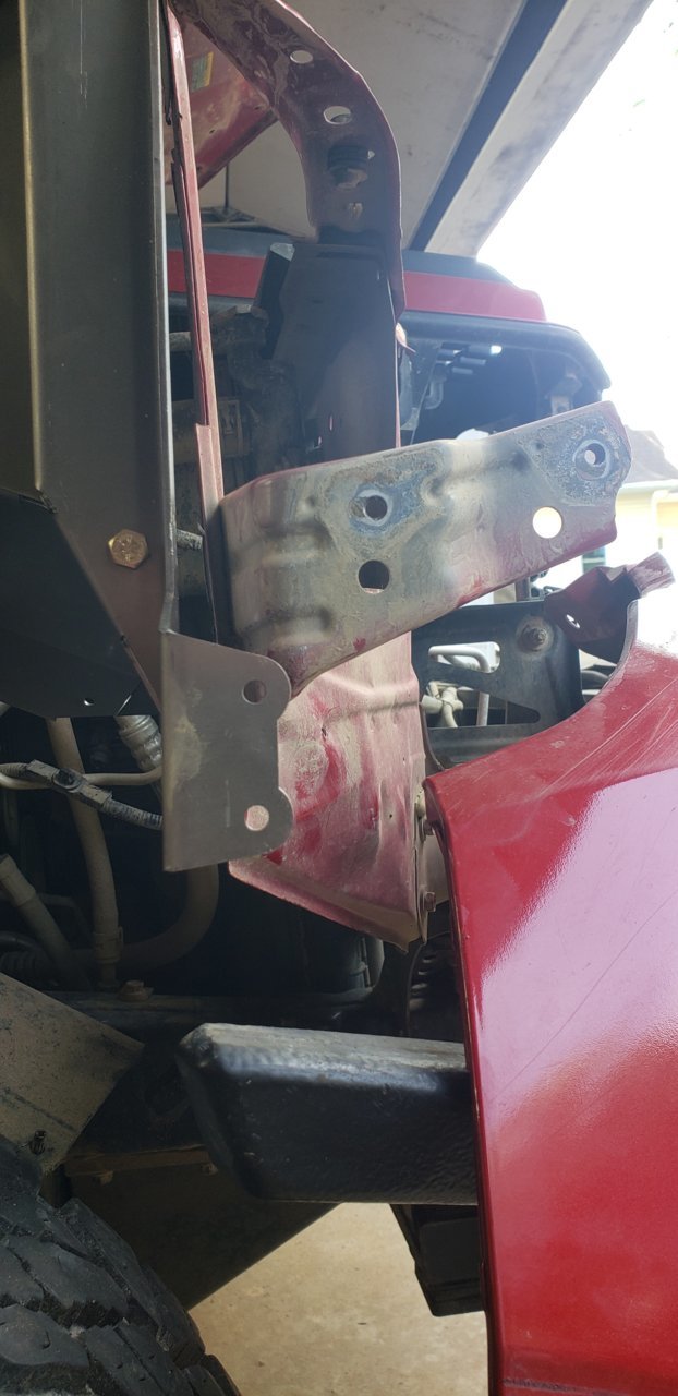

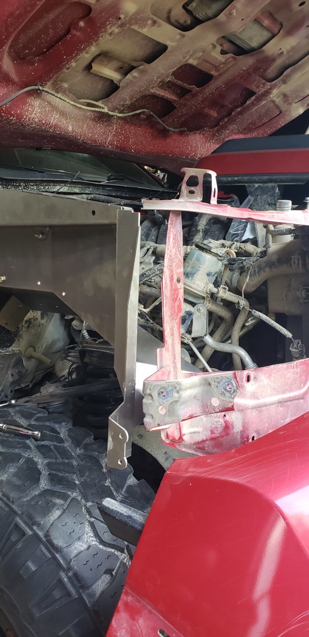

    Cut it off. Not needed for 3rd gens.
  3. May 29, 2022 at 3:48 PM
    buk
    buk Well-Known Member
    Sep 24, 2019
    #306203
    93
    2017 barcelona DCLB trd sport 4x4
    Thanks. I didn't see it called out anywhere. I was thinking i was losing my mind

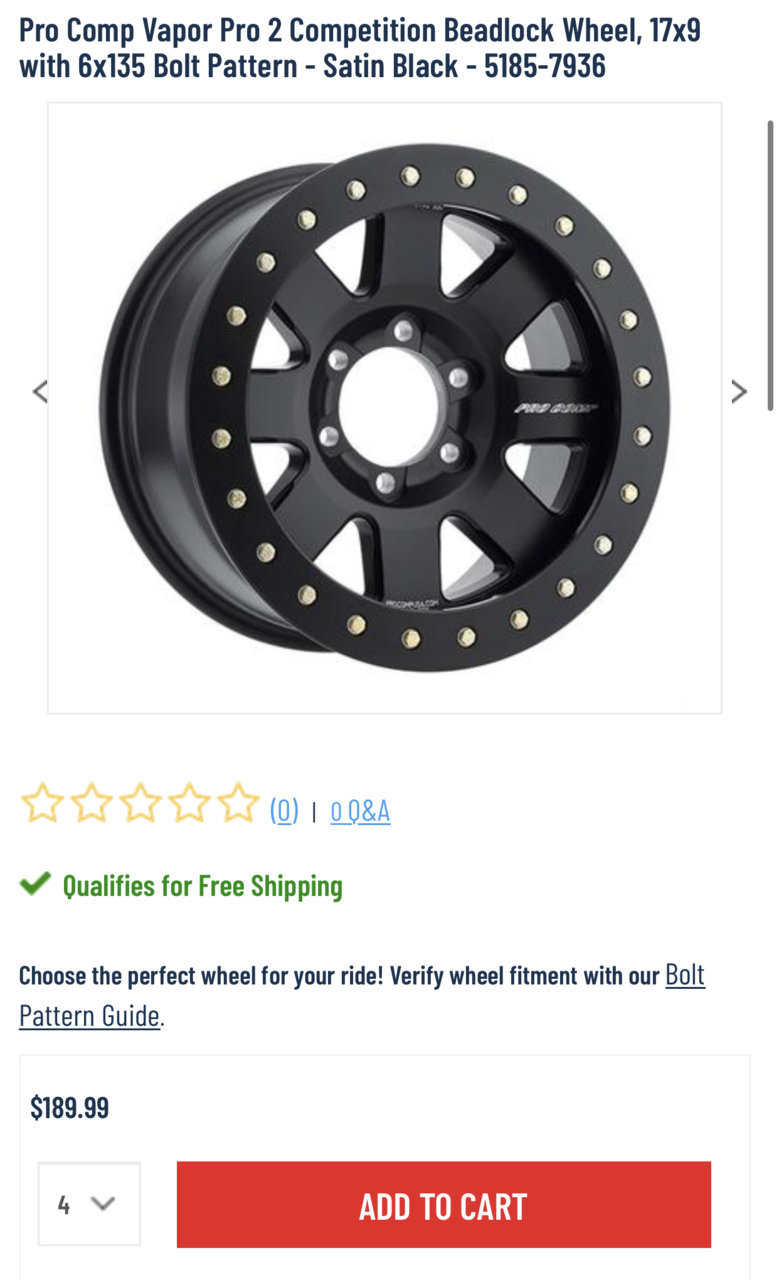

    Anything wrong with these beadlocks? Really good price, but can’t find much on them. Would need 0.75” spacers to fit a 40x13.5” tire and that’d keep everything as tight as possible up front.
  5. May 30, 2022 at 2:46 PM
    Supra4x4
    Supra4x4 IG: hash_brown55
    May 8, 2015
    #154861
    3,396
    Andrew
    SoCal
    MGM 2011 DCLB 4X4 Long Travel'd
    Whole lotta stuff
    I’m no expert on wheels but did you double check they make it in our lug pattern? Ours is 6x139.7 vs that 6x135. Other than that, those would be heavy AF since those are clearly not a forged wheel and even forged, I wouldn’t want to push around a 40in with our baby V6 :ballchain:
  6. May 30, 2022 at 2:48 PM
    Dayman Karate
    Dayman Karate Well-Known Member
    Dec 18, 2017
    #238838
    4,722
    Clay
    Central Alabama
    JKU Rubicon
    https://www.tacomaworld.com/threads/daymans-karate-class-but-you-wont-learn-nothin-4-link-lt-and-previous-iterations.755134/
    Dang I didn’t notice the bolt pattern was wrong. Poo

    Save your money and buy a quality wheel with the correct offset so you don’t have to run spacers. Also check Racedezert for used takeoffs... the Tacoma lug pattern is 6x5.5 which is the same as a Silverado, I always see good deals on used wheels. Or you can mortgage your house and buy some forged Trail Readys :)

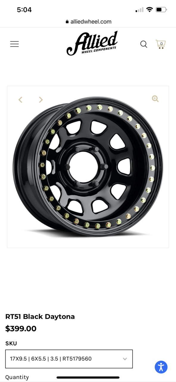

    I’m tired of buying wheels haha the only other thing I’ve seen are these steel ones. Probably heavy as hell especially with a super swamper 40 on top of it :rofl:

    They make them in our lug pattern and they are good I know quite a few people who run them.
    The round hole ones are the ones I have. They are pretty heavy but all beadlocks are. If you're concerned with weight then Black Rhino has some of the lightest beadlocks on the market.
