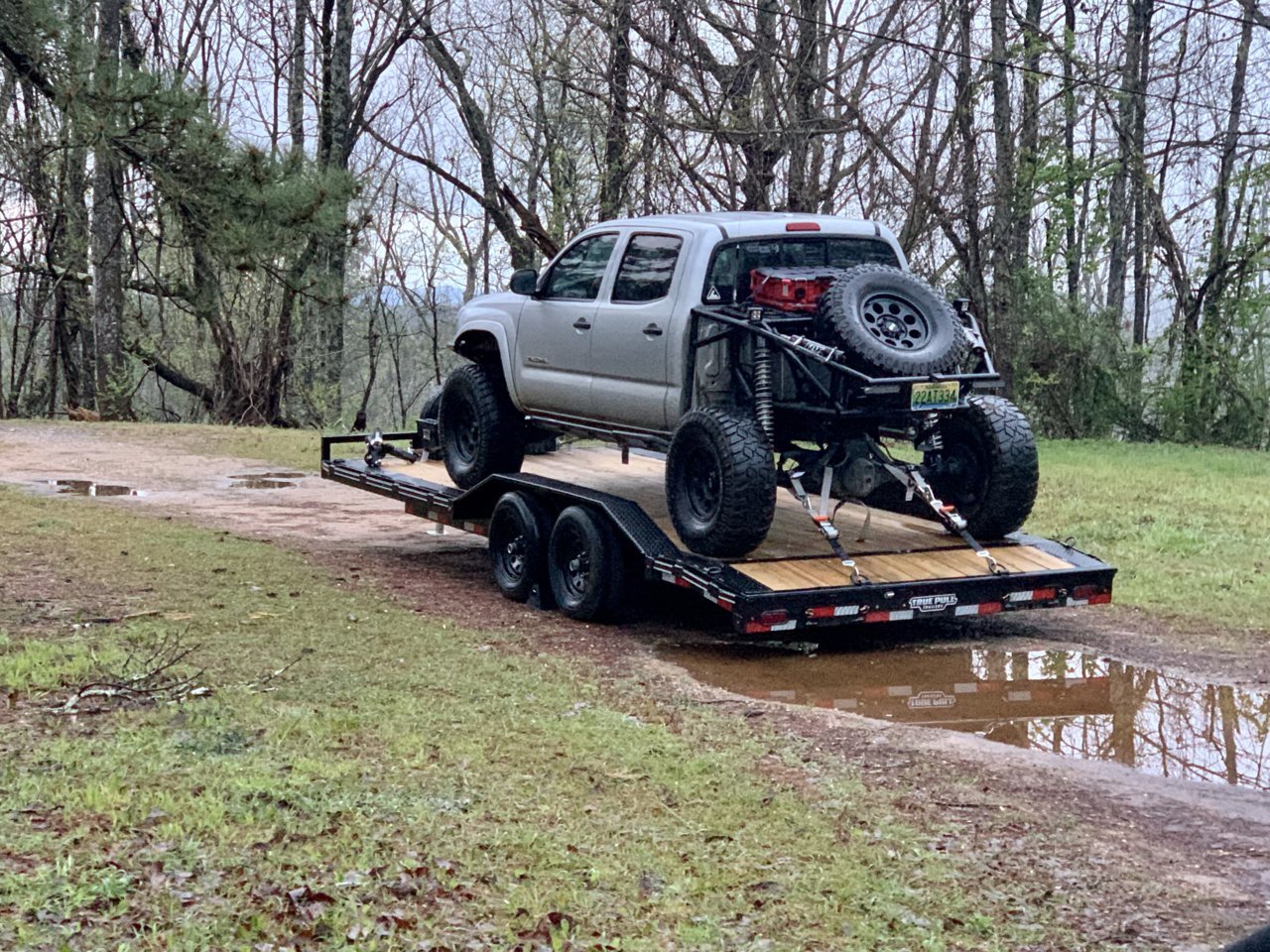

    30lbs is with the bolts, washers, rings and metal valve stems.
    And yes E rated tires are for semi trucks :)
    RoaminRoman and Slashaar like this.
