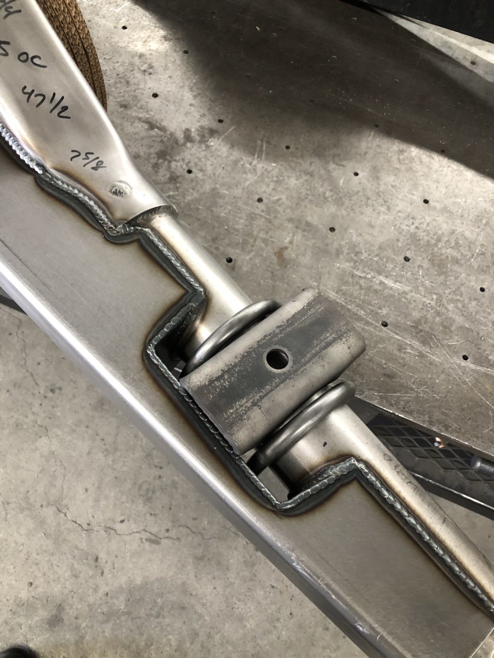

    The most unique and special Tacoma

    UBolts for us losers still with leaf springs.

    As @Airdog said they are for the u bolts. I made them a little wider to accommodate the different spring perch widths based on what spring under kits people have

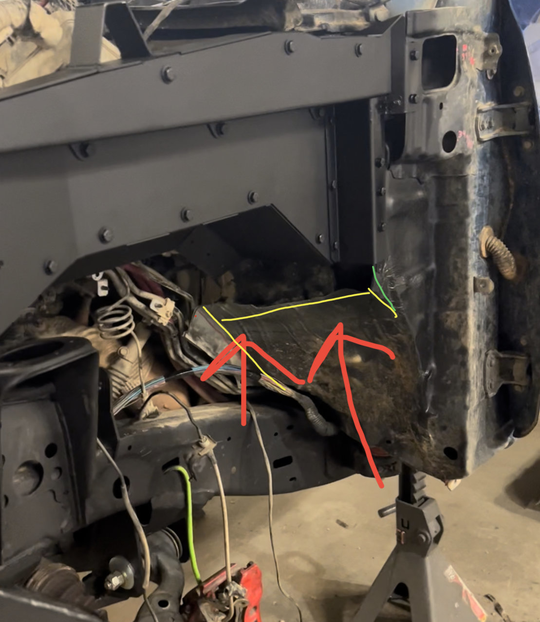

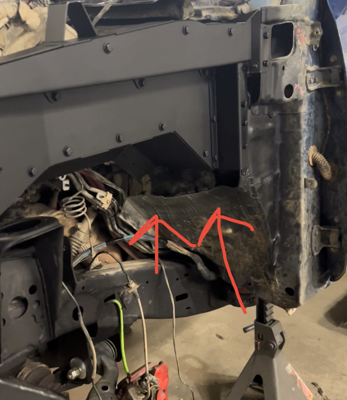

    What’s is everyone doing with this portion of the inner fender? I have a few ideas but would like to see what others have done as well. Thanks

    Cut it flush with the cab but be careful not to completely cut the cab seam apart

    I made a relief cut at the end and hammered it flat with the firewall. Then cleaned up the vertical piece that was left. The remaining inner fender was about an inch wide. I haven’t done it yet but planned to throw some seam sealer on it.
