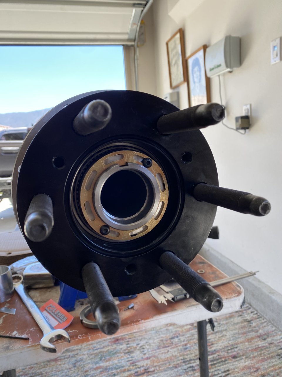

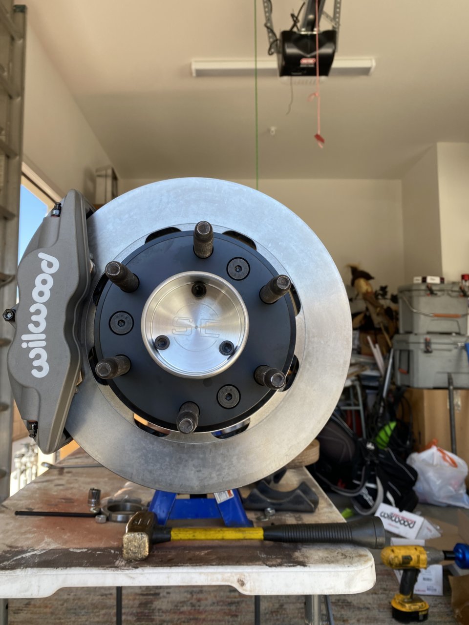

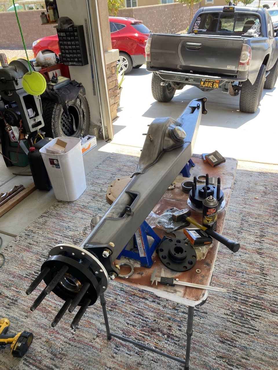

    Little bit of work going down in my garage today.
    330DE876-0FDD-4D7B-8C93-689B94BBCECE.jpg 9BEF2E68-5B14-442F-8EEB-C905DA5F3206.jpg

    Are you compensating with those studs ? wtf are those for a dually ?

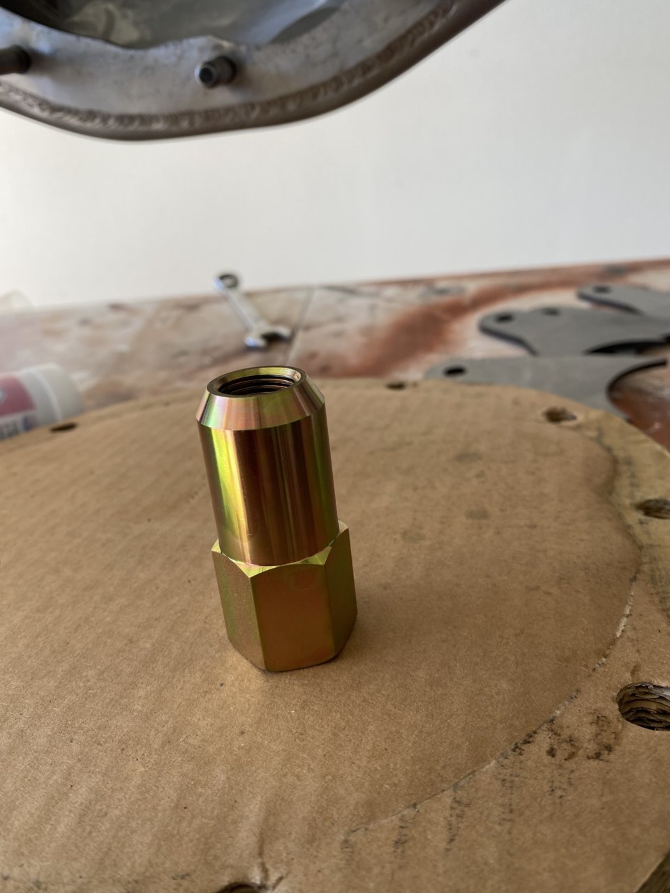

    They go perfect with these lug nuts that cost me $150 bucks.

    does your wife know that you have the living room area rug in the garage ?

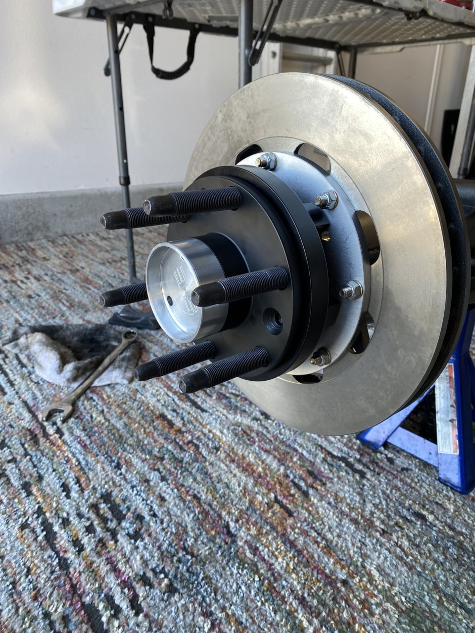

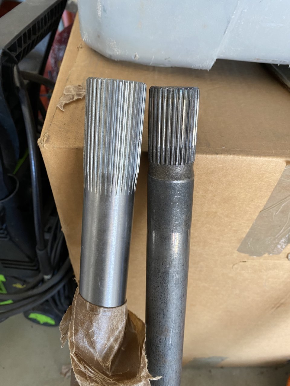

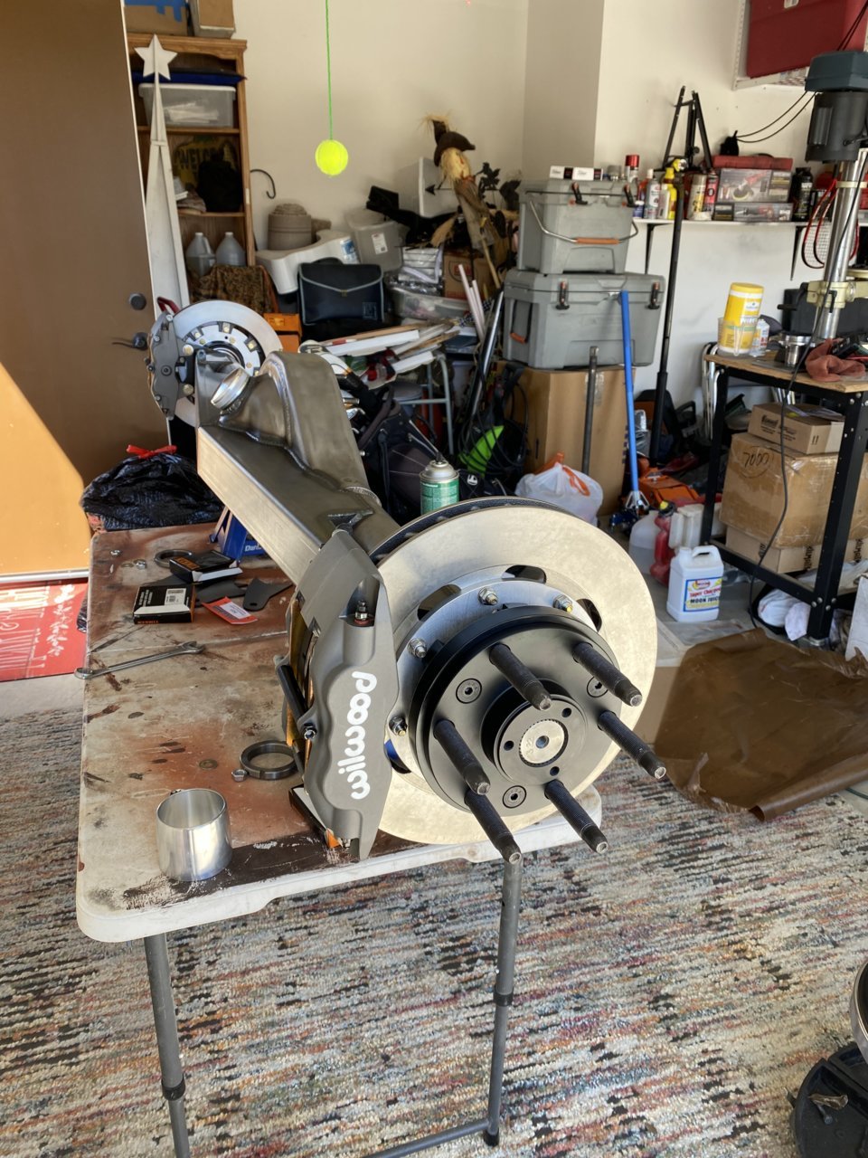

    Few pics of things going together. Spent a good portion of my time setting up the adjustable spacer inbetween the bearings. They are a bit pricey for what they are but worth it. Pretty much just fit checking everything before install so no surprises. Waiting on some brake line parts from crown which should show up early next week.
    7BA511B4-1D90-4241-9D46-7F19B9E76C52.jpg E60BE669-5AE7-40DF-8E9B-44AB4C2B6E39.jpg 242C760C-3247-4917-A089-9AC04F3CF0DE.jpg
    Stock vs 35spline

    It actually was the living room rug at one time. Easier to use it in the garage rather than try to find somewhere to dispose of it.

    What’s crazy is the jumbo 36 spline axles we use in the big trucks are twice the size of a 35 spline axle

    Hey what pattern did you order your TR’s in? When I did mine I did them in the 6x5.5 race pattern which is bored out to 4.25 center and setup for 5/8 lugs but they come with a 45 degree taper for the lug nuts and I had to switch from this prerunner lugnuts to standard 5/8 race ones from arp.

    I have no idea...lol. @81Trekker placed the order for me. He would know better. But I imagine its not the race pattern. The 4.25 bore would not pair with the front hubs on my truck

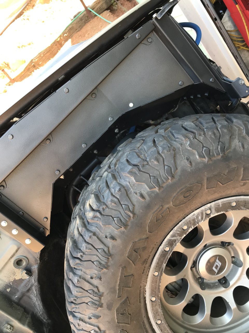

    Side note actually have a little progress on the back half for the truck. Need to throw the bed on tomorrow and make some decisions
