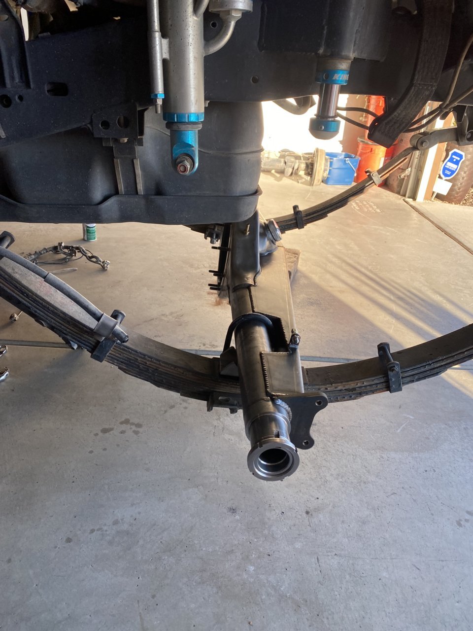

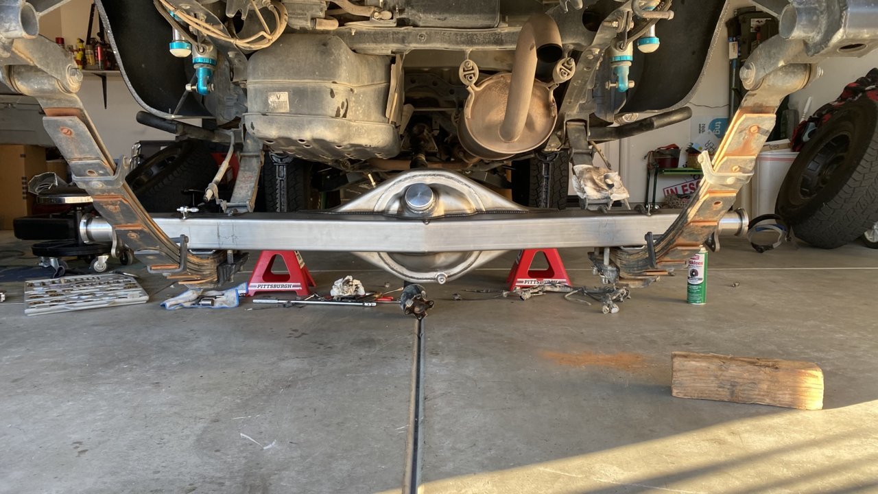

    And the fun starts!
    43966B85-24DA-4F17-93B4-E4CC0FA87B6A.jpg C68C7724-5344-45AE-8597-E4CD71339A8C.jpg

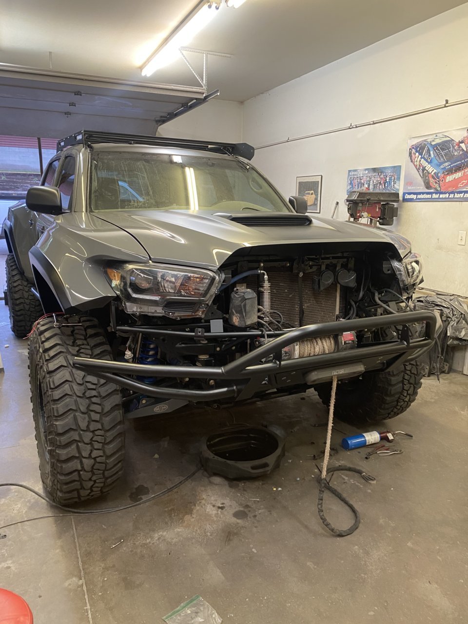

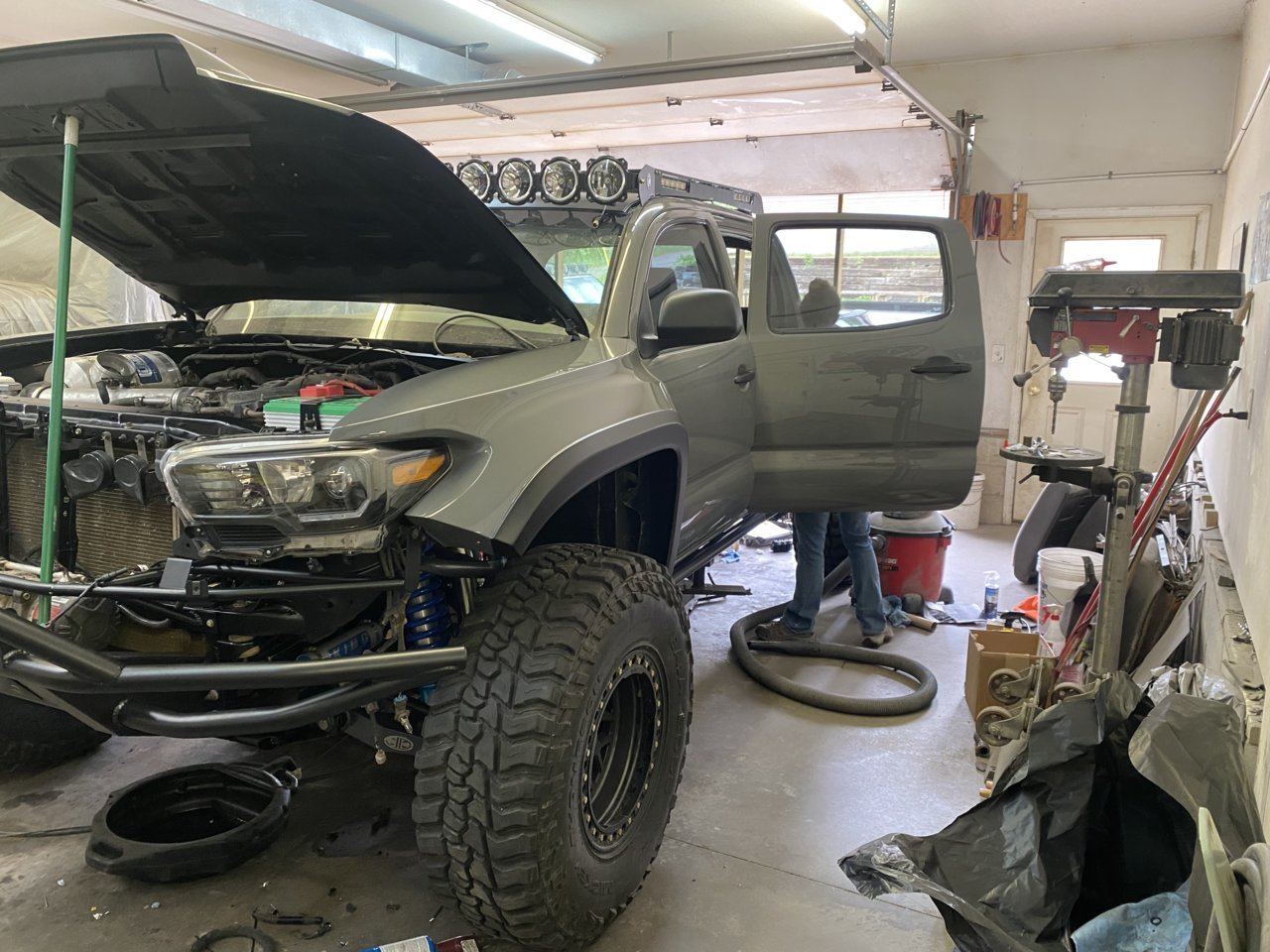

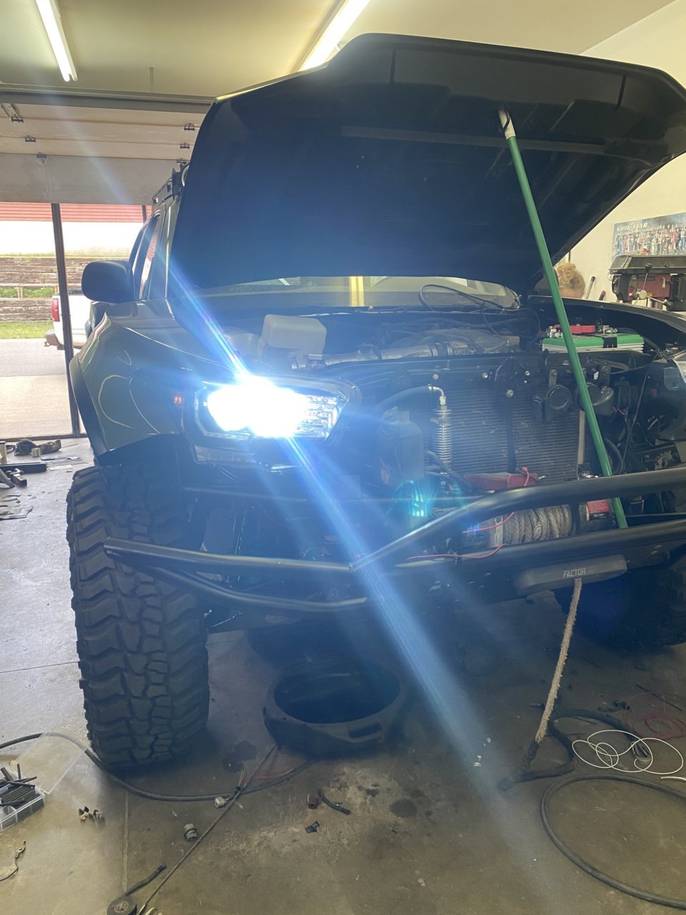

    Well, it looks as though we will be wrapped up by the end of the week. Just in time to have some fun over the 4th of July weekend.
