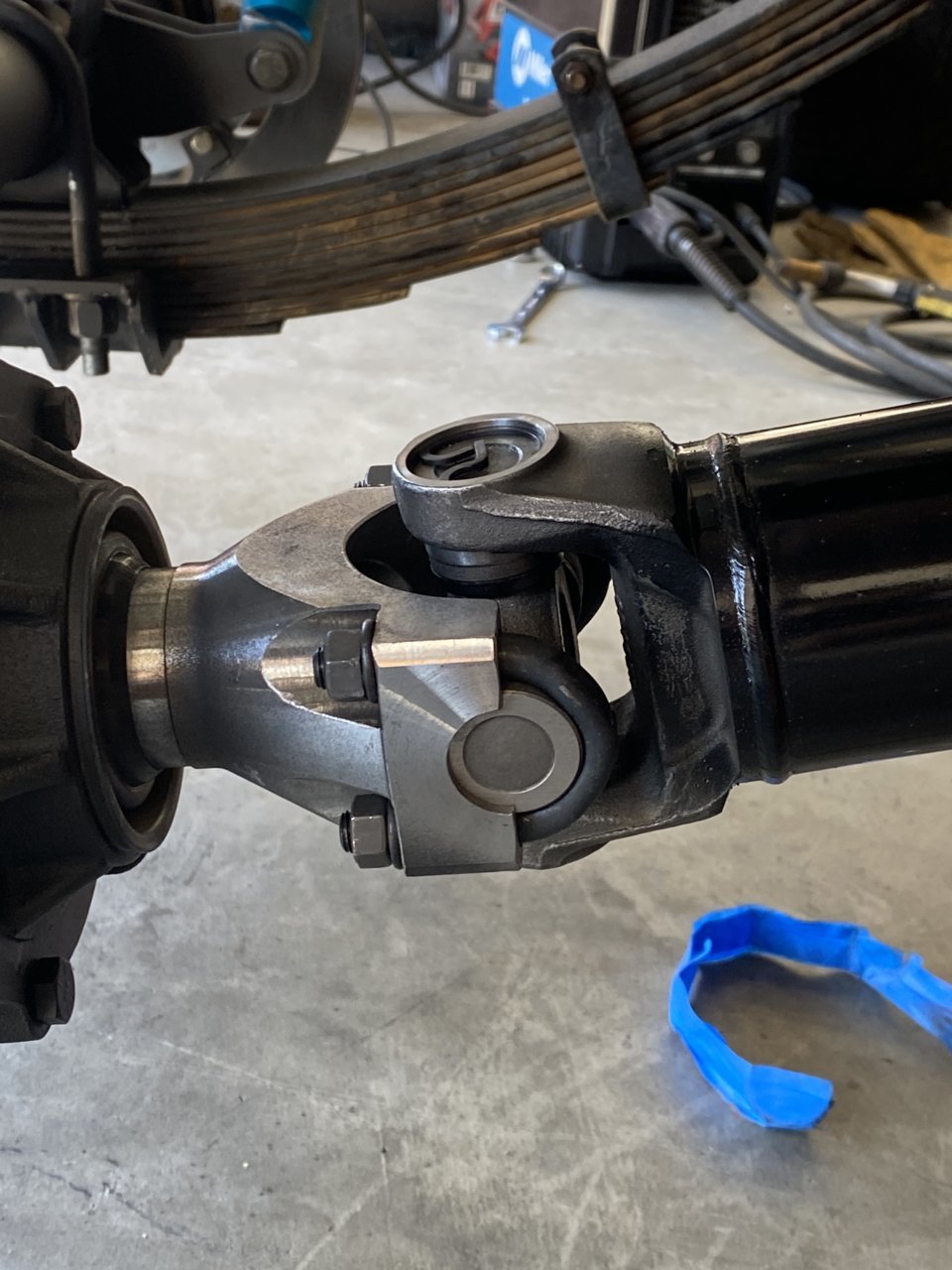

    Well it drives and stops much better than before! New master cylinder and discs are worth it! Time for the diff break in!!!!
  9. Jun 29, 2022 at 3:38 PM
    Airdog
    Airdog did your Mom
    Dec 26, 2012
    #93790
    4,899
    Tom
    SoCal
    https://www.tacomaworld.com/threads/airdogs-2012-prerunner-access-cab-slow-build.264263/
    First drive was a success. No leaks anywhere!! Mostly concerned with the brakes. The rear end is a proven solid rear end.
    That 1350 ujoint/yoke is beef!!

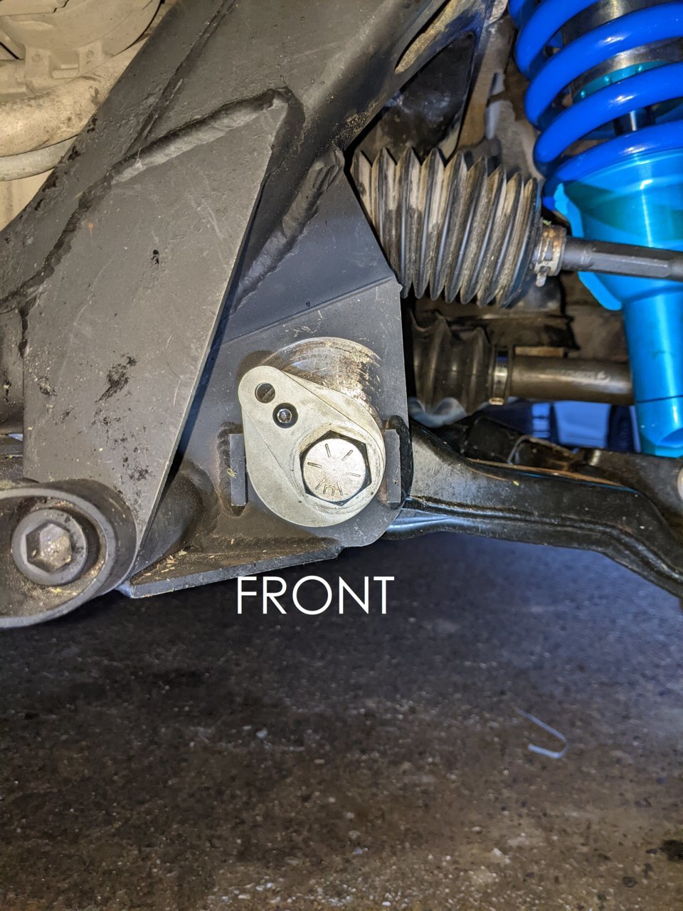

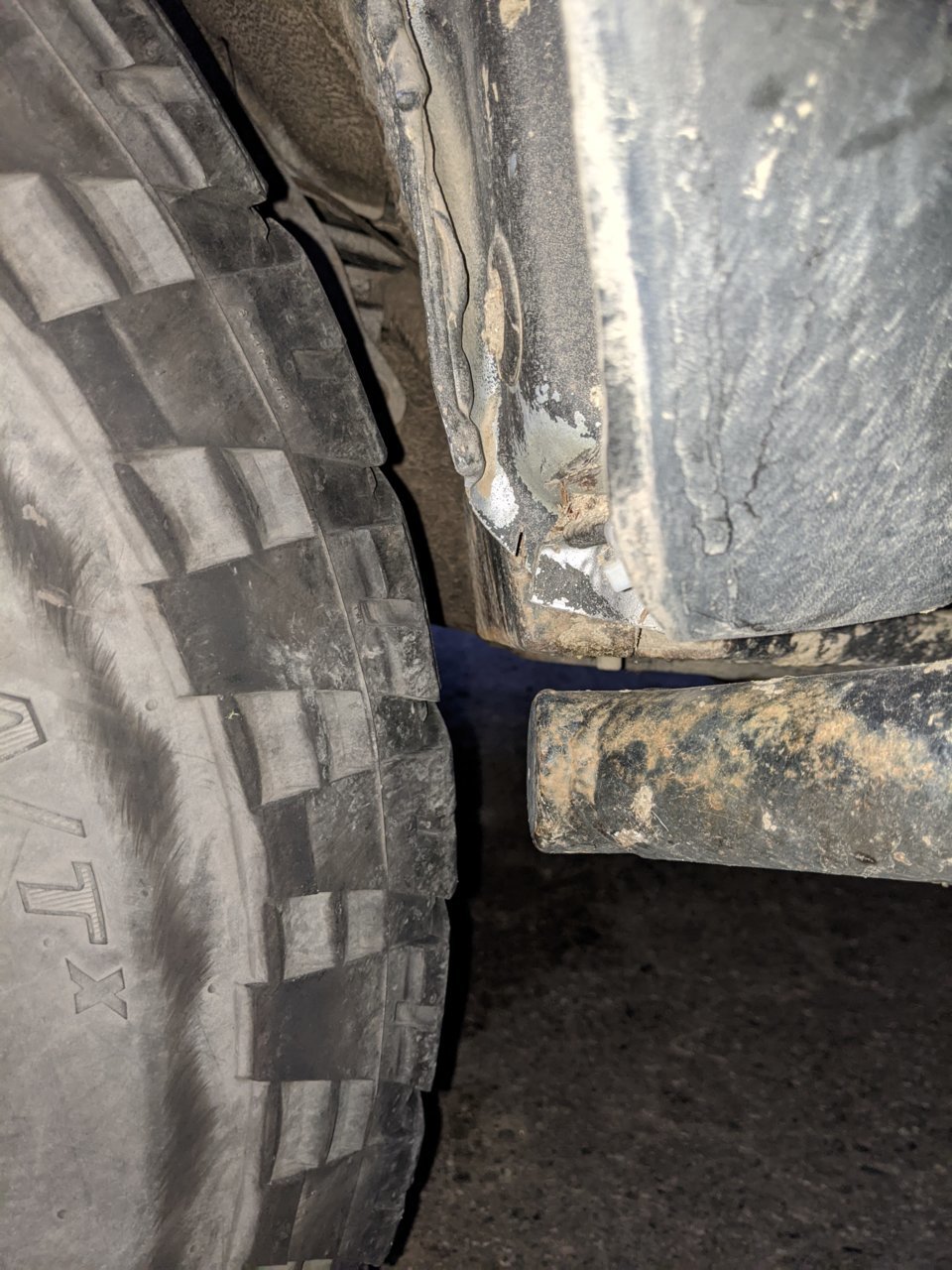

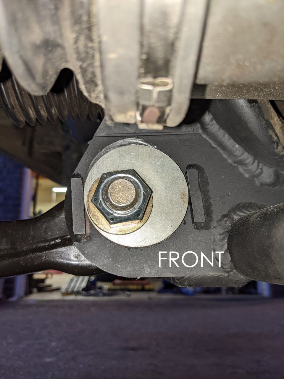

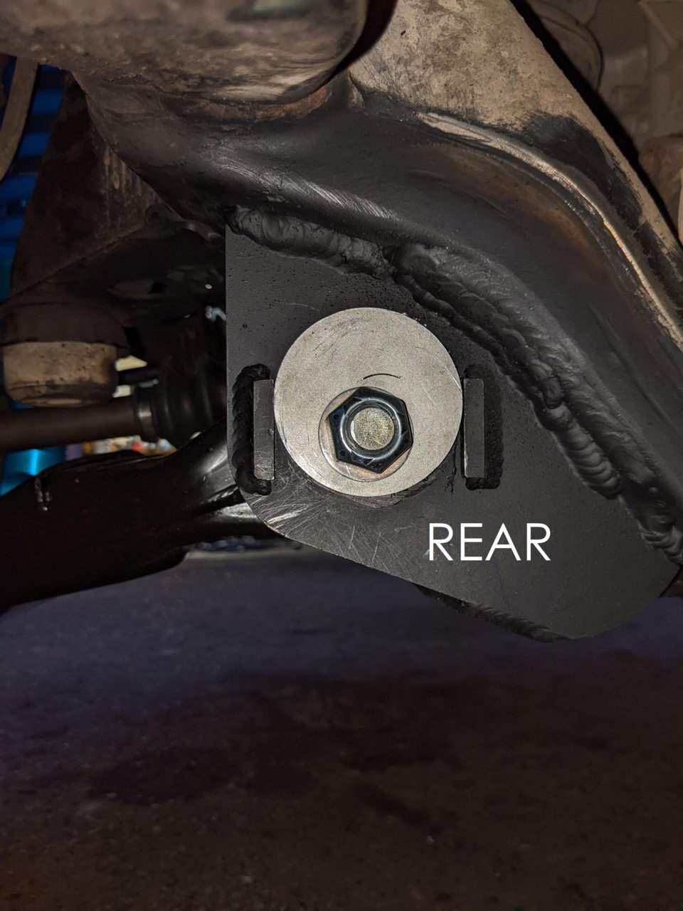

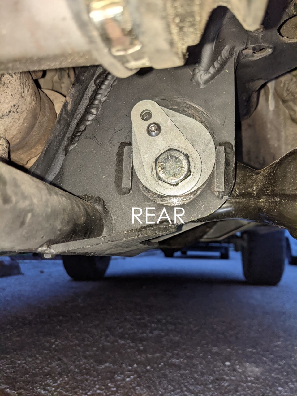

    I've installed my LCA pivots and completed a crappy at-home alignment until I can get to my alignment appointment on Monday. I also installed new coilovers, which I've left at 0 preload.
    I feel like I have exactly the same amount of clearance from my cab mount as I did before installing the kit when I had a 3-inch lift. When stuffed at full lock, I feel like my 35-inch tire is going to hit my cab mount, just like it did before. I had thought that the kit would fix this. So I'm unsure if my crappy at-home alignment is the problem, if I need to add some preload to help gain some clearance, or if I was wrong about gaining full clearance and fitting 35s. Super happy with the kit, just hoping to clear up the confusion I have.

    Your rear cam appears to be installed improperly. Should be installed like you have the front which has the bolt more outboard
    desjar8[QUOTED] and DocME like this.

    He welded the part that’s labeled no weld. So he has to run them backwards. No difference just can’t match drill them to lock the cams. Unless you have a 90° drill. I did the same thing but not a big deal to grind it out with a die grinder.

    What? Thats not what I'm talking about. The cams can be installed two ways, bolt inboard or bolt outboard. Proper is bolt outboard front and rear. He has outboard front inboard rear.
