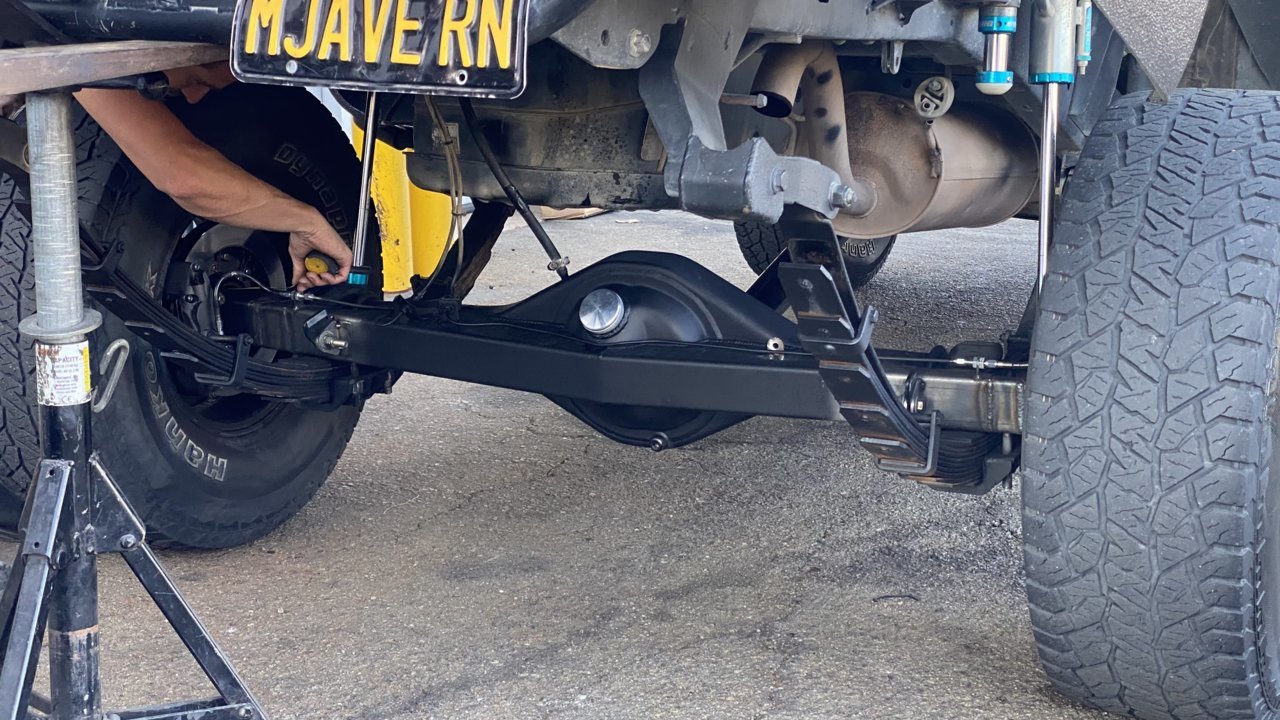

    Harry’s arm doing all the hard work today. 8756F358-28E6-424B-B2EE-24D786AC0409.jpg

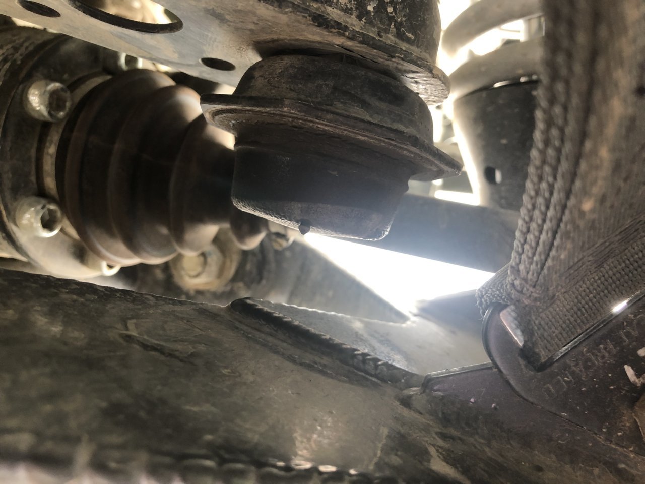

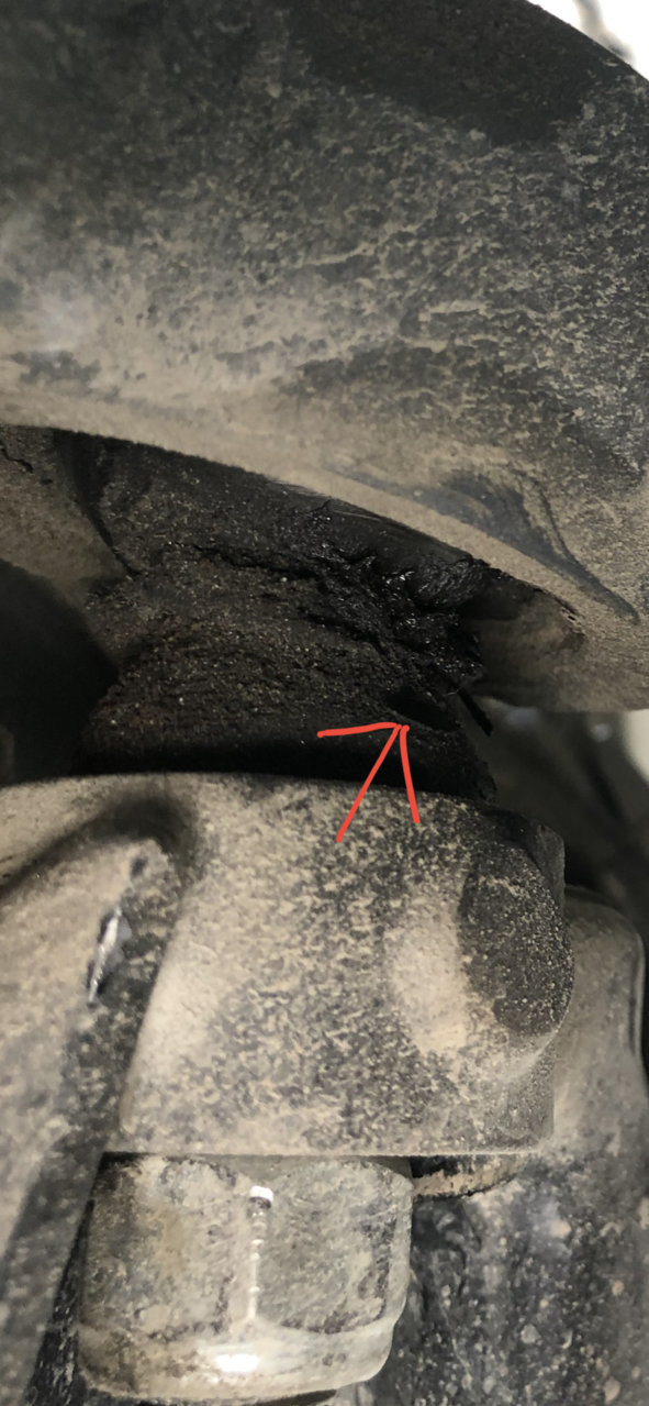

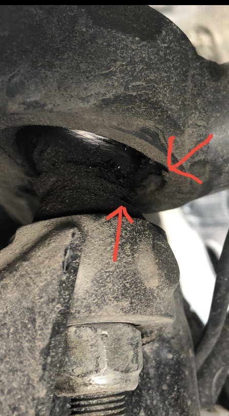

    Hi Guys
    Thanks for this great resource. I’m learning all the time and maybe this is common knowledge but I wasn’t sure and now I know
    I’ve got factory bumps in the front spaced down an extra 1/8’’ and the 2.25’’ LT kit
    Took my first spirited drive last night and upper ball joint cup came up solid on the ball joint enough to chip paint and dent metal a bit
    ADS bumps are in the garage and going on before the next hot lap
    Kit is amazing but get real bumps because once it's on you won't be able to keep it in your pants

    Interesting. I had the opposite experience but my truck is FOBAR’d so not a fair comparison

    I have real bumps and I took about an inch of uptravel out of it and there’s still enough frame flex to make stuff go metal on metal. Might not be so much the bumps but the amount of flex in the frame

    I have super bumps and ended up with small divots in the cups after my shakedown. Ended up spacing the bump down 1/2” and no more issues that I’ve noticed.

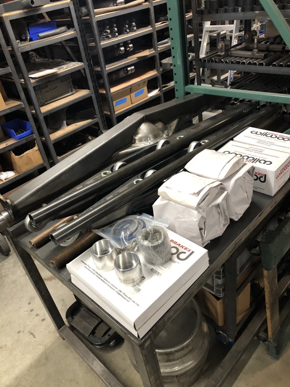

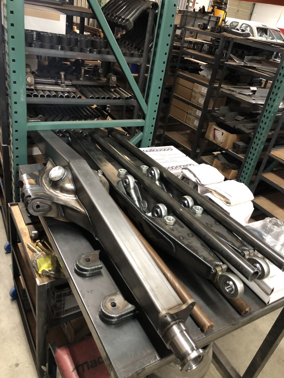

    Now I want to chop the frame off at the cab…. But I need the truck to pick this up!
