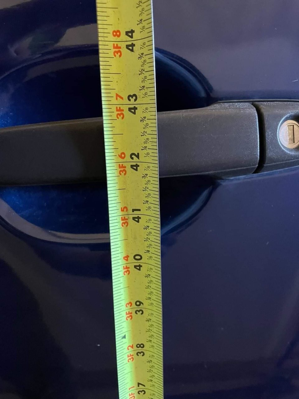

    Heres a stock door handle height.
    From that i estimated stock frame was about 15 inches, im 2.5inches taller than stock on 37s.
